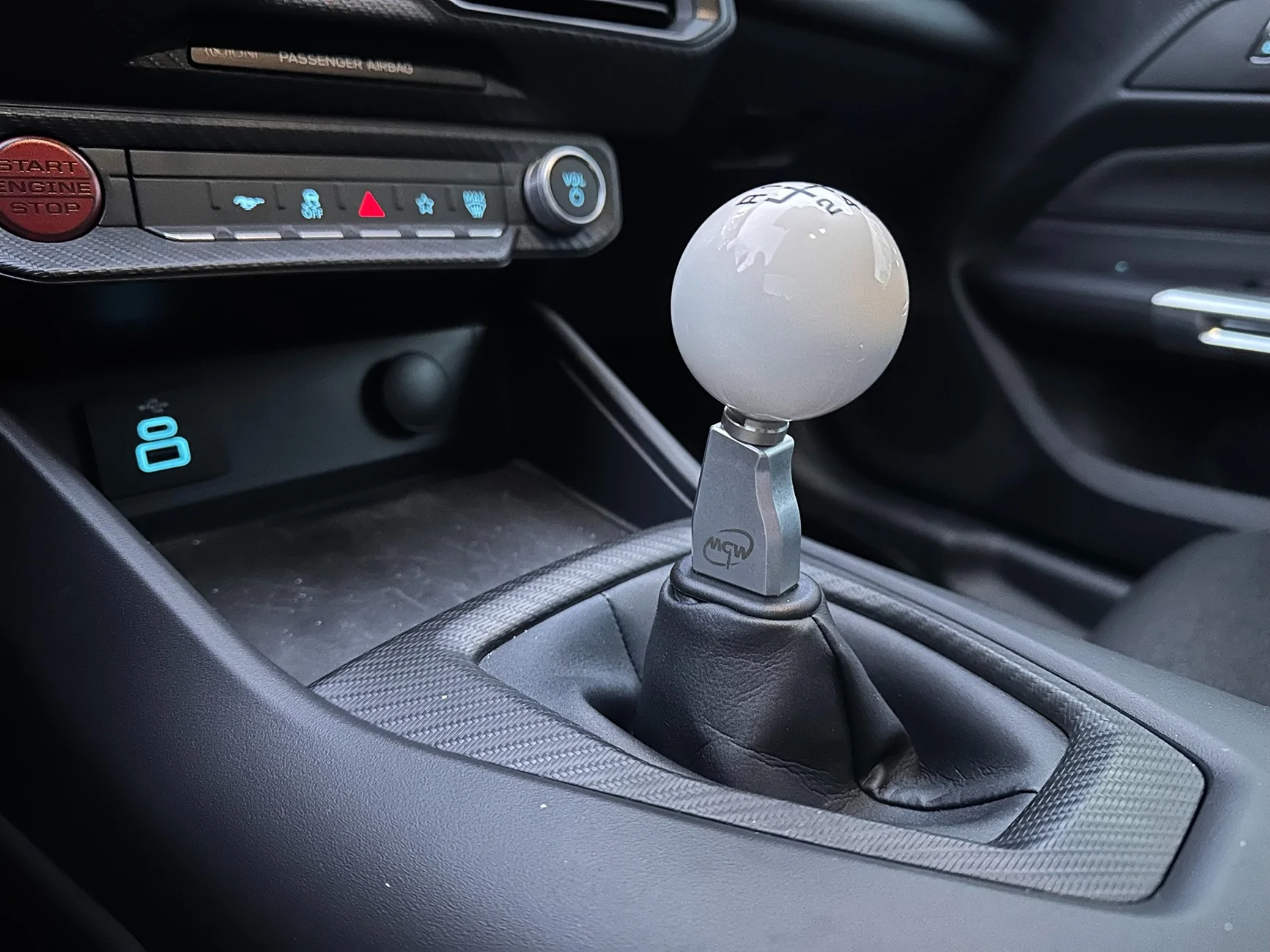

If you want a bit of function with the aesthetics :cool: ...MGW

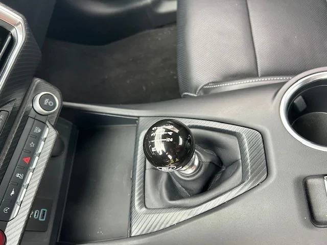

Just tried putting the Bullitt knob on, and like others have seen, it sits pretty high with a gap under.
Has anyone had any luck tapping it some to get it to sit lower?
I don't think it's bottomed out, more like it's got tapered threads and it's just tight. No way I can get another turn on it.
Thread size is 12x1.25.
MikeyV
Nov 5, 2015
444
192
Bay Area, CA
I'm happy to report back to say that a bottoming tap fixed me right up.
I had a gap as big as the OP photo, so I ordered a 12x1.25 BOTTOMING tap.
I ran the tap down as far as it would go by hand one time, backed it out and it brought a shaving of thread.
Put it back on the car and it went down to the stock height. Lowered it by about 3/16". And it tightened up in an aligned position.
I think if I went too far, or ran the tap in more than once it might go lower, but you could always use blue loctite to stop it where you want. But I don't think I could go one more full turn and still have the reverse lockout work.
Hope this helps - and thanks for the tips.

I just installed the Bullitt knob, although there is a small gap between the reverse lockout and knob itself, it works completely fine. The gap is only noticeable if you’re looking at it from the side, so Its a personal preference thing really.
How many revolutions (turns) did you have to do to seat it?
