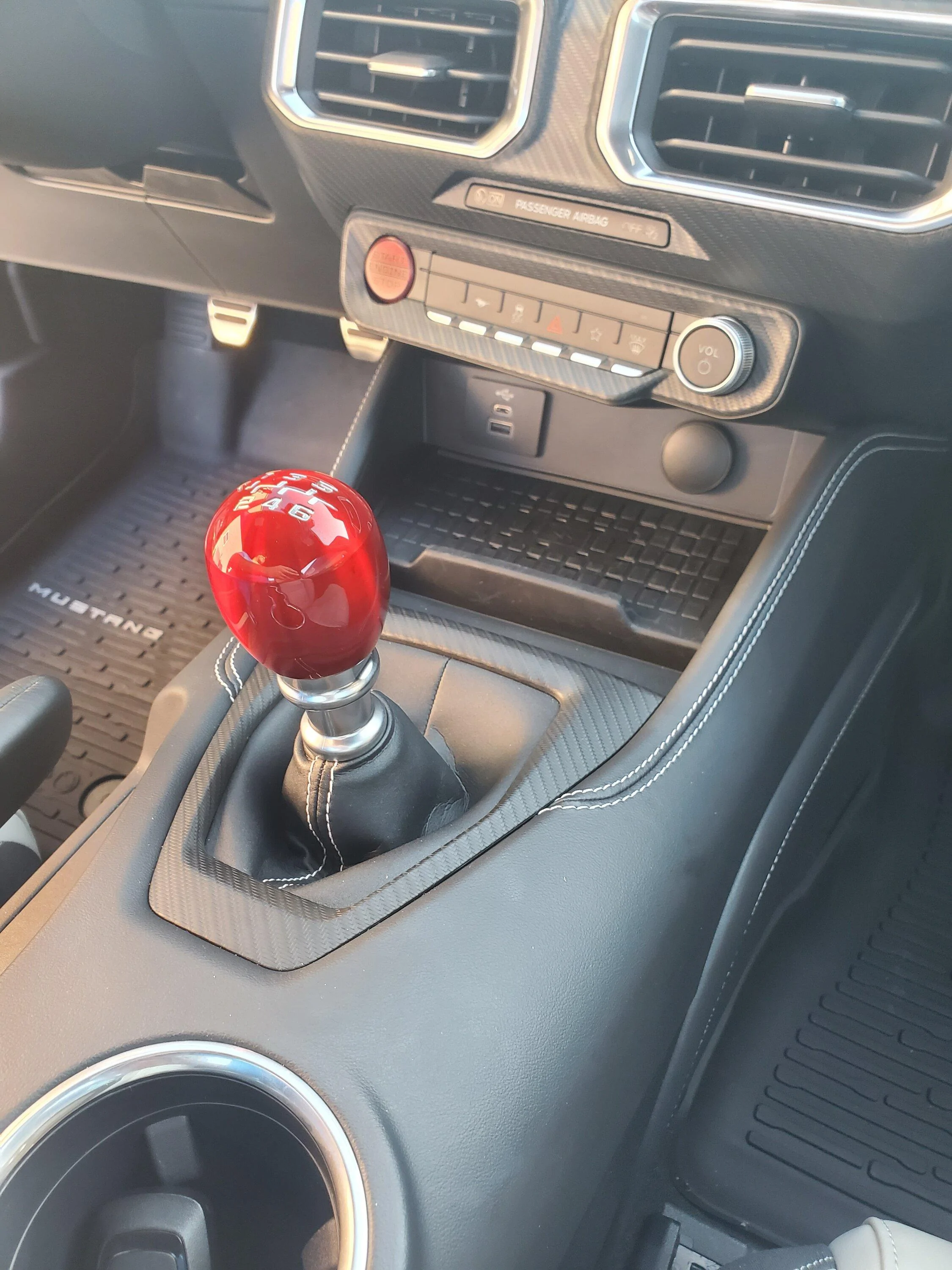

Just got this. Never heard of raceseng until joining this forum. It's HEAVY and very well built. Hopefully stands up to wear and tear... 1.4 lbs!

Driving to work in a few so I'll let you know when I get there lol
Very happy with the product build quality. Little taller than I thought compared to stock knob I'll snap a picture side by side but other than that I'm impressed.

I put it on without the top mount screw (the one used to align the gear numbers) I hand tightened all the way down, reverse lockout wouldn't work. I had to back the threads off quite a bit for the reverse lockout to work which made it significantly taller. I'll set it all properly tonight (minus locktight) so I can get better idea of how tall this is going to be. Contacted raceseng to see if this is normal or if they just haven't seen the 2024 yet and then may need to alter the design a tad to accommodate it. I did like the way the Weight felt though, noticeable change

Great! That helps me a lot. I think I will wait until they make the tweaks for the shift knob to fit a 2024.

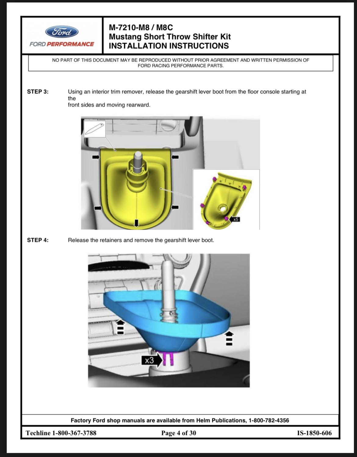

Iā€™ve got a billetworkz Iā€™m going to install soon. I also have their reverse lockout replacement so that the knob doesnā€™t sit too high properly installed. Iā€™m hoping the install is the same as s550 shown below. Has anyone removed the shifter boot in their 2024 to change the reverse lockout yet? It looks like itā€™d be easy to break the clips on removalā€¦
