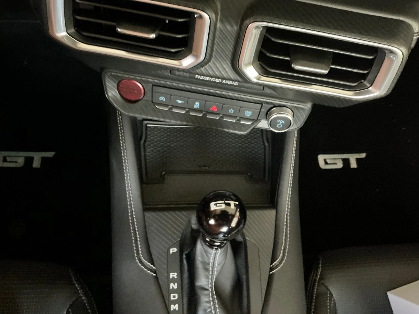

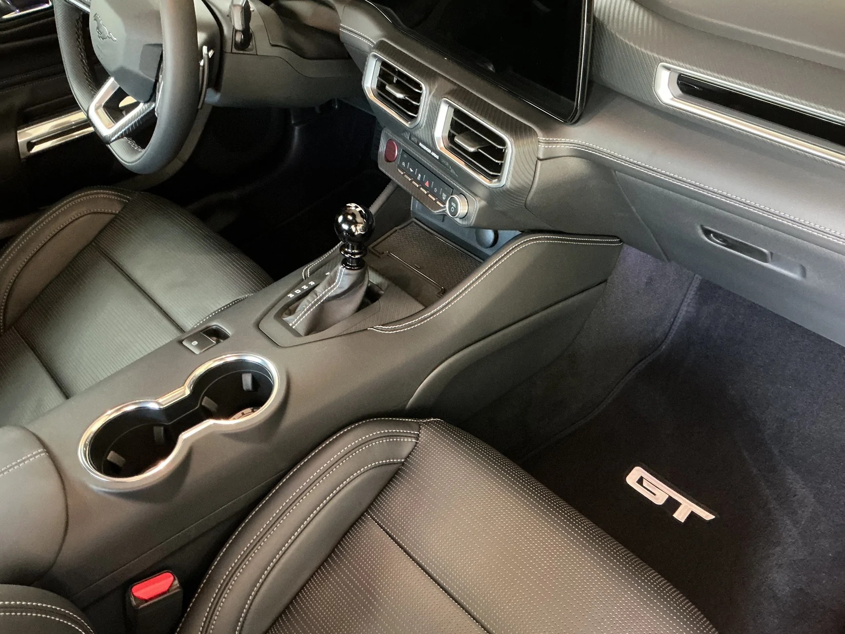

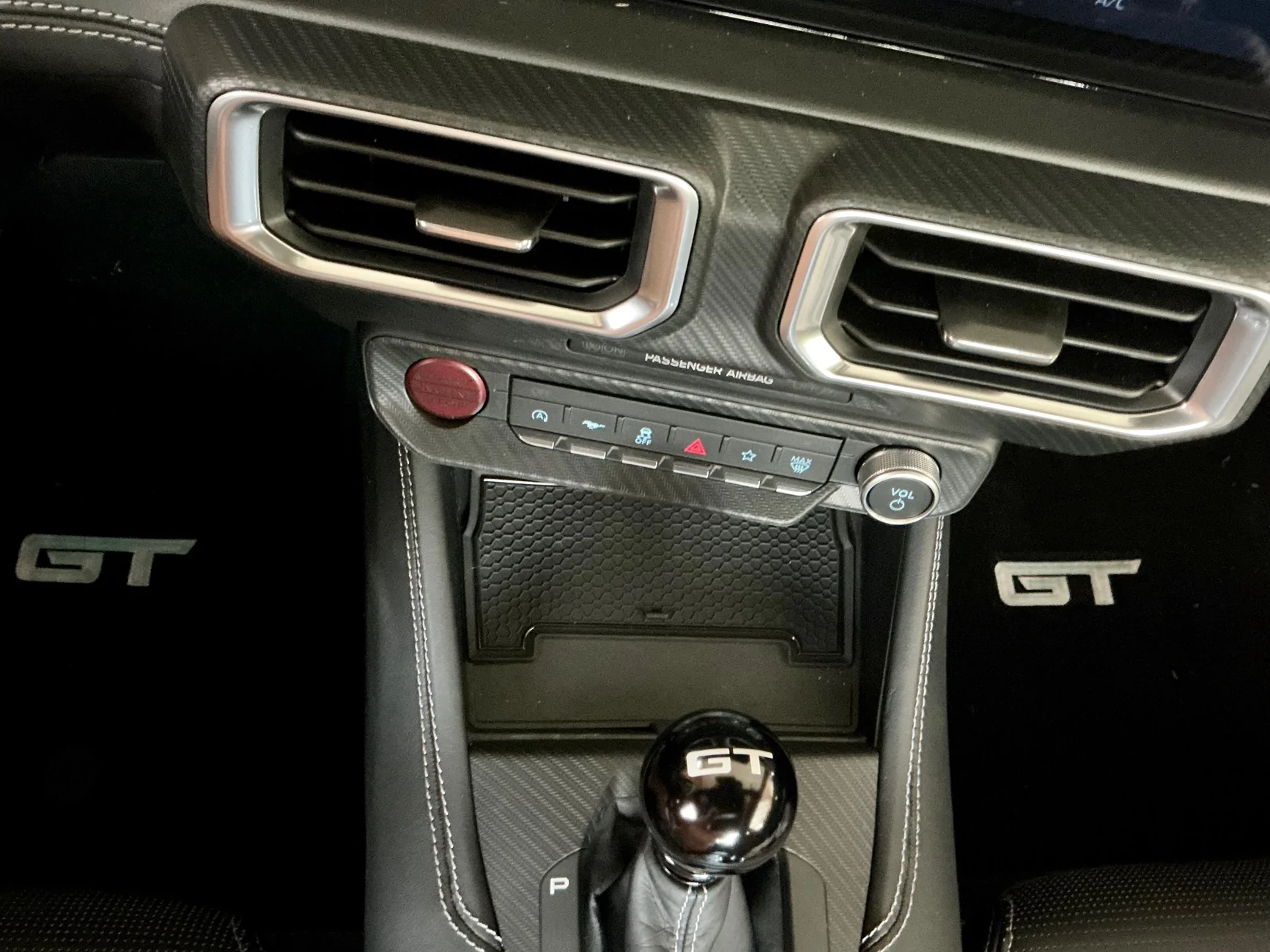

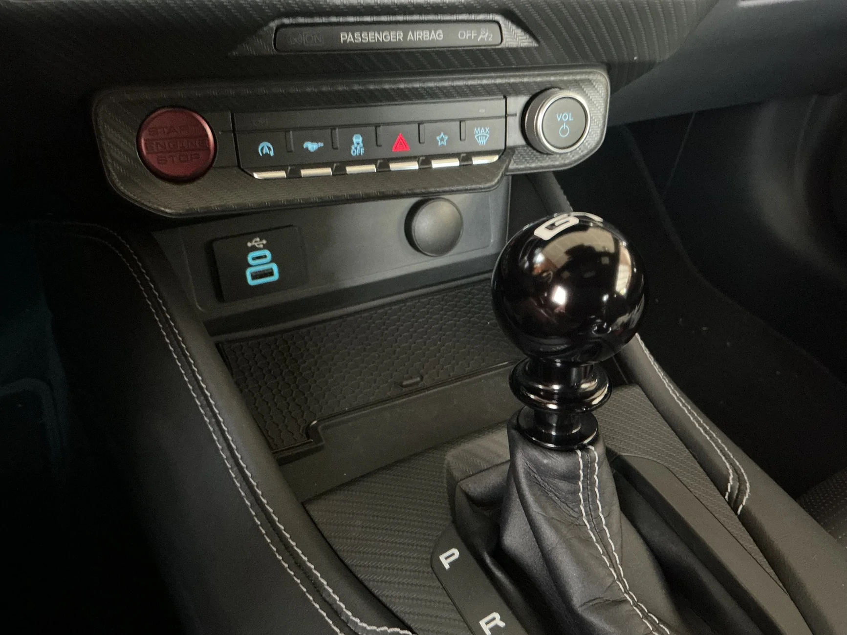

Well, I installed it. super easy!! Just have a quality trim removal piece for the two shifter gate covers...they both just pry up with clips. Without the car running, put it in Drive so you can get a screwdriver into the front of the stalk and remove the two Phillips screws, Pull up the stock shifter, and flip upside down to take off the collar that holds the leather boot on. it just pries off and the boot is glued to it. Set new shifter stalk in, ziptie the boot around it with included zip tie, flip over and secure to the stalk with the 4 set screws. Make sure the new lock-out collar is ever so lightly resting on top the lock out lever!!! use a gentle feel. Then just snap the two covers back down.
The Billetworkz video is the best. I’ve seen 12 minute long videos of removal/installation, that were made by idiots….don’t follow those, they show removal of things that don’t have to be removed.
OK, on to my review…. Friggin LOVE IT! Pushing down on the lock-out collar is very intuitive, and I got used to it instantly! I can now grab the top of the knob without accidentally pushing down the lever as in the OEM knob. IMO the lock-out mechanism is much more user friendly just for taking the lever away from the top of the knob And putting it underneath.
I also have a brushed silver knob to switch out for giggles…
I highly recommend!👍

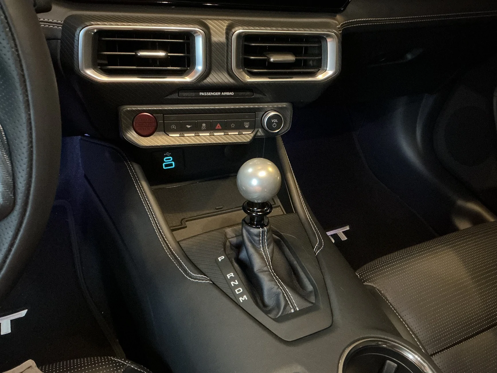

Duly noted! The silver knob has a nice contrast though. The black knob kind of gets lost.
No matter…I can swap them out in 3 seconds. They just unscrew from the top. The important part was lining up the GT logo, so I needed to install that one first.

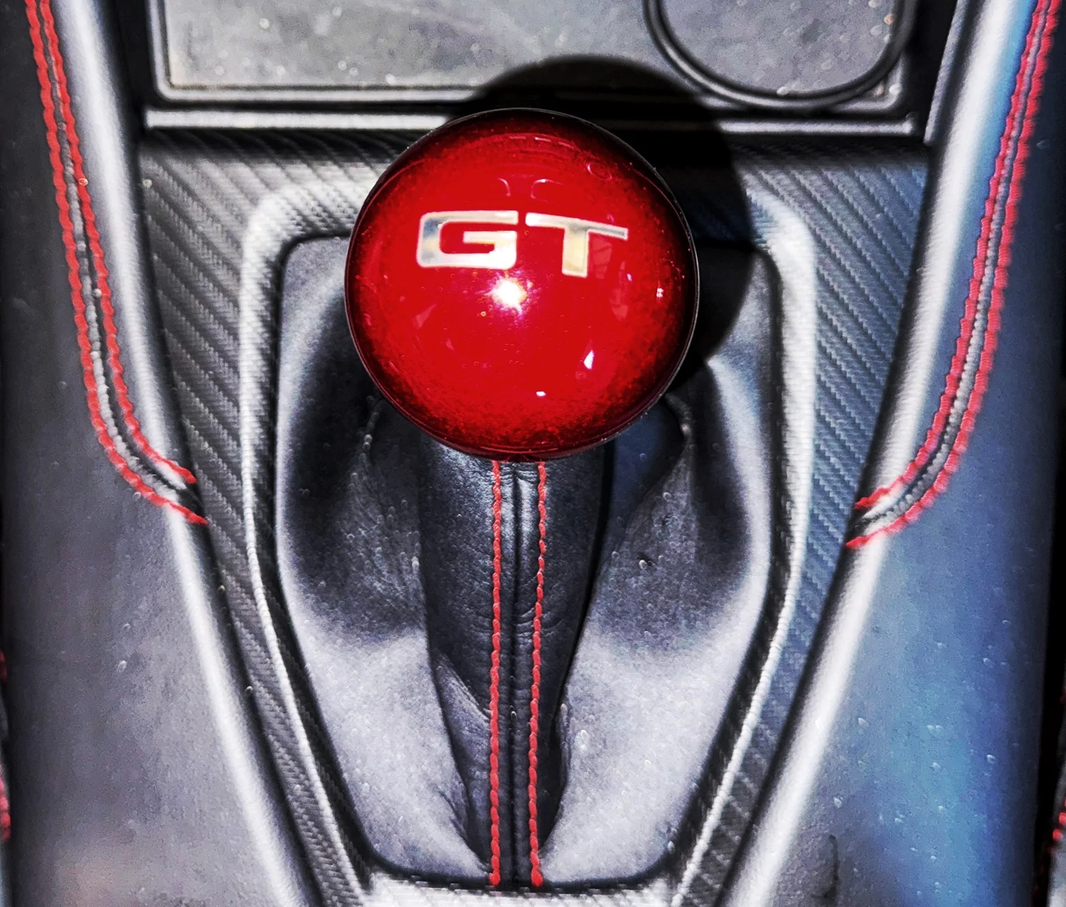

DT-GT
Apr 28, 2023
570
1,016

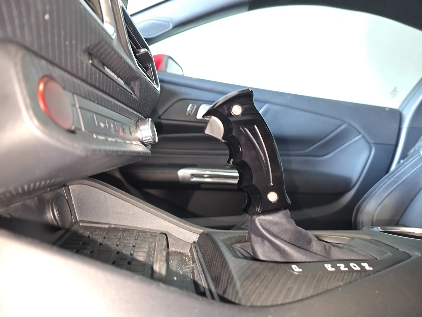

My Billetworkz knob in my automatic GT. Like it very much!
Starship Enterprise
Jun 15, 2025
1,189
1,753
MD
2025 Mustang GT Premium
Looks good! I just ordered 2 more knobs during their sale. On their main page, non-custom selection of knobs are on sale for $89 plus the 10% off. I got a cosmic blue and also a gloss black with silver splash. So I have a total of 5 knobs…yikes! I ordered a case to put them all in so I can put it behind my seat for quick swaps.
BTW: If ordering extra knobs and you don’t need the adapter, they told me to order from the 2015+ manual shifter page.
