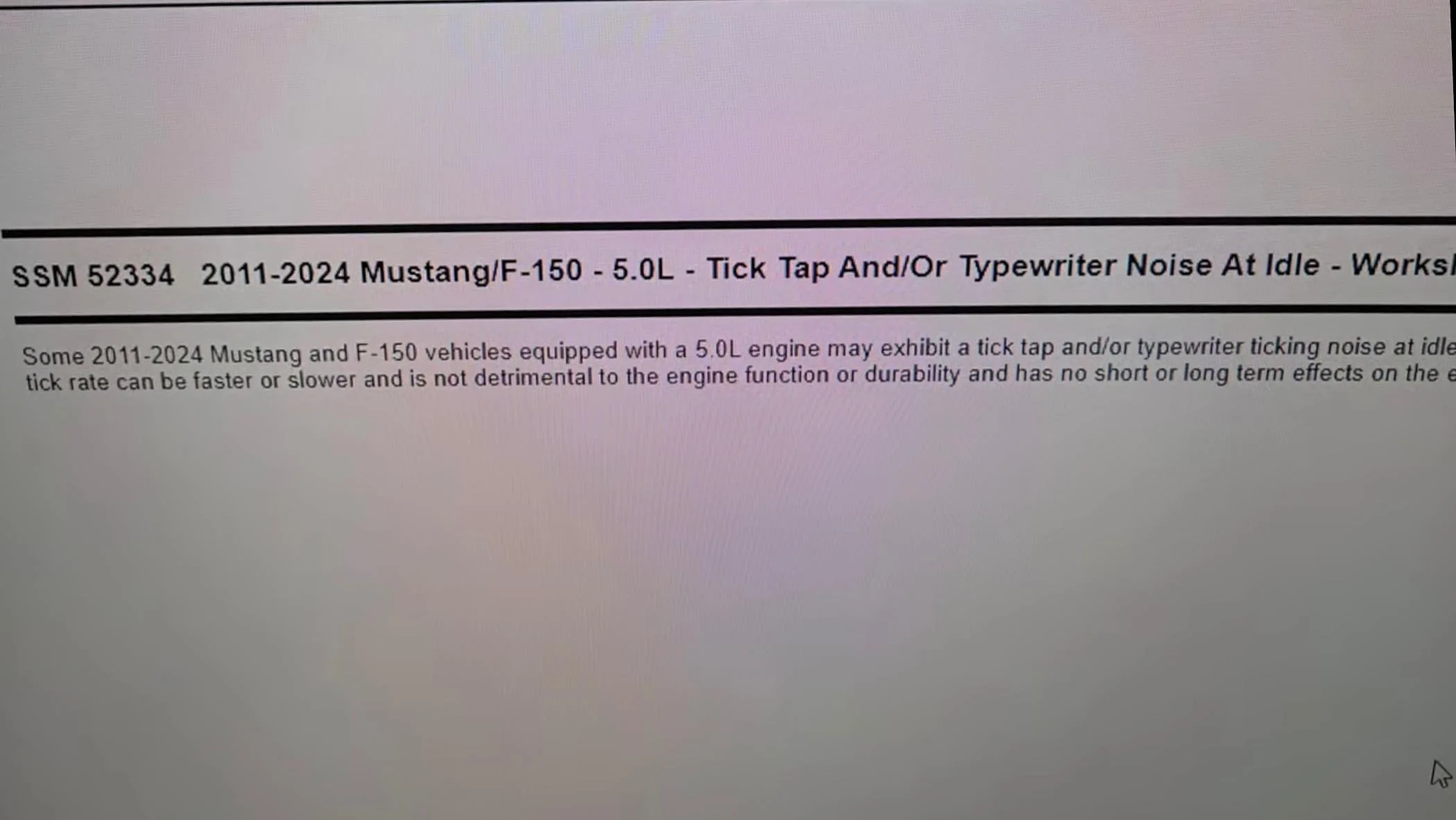

I understand Ford has communicated that it causes no harm.

I think it's good to have a general awareness of almost anything. But specific to this topic, I wouldn't follow the rabbit down the hole too far. Tomes have been written about the BBQ tick, none with a definitive explanation of the root cause, what to avoid or what to do.
From my readings, it is random. Oil changes seem to have something of an effect, but from there, no one knows. First oil change. Third. Making the sound from new. Making it at X miles/kms. Brand X oil. Brand Y. It's like random, white noise.
I don't think it's any more common to hear the tick or not. Notice I use the word "hear". All Coyote engines tick. Some tick at a louder level than others and those are the ones being noticed by perceptive Owners. People who've never heard of this topic probably have it and never noticed.
I do not have proof, but I do believe the factory fill contains an additive, such as XL-17. I think it's a way of Ford gaining confidence that, no matter how the Owner drives, except in unique or extreme circumstances, the mechanicals will wear correctly.
One thousand miles, 1600 kms, is when some do a first oil change; this is driven by statements in previous Model Year Owner Manuals, referencing a 1000 mi break-in period. But that statement doesn't exist in the 2024 manual. And way many more Owners follow the manual and Oil Life Monitor. The 2024 Owner's Manual and the Oil Life Monitor are the benchmarks.
I did my first change at 1265 miles / 2035 kms.
I'm using Pennzoil Ultra Platinum, 5W30.
If keeping the car long-term, I do think it's best to use a synthetic oil. I don't think there's any one brand of oil people use more than another. Many do use a "full synthetic", even the definition of which is debatable.
At the moment, two oil changes in, I don't hear the tick. Actually, I've never attempted to get down and study it. But if I did, I wouldn't do anything about it. I've never read a post or thread where anyone has confirmed a correlation between the tick, damage or long-term engine viability.
Ceratec is well-received. A lot of people with the tick use it. Some even without the tick use it. I hesitate to use any additives in the engine oil, principally because Ford doesn't call for one. As you mentioned, Ford officially says the tick is normal, so, what is it I'd be fixing?
The BBQ tick is one sound that has been identified. The injectors on the top of the engine, they make even more noise. Another sound which is also debated is the 2K rattle, which I do have, when the engine is cold. Some believe the 2K rattle comes from the fuel pumps. Others believe it is the cold pistons, slapping the cylinder walls.
FWIW, every measurement I've taken, including oil analysis and any sounds I have noticed, have yielded nothing of concern; they are sounds common to the Coyote and many other Ford products.
