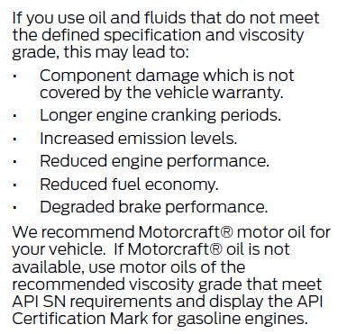

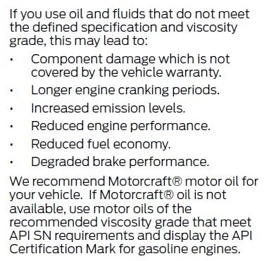

That may be. But
S650 Mustang 2024 Mustang TypeWriter Tick Question 1698161716426
I, and many others here, would rather not risk that for a tick. I also know many, many people have used it with no issue, and to your point, have had warranty work approved while using it.
