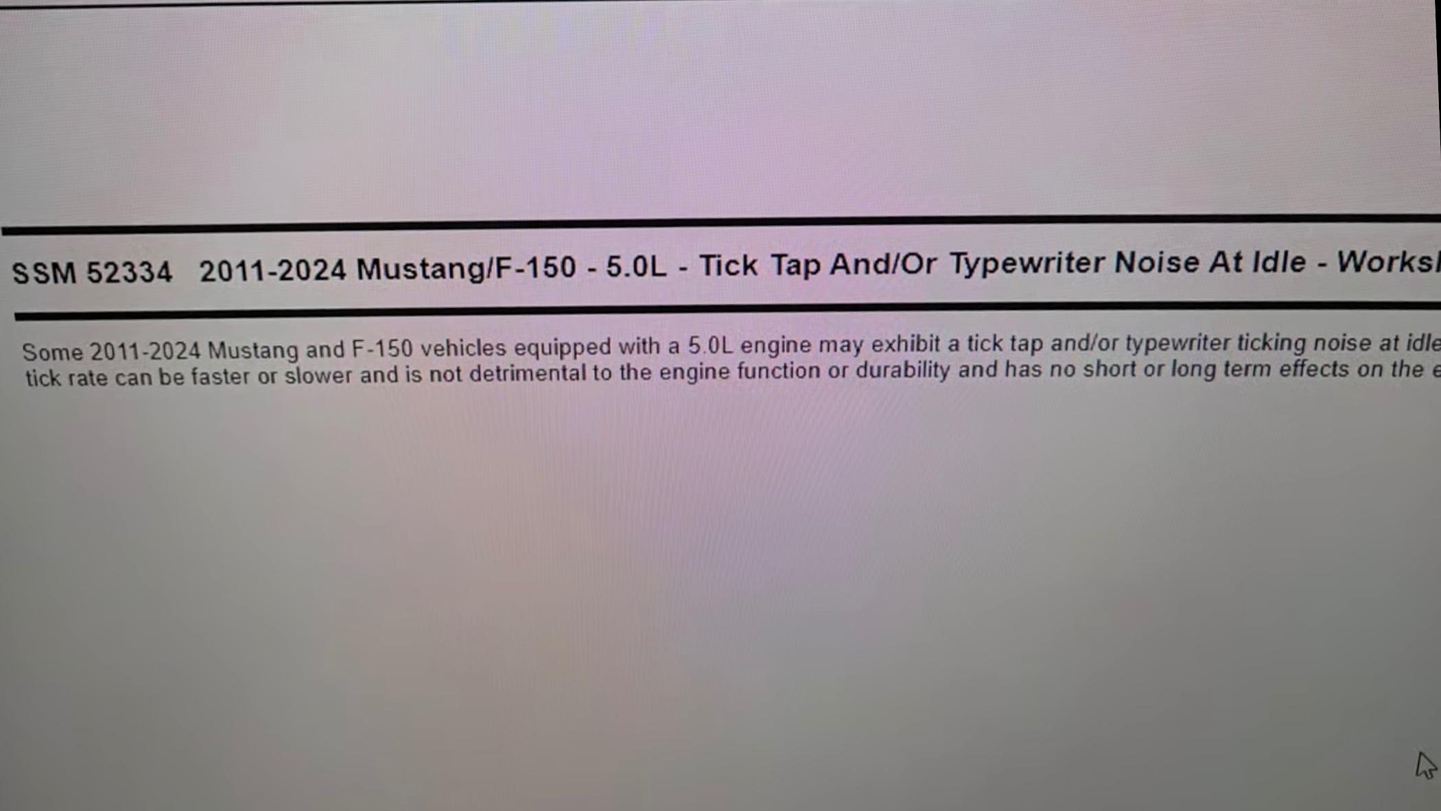

TSB updated to add the typewriter tick on the 2024 models
thelostone
Oct 12, 2023
93
106
Gusev Crater ,Mars
2024 Mustang
Now it’s updated ..bringing it into the dealership won’t help ..they will do nothing
S650 Mustang TSB updated to add the typewriter tick on the 2024 models IMG_1206
