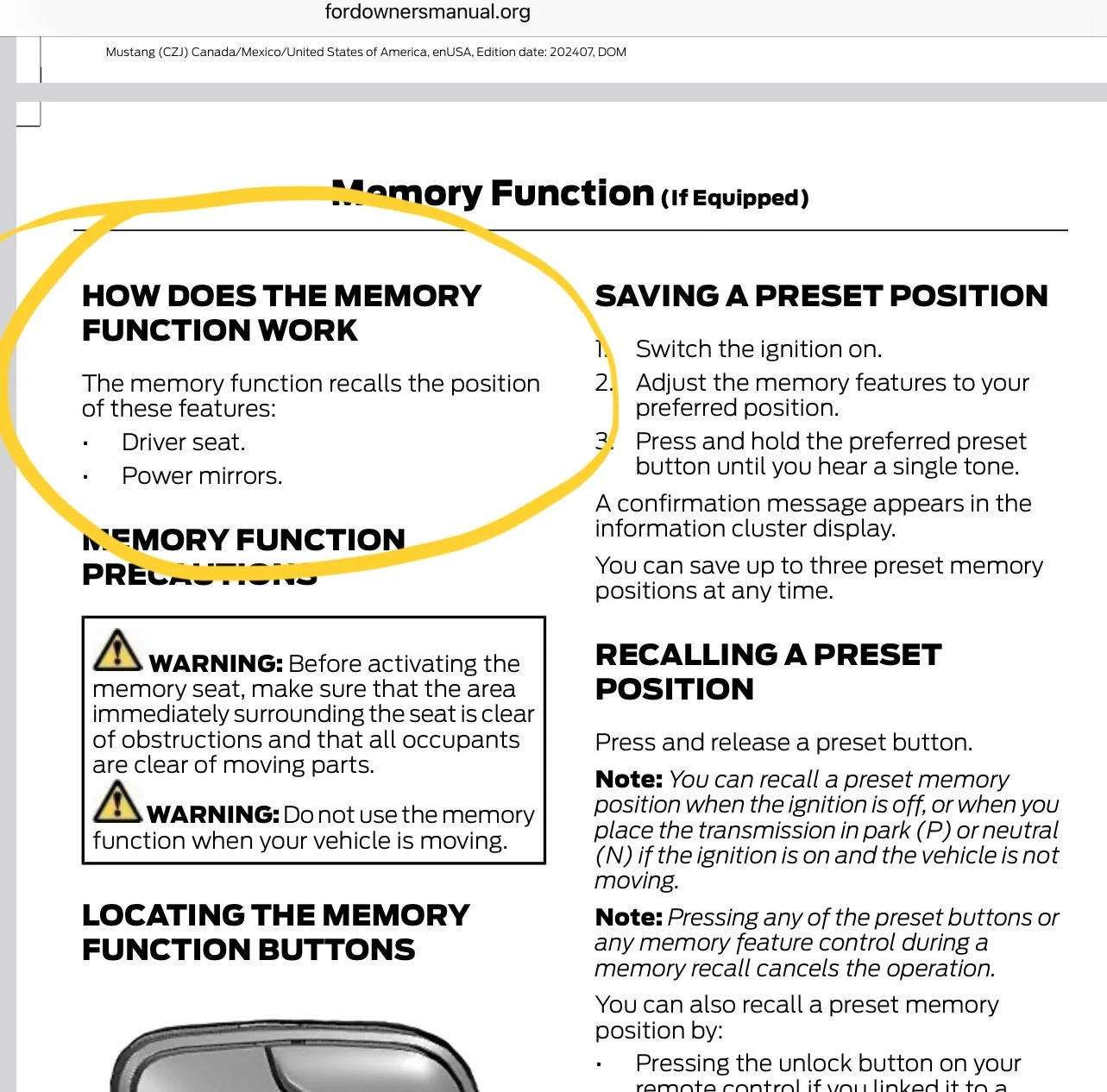

According to the manual, it only saves seat and mirror position.
S650 Mustang Saving driving modes IMG_7389
There was a whole thread about this. That is yet another example of the manual being woefully inadequate.

He's talking about the drive mode on the wheel. We're talking about the seat button on the door. You can absolutely program colors and save them to the door profiles. It is supposed to save the cluster too, but there is a glitch that sometimes doesn't allow it to save. It's worked intermittently for me.
OK…interesting! I’ll take real driver experiences over the manual sometimes. The manual also cut and pastes from previous models, or posts features that either no longer exist or features that have been expanded on.
