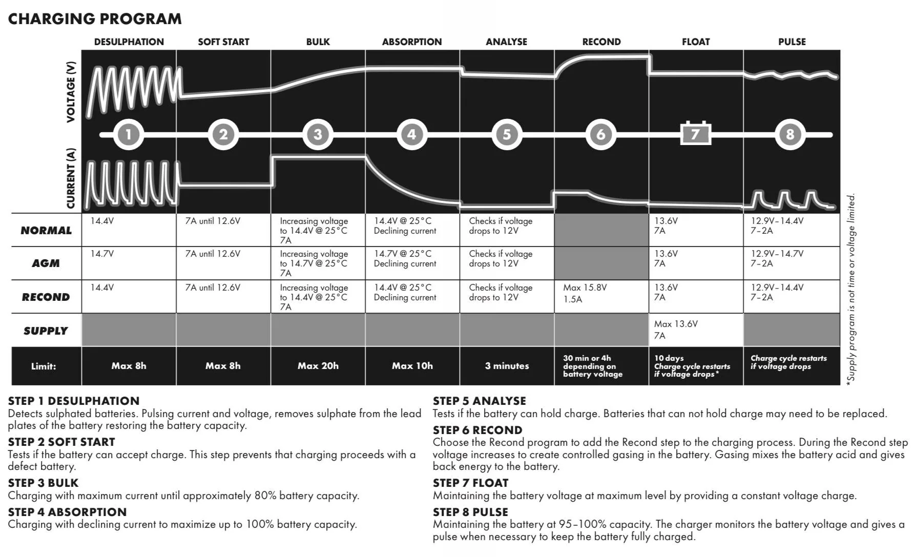

Daydream
Oct 16, 2023
2024 Mustang GT premium,
I received my car in August of 2023. I put it in winter storage in Nov. i had it on a CTEX MX 5.0. It did just fine. I have put it in storage again using the same system, so fingers crossed it works again.
