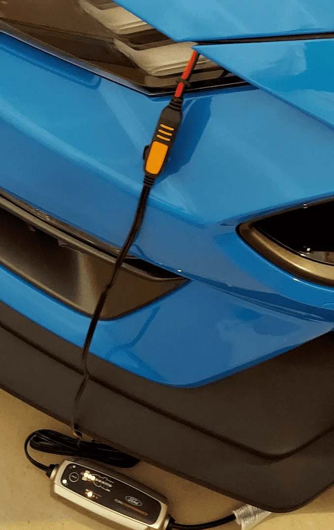

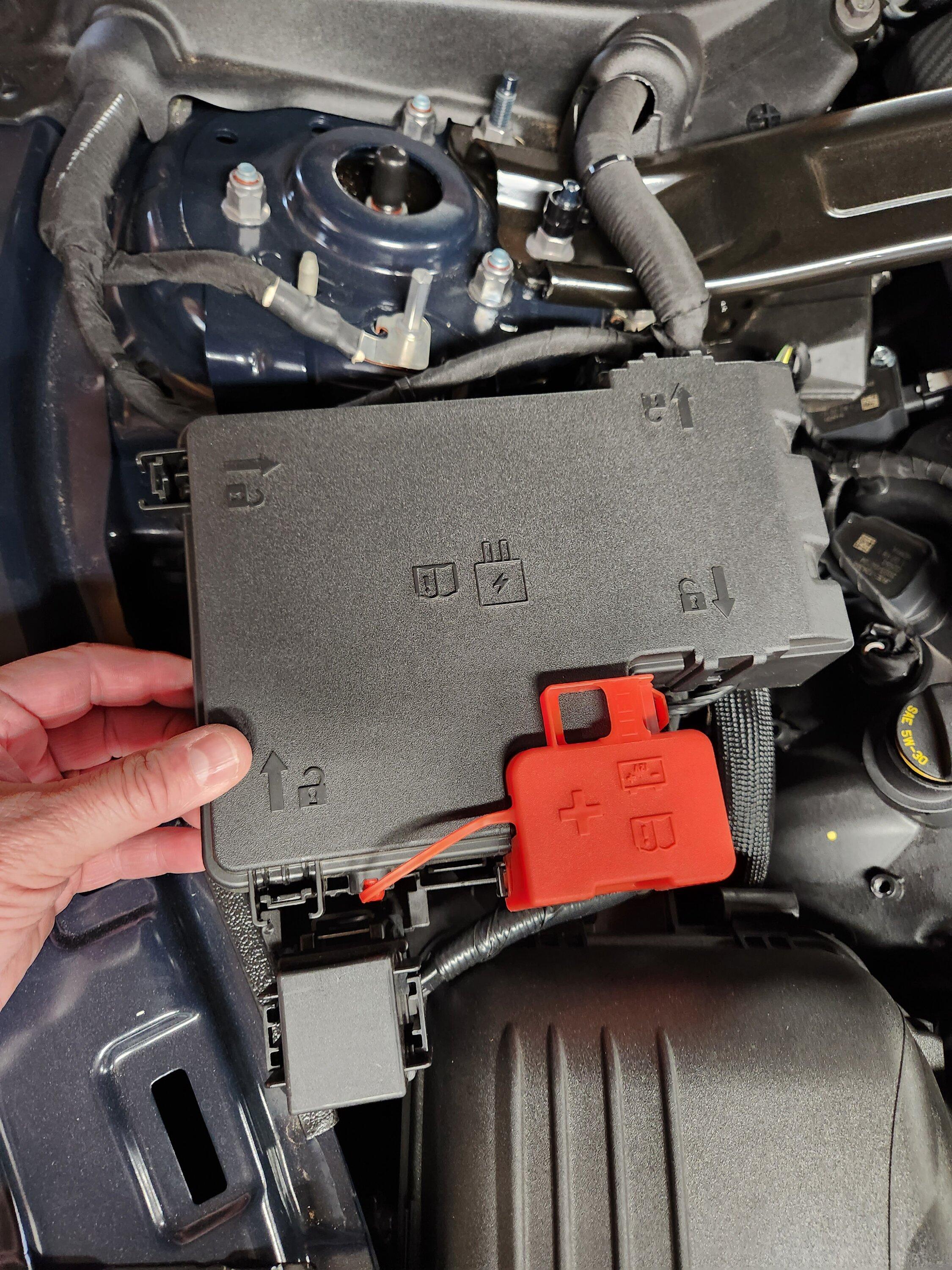

I have this one installed. CTEK is very popular. The Ford unit looks exactly like CTEK's and I believe is made by them. Works well. No hassles.
The unit has a connectorised plug with two pig tails. One has traditional clips to attach to the battery. I'm using the connector with the eyelets; it's hard-wired in.
Another popular brand is "Battery Tender", the green units.

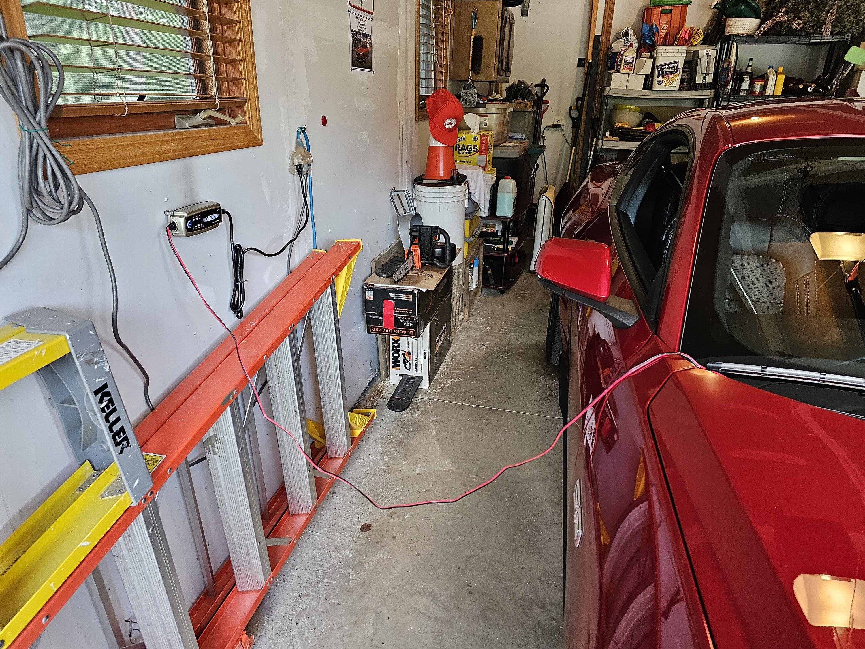

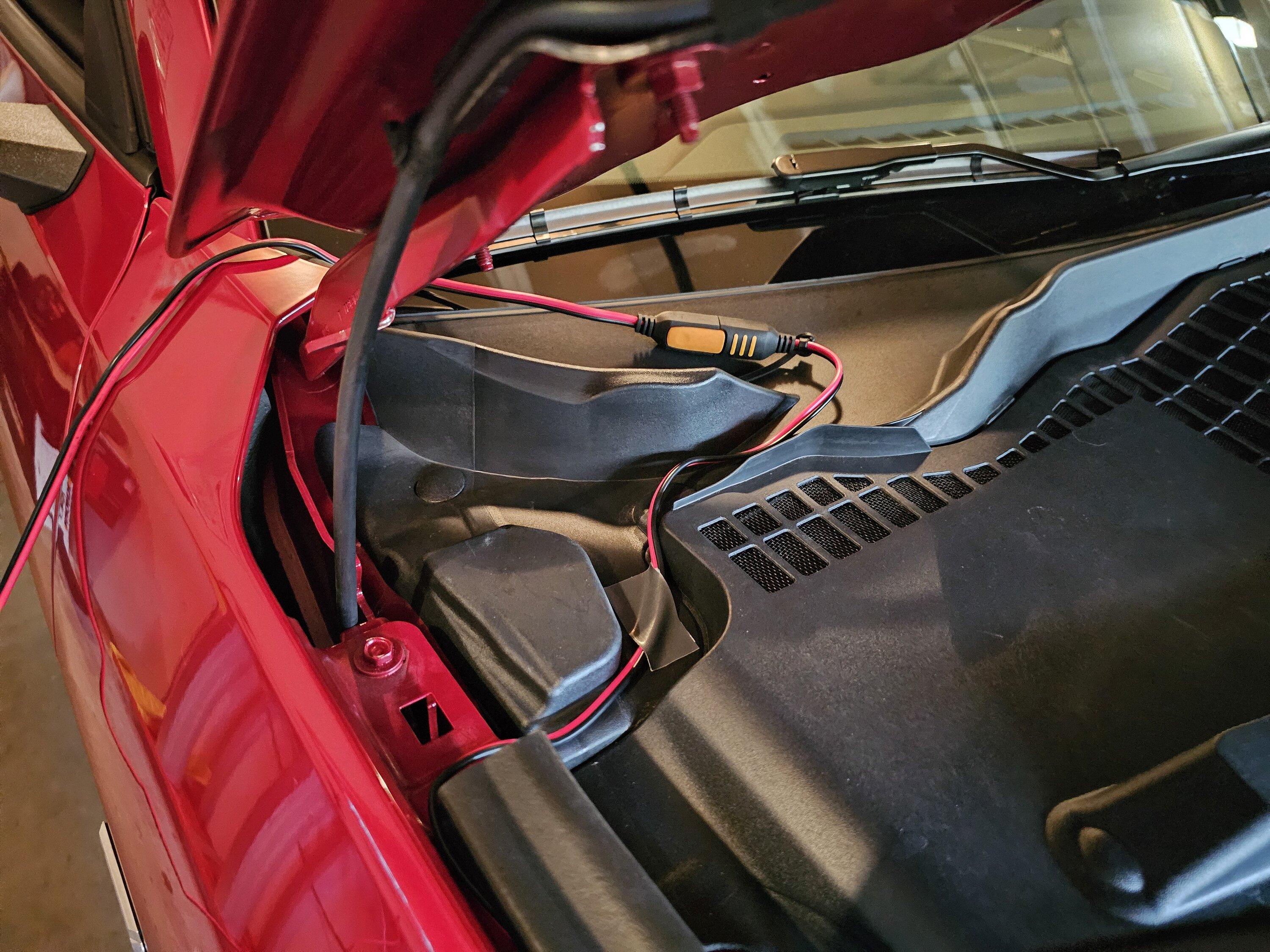

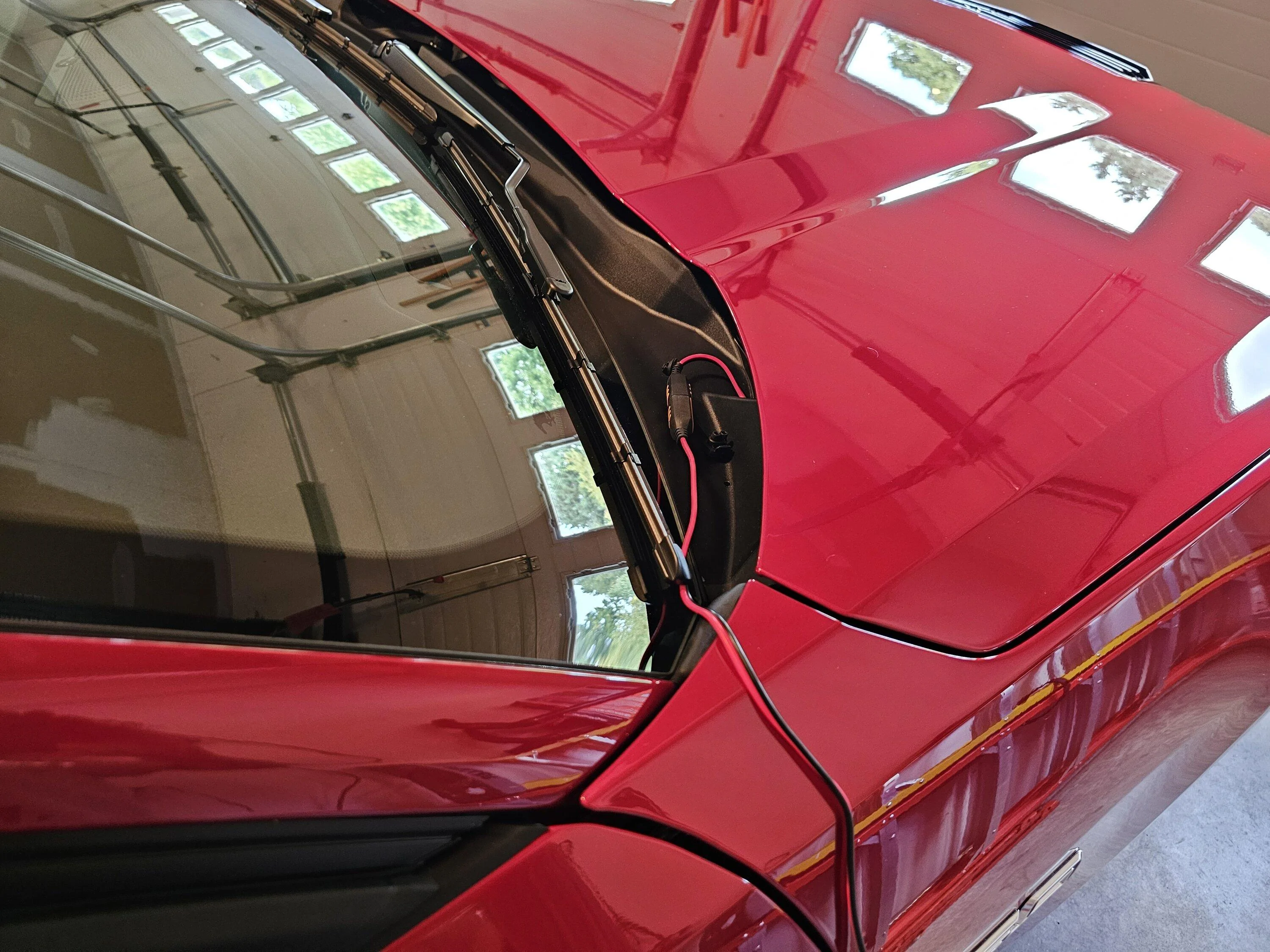

My 2024 GT coupe arrived last Saturday September 2nd. Ordered it in April. It replaces a 2007 C6 Corvette which I had on a ctek tender. I bought a new ctek not knowing Ford sold one. I connected directly to the battery with the ring terminals but the supplied pigtail is too short to fit up thru the back of the hood. So I bought a ctek extension cord on Amazon and then tie wrapped everything inside the engine compartment. Now I can connect to the ctek without having to open the hood. The connector that pokes out the back of the hood has a plug to keep out the weather. When driving I also tuck that connector inside the hood just far enough so that it doesn't blow around.

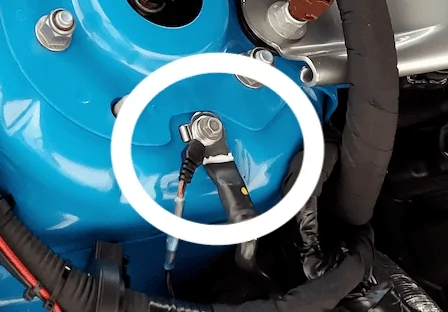

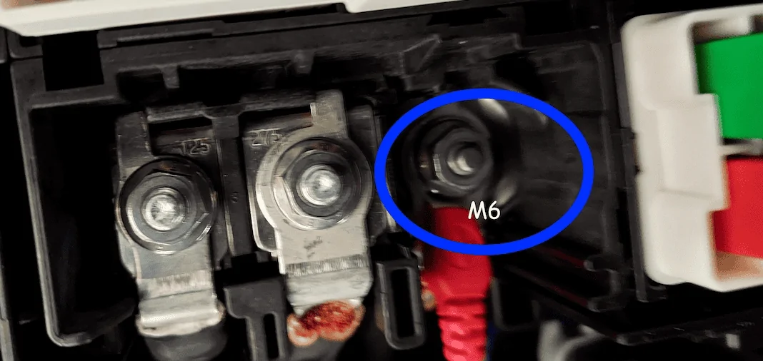

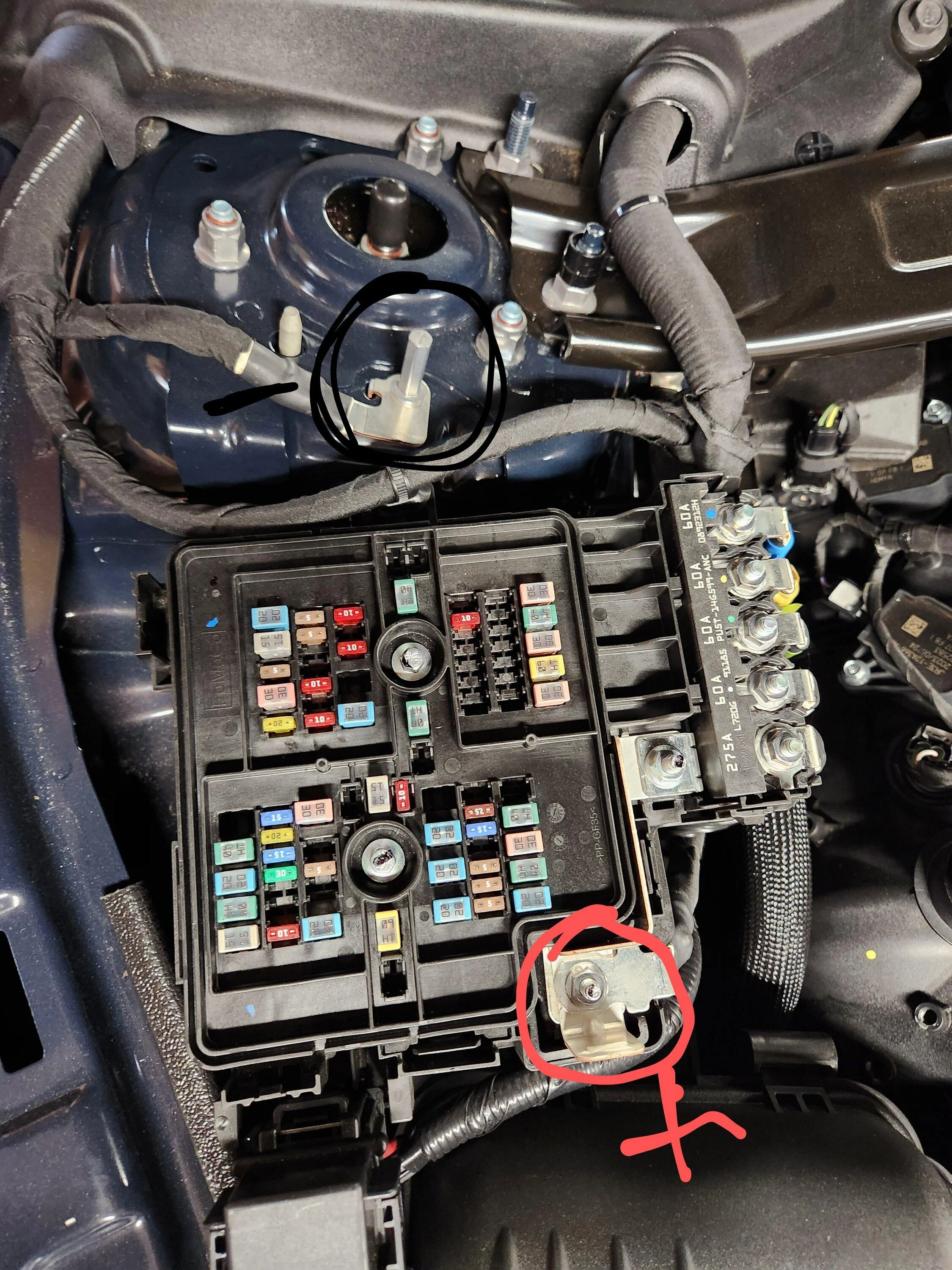

I want to hook up the quick disconnect for the trickle charger like shown on this S550.
The S650 looks really different. I'm 99% sure I hook it up to these points. Just need a little help verifying this. I don't want to F anything up.
For an S650, that would appear to be correct.
Edit: I also noticed from the S650 Owner's Manual, those are the two tie points to jump start the car.

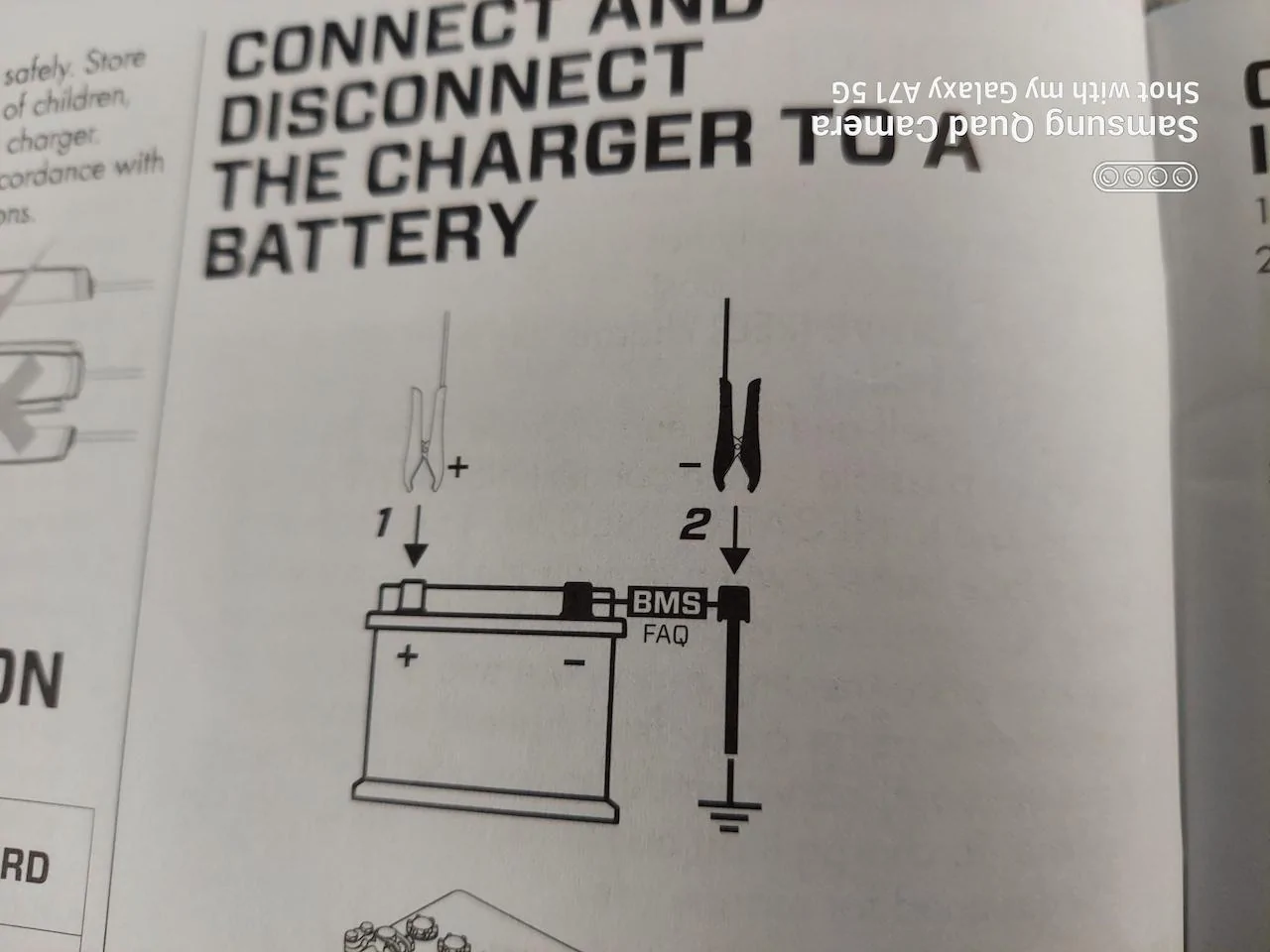

Conceptually, this is what you're striving for (from the Ford Performance tender install manual):

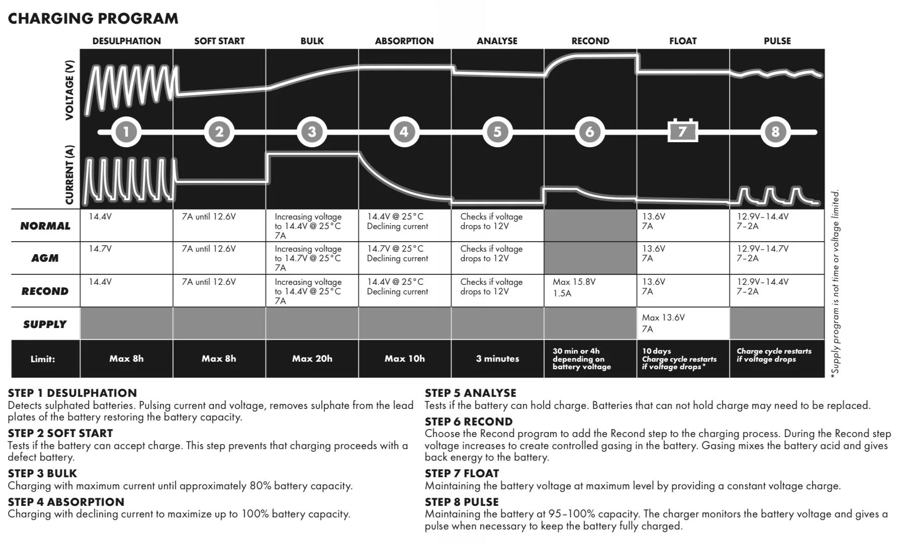

Once you are wired in, the battery re-connected and the tender connected, it can take some time before the tender is fully "up". For example, the initial stages of battery conditioning take close to an hour to complete (with my car). But the final stages can take as long as 24-hours. The initial one or two steps will tell you things are connected correctly and the tender is beginning its task/s. The ultimate and last stage on the FP unit can take as long as one week before it illuminates.
