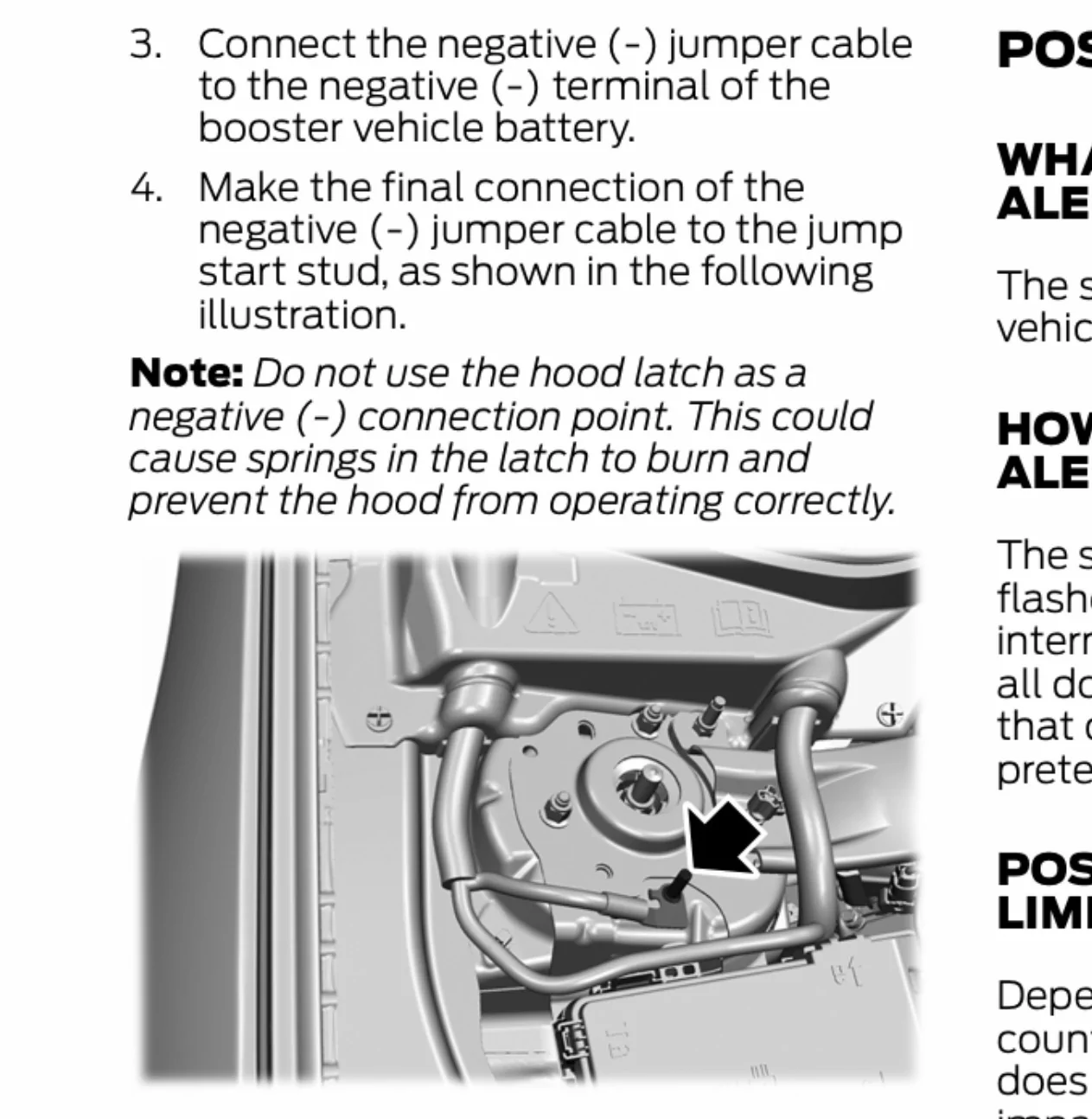

this may sound like a stupid question but I just received my ctek free and I don't want to mess it up. Can the negative be attached to any stud on the strut tower or only the one that goes into the battery?
Attach negative clamp to this stud in the photo. This is from the owners manual
And no it is not a stupid question. At all !
