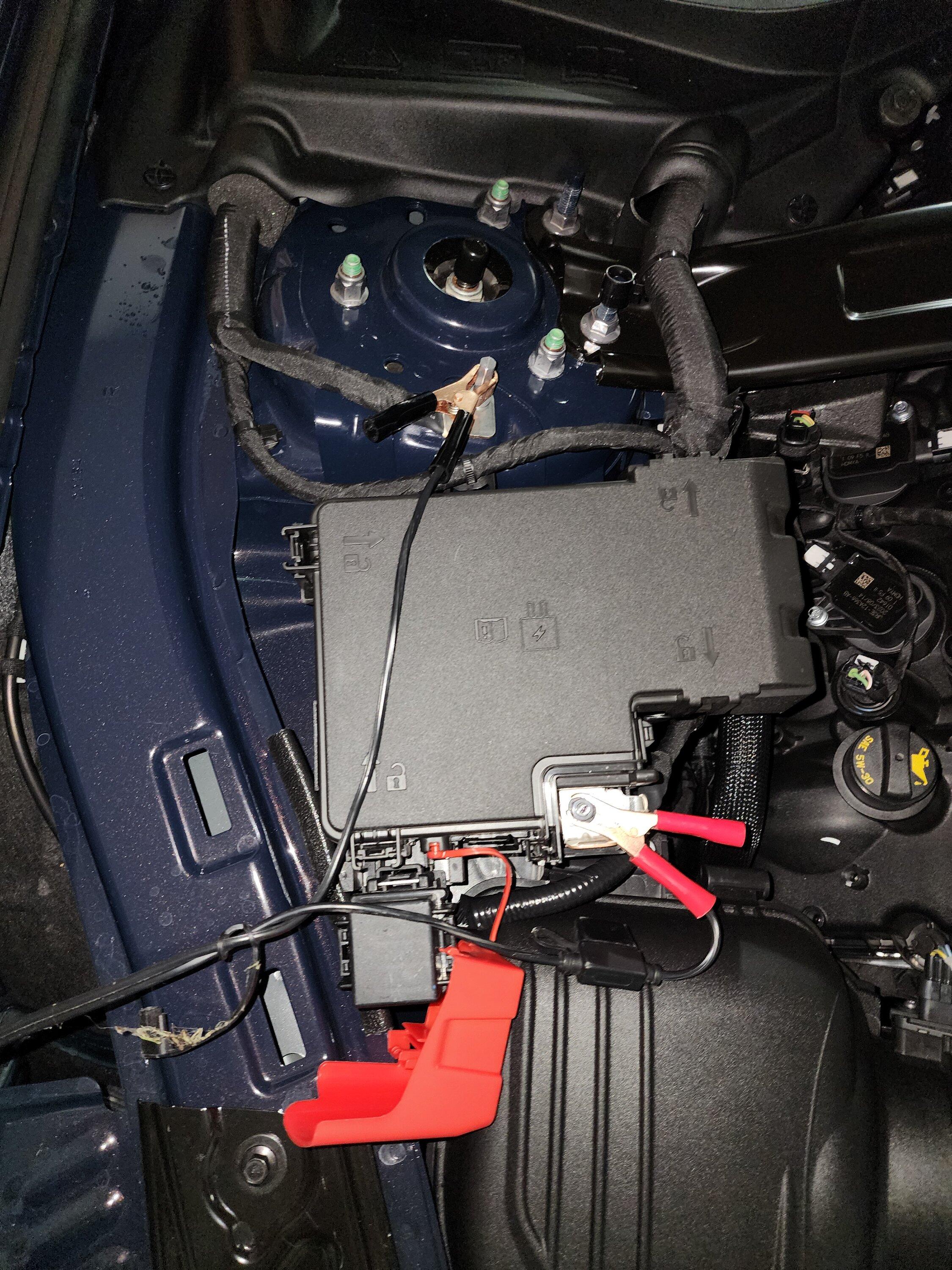

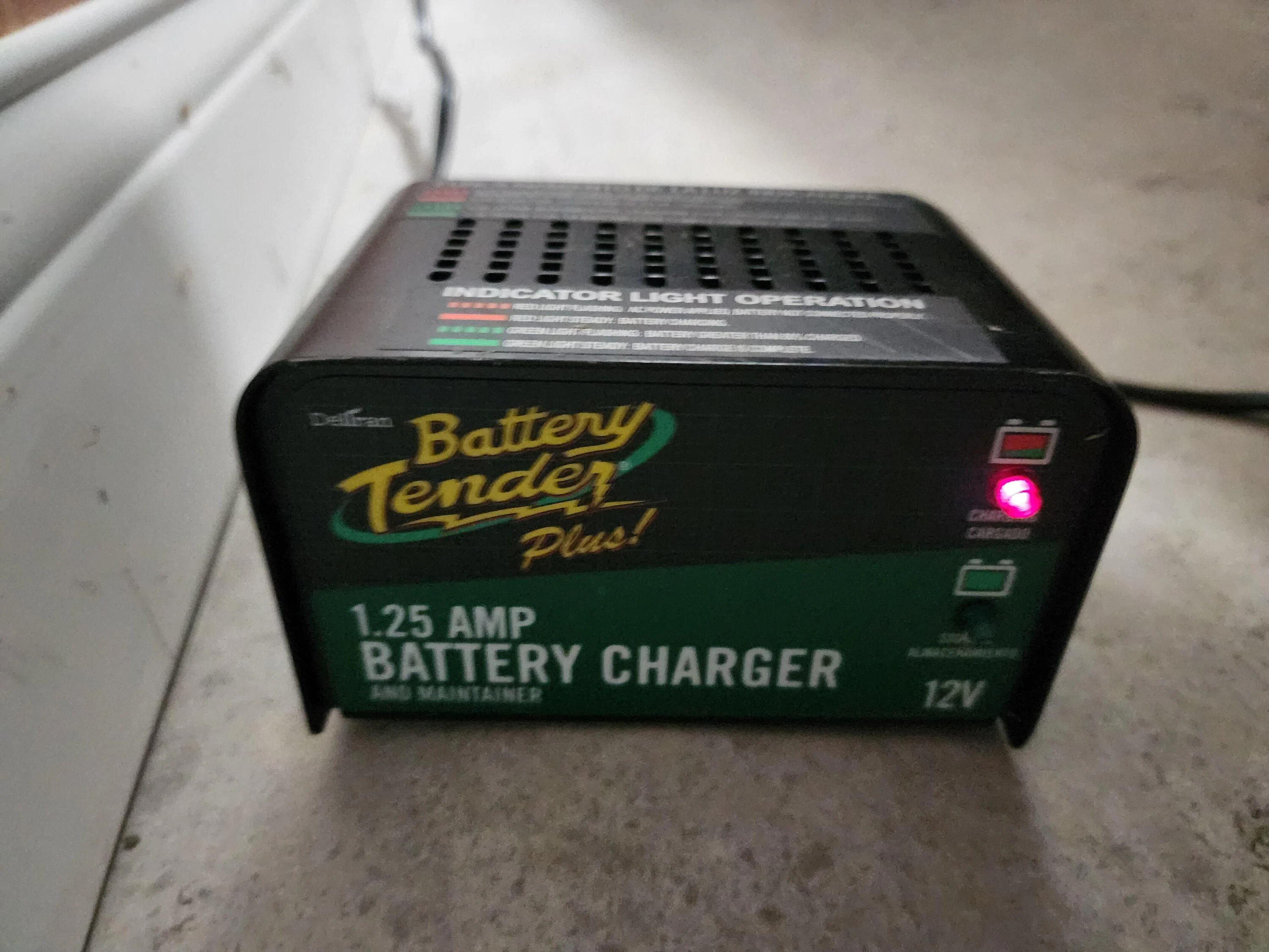

Bumping this thread. Is this old battery tender I used for my 2003 Mach 1 going to be ok/good enough for my Dark Horse?
S650 Mustang Trickle charger recommendation for winter storage. 20231119_182003
S650 Mustang Trickle charger recommendation for winter storage. 20231119_181942
I hooked it up yesterday, it read solid red, which means charging. I checked it again this morning after a good 12 hours and it was still solid red. Blinking green is 80%+ charged, so these batteries must really come from the factory low?
I've had one long drive with it, but the rest are usually 10-20 minute drives. I know the battery is constantly being used as I hear the car click on constantly when it's off, so maybe they just take a really long time to fully charge?

They are AGM batteries... you need an AGM capable charger.

That one is compatible with AGM. So the answer is yes, thanks!

It is 20 years old. I would get a new charger with a specific AGM mode. I personally use NOCO Genius chargers on my F150 and Mustang, and they work great.

The charger is not 20 years old, just the mustang was haha. I bought it new in 2018.
Update, it is fully green/charged this morning so it looks to be working just fine.
If it seems to be causing any issues (which I doubt 🤷‍♂️) I'll upgrade to the one I posted above. Never had any issues with Battery Tender brand.

What you have experienced is a good thing! A slow charge (which a max of 1.5A is) is much better for the battery. Most cars batteries are maintained at about 80% charge by the car itself to prevent the risk of overcharging repeatedly.

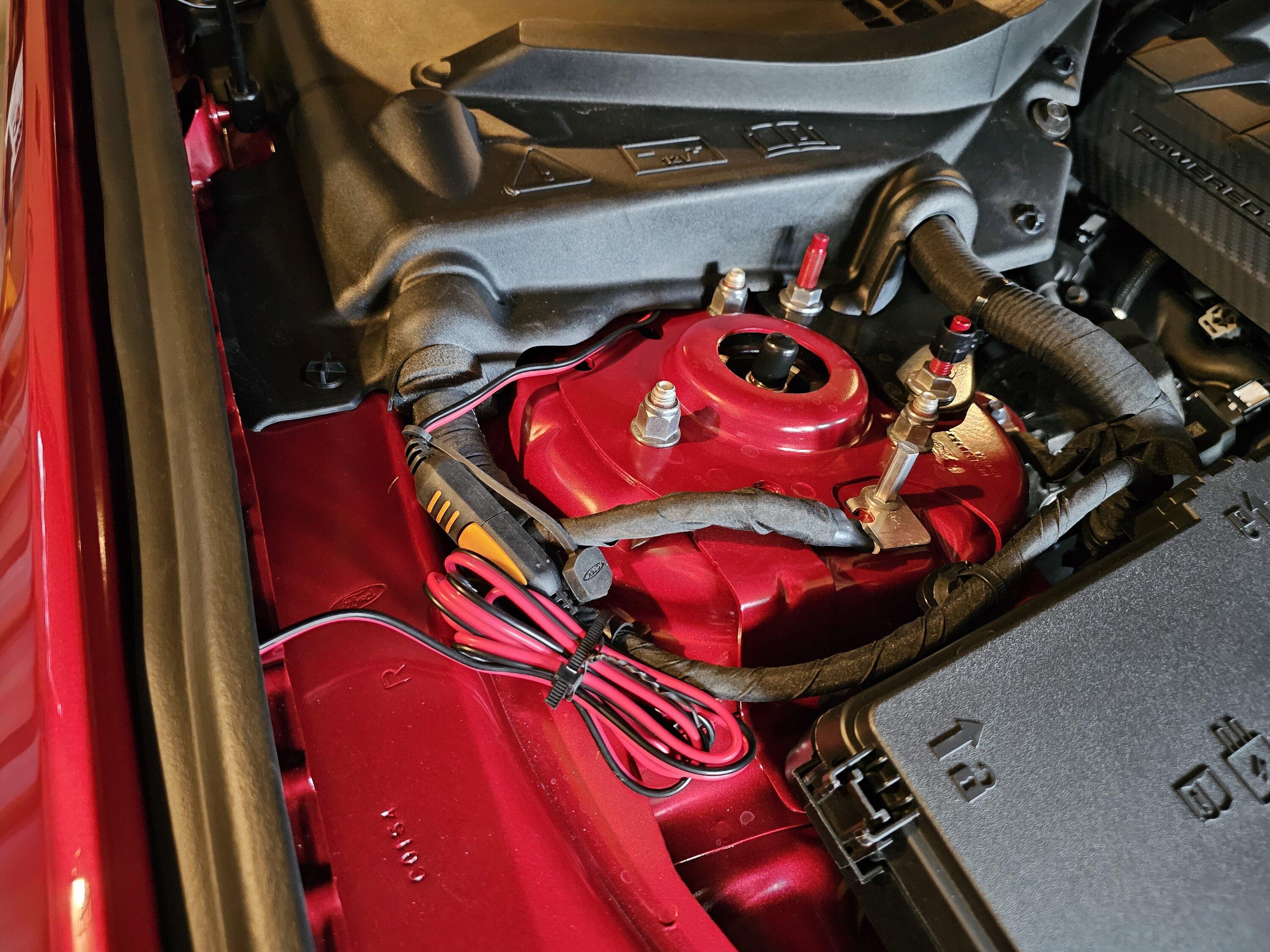

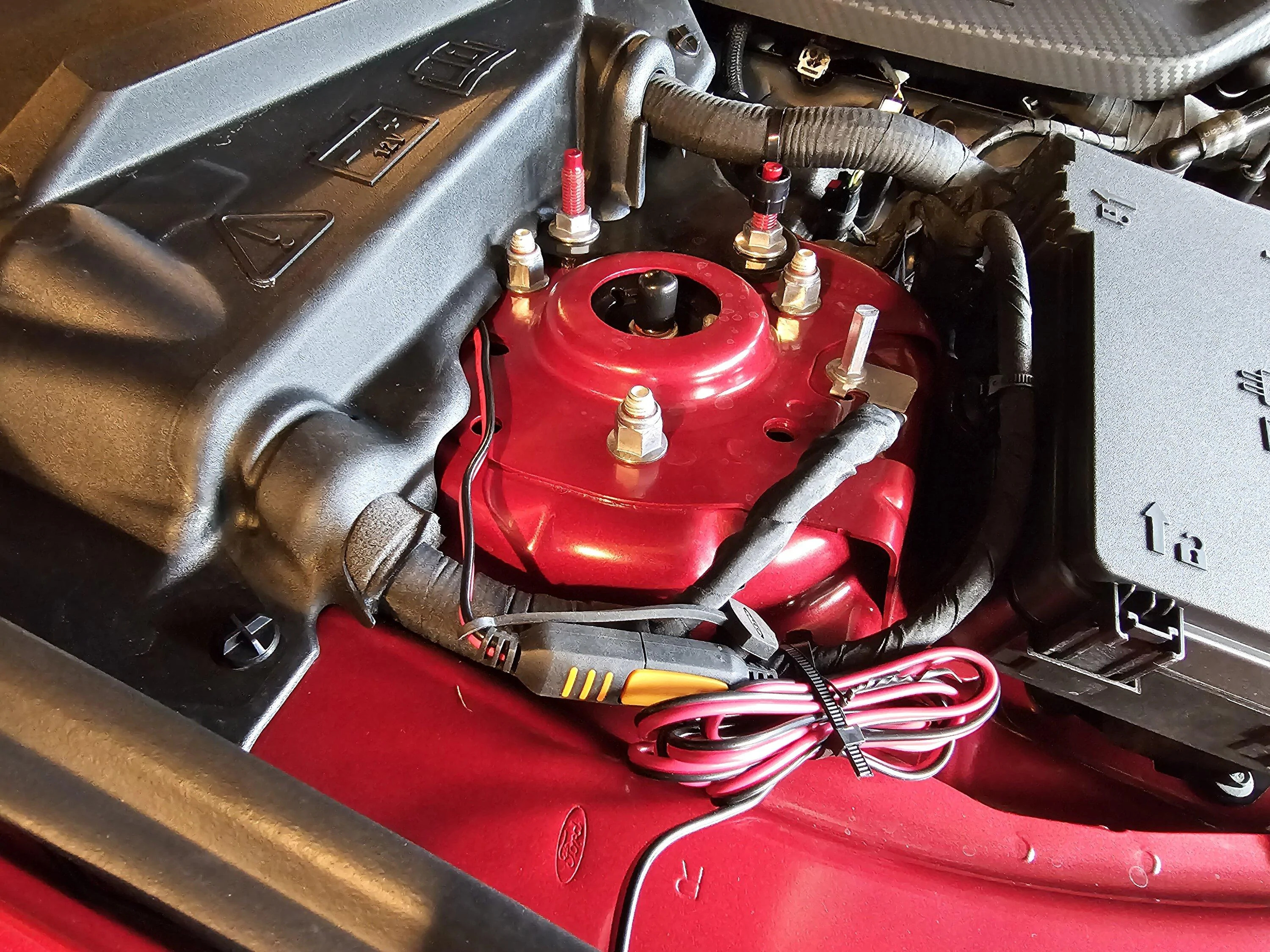

My 2024 GT coupe arrived last Saturday September 2nd. Ordered it in April. It replaces a 2007 C6 Corvette which I had on a ctek tender. I bought a new ctek not knowing Ford sold one. I connected directly to the battery with the ring terminals but the supplied pigtail is too short to fit up thru the back of the hood. So I bought a ctek extension cord on Amazon and then tie wrapped everything inside the engine compartment. Now I can connect to the ctek without having to open the hood. The connector that pokes out the back of the hood has a plug to keep out the weather. When driving I also tuck that connector inside the hood just far enough so that it doesn't blow around.

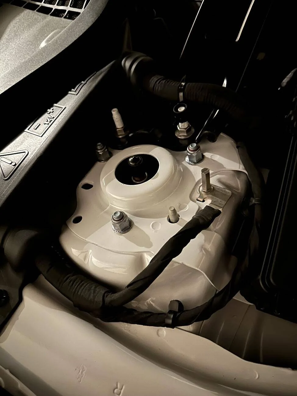

Finally, something that looks close to my own under the hood view.
Tell me more? How did you hook this up?
Positive on the battery terminal itself or from the FUSE BOX?
Negative/Ground on the battery terminal or from the Chassis GROUND Post?

The tall ground terminal on the strut tower (never to the battery -), and the terminal under the red cover at the fusebox.
