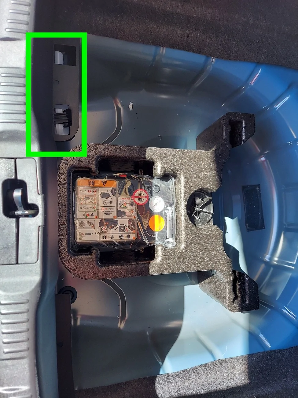

"with the small white funnel (found in your trunk)"
Does the small white funnel come with the vehicle New? because I did not find one that came with mine.
1,763
2,772
≈39N
It should have.
The funnel is kind of hidden in the S550. I suspect it's in the same place in the S650.
If you cannot find one, go to local parts store or order one on-line.
Edit,
To the uninitiated, the capless system used by Ford has two flaps in the immediate vicinity of the filler neck opening. Additive bottles will open the first flap; they will not open the second flap. The white funnel will open both, and allow additives and gas cans access.
The nozzle at the gas station is the correct size to open both.

It should have.
Edit,
To everyone, confirm you have one. Someone, somewhere, will run out of fuel and need it for the gas can.
Lol Thanks I just found it, I never seen it clipped there :wink:
