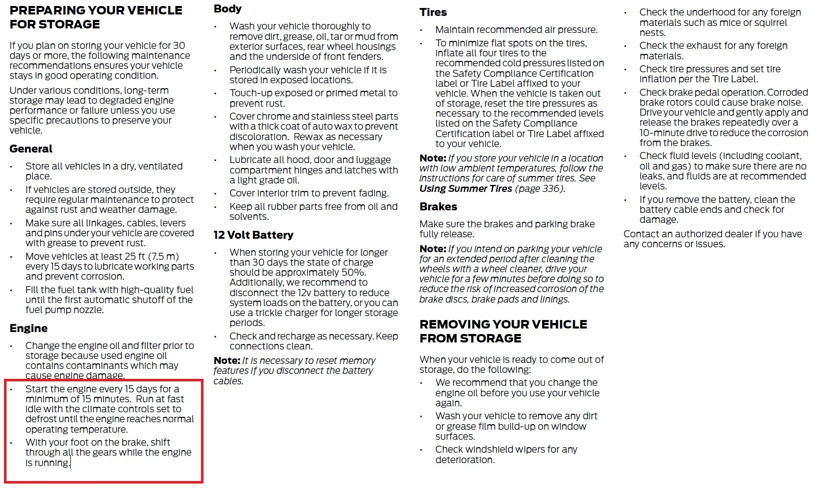

3,017
3,002
Right from the Mustang Owner's manual.
I find it interesting that it says to run it every 15 days.
I never start my motorcycles in the winter.
Probably so the battery doesn't die.
Again, just another reason the owners manual isn't supposed to be treated as the Bible.
