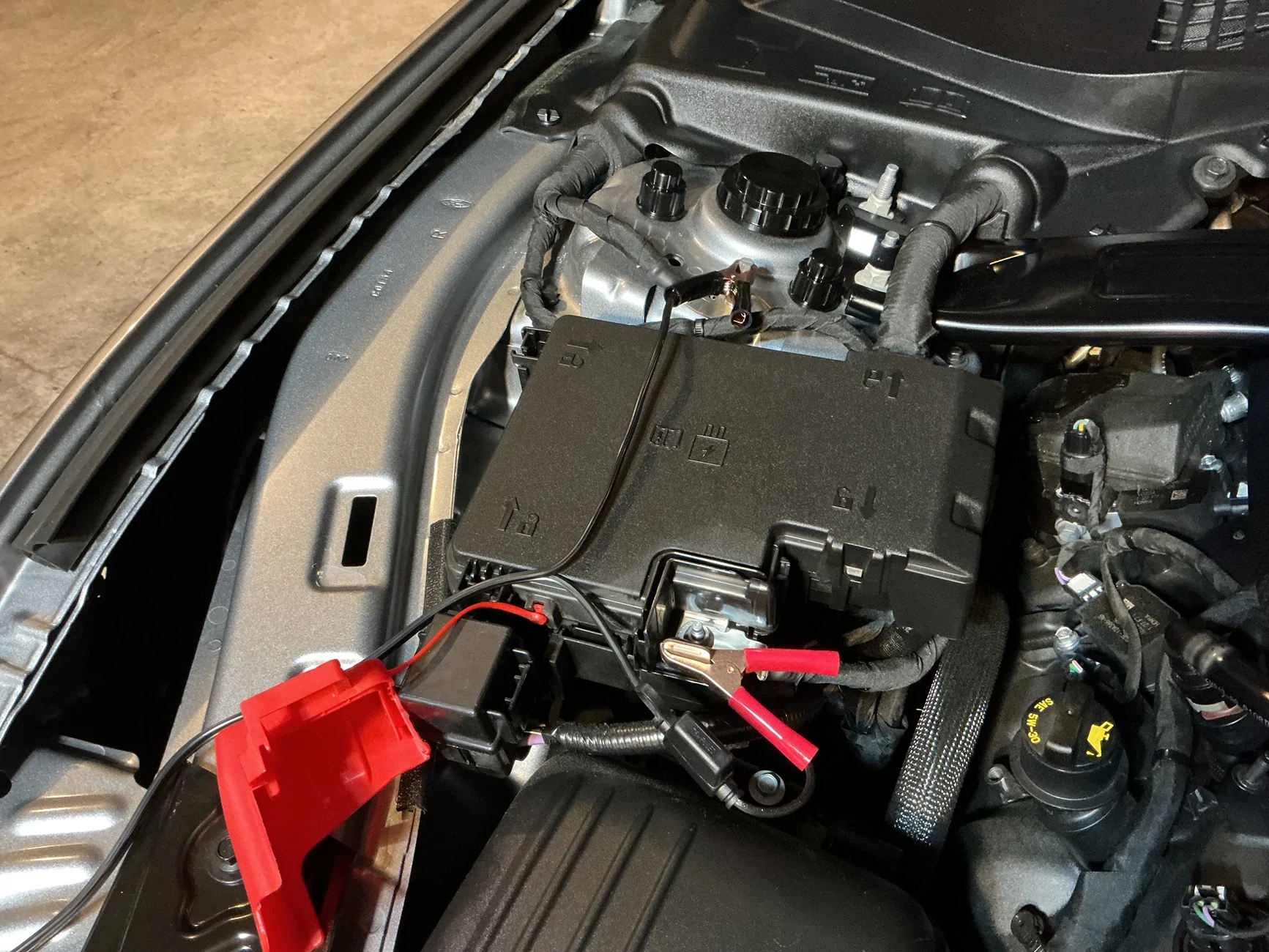

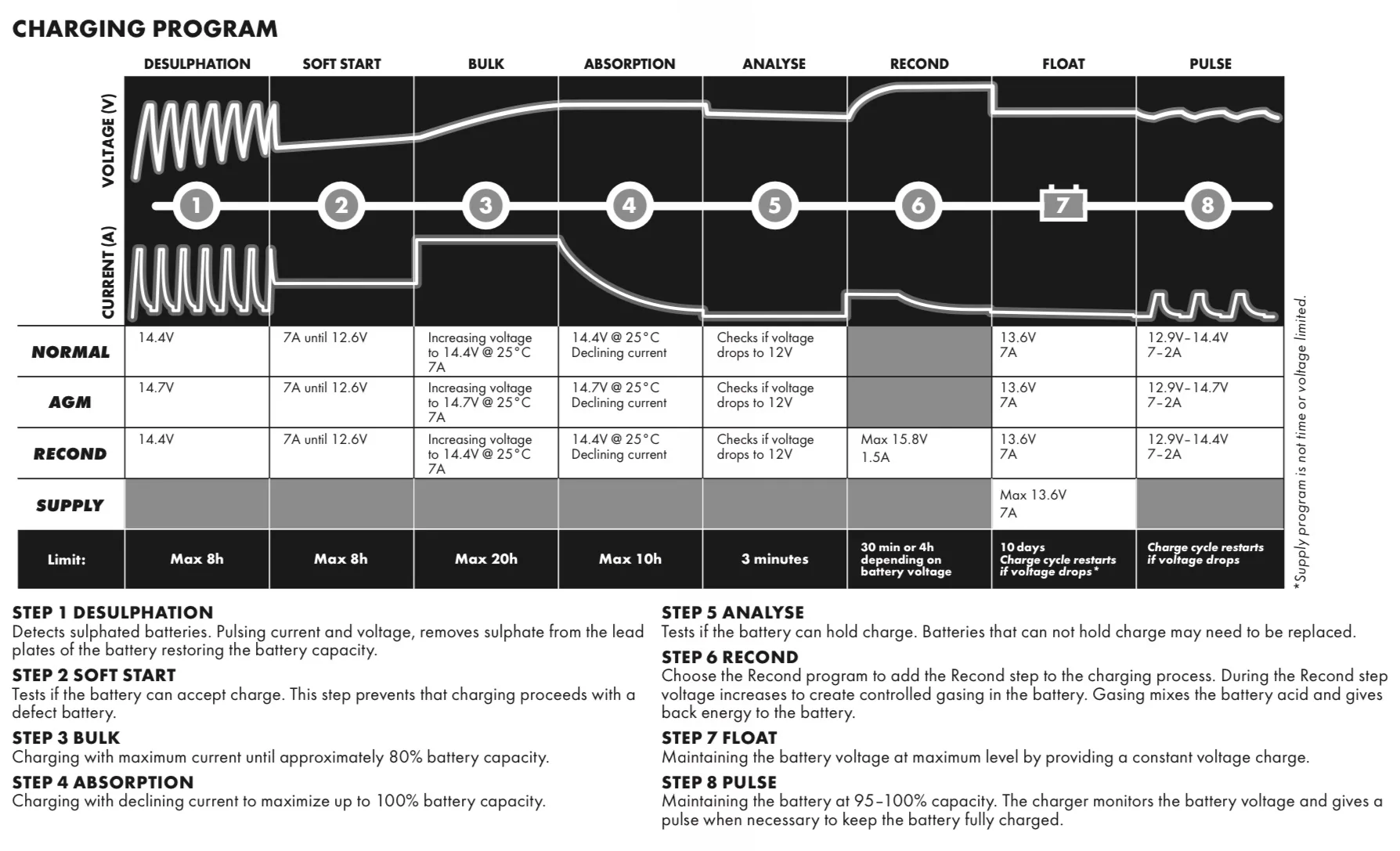

Apparently from what I read if the car sits for over 2 weeks and the battery goes into sleep mode, the battery tender no longer works on it.
About the 13 to 14 day mark, Skye will alert me of sleep mode. I've also noticed my tender will often go from stage 7 (float) to stage 8 (an occasional pulse, to keep the batt topped-up) around this time.
The attachment explains the stages available/used with the Ford Performance (CTEK) tender.

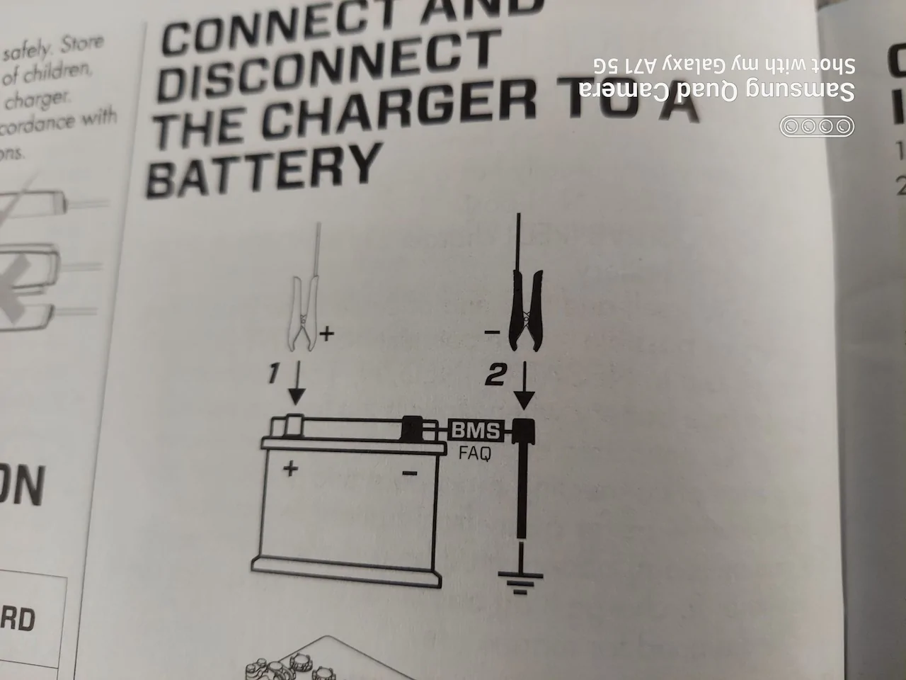

My tender has the negative lead attached to the chassis, the positive lead to the fuse box, and ultimately the battery.
All indications are while the car is in sleep mode, the battery continues to be monitored by the tender and topped-up when needed. Given the car is locked, sleeping and at rest, the amount of draw is probably quite low.
From Day 14, nothing changes. The car just sits. The tender stays in Stage 8 unless I disturb the car.
I've found I can take the car out of sleep by simply unlocking it. Probably any activity will wake the car. After locking and another two weeks, Sleep mode will engage again.

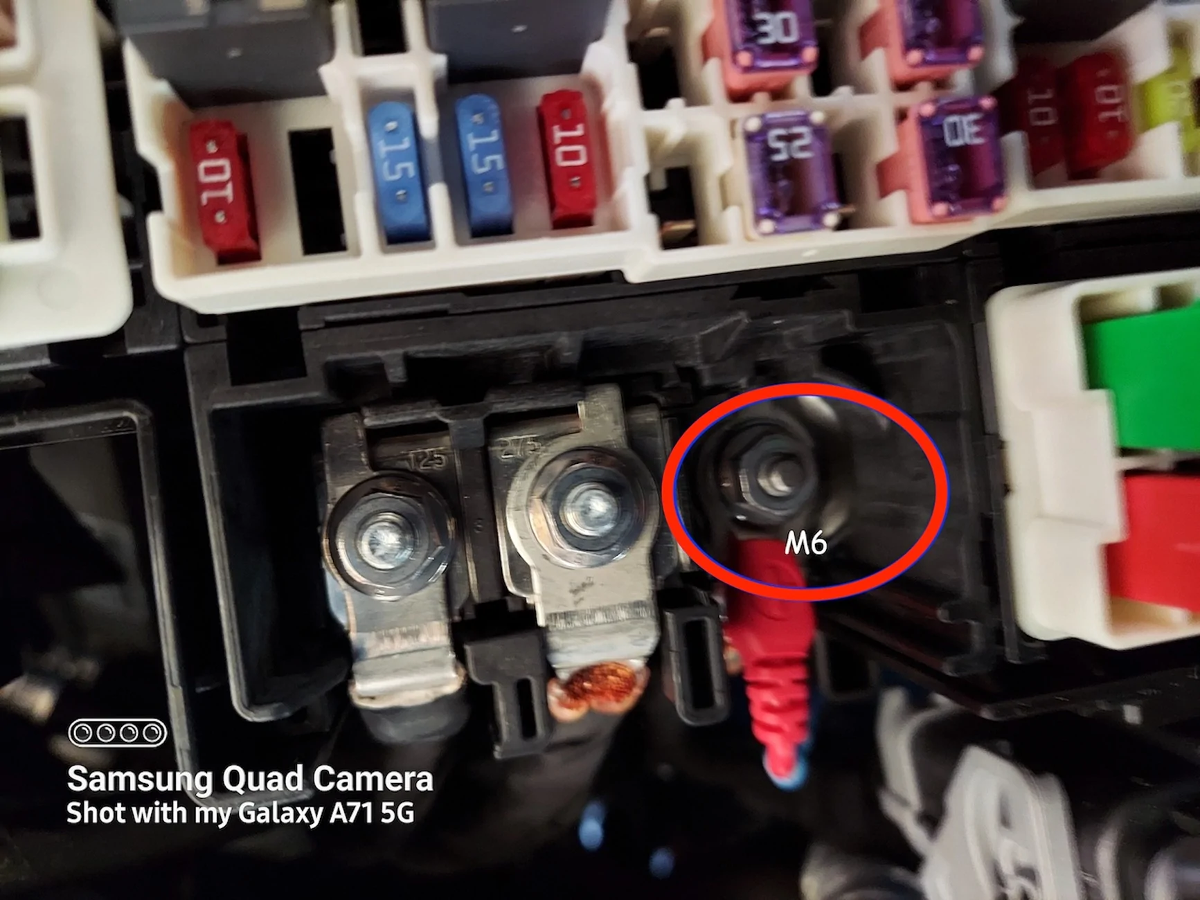

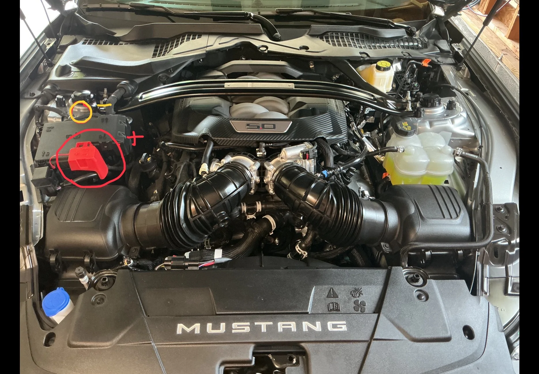

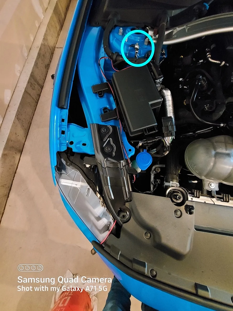

good stuff! When you say you connect the neg lead to the chassis...do you mean the ground post, or is yours right hand drive where it's too far away?
1,729
2,685
≈39N
Yes. The main chassis ground, near the shock tower; this allows BMS to capture the current flow from the tender and ultimately to the battery.
The other lead, the "+", is attached to the fuse panel. Attaching here allows for clean runs and lessens the chance of any entanglements.
