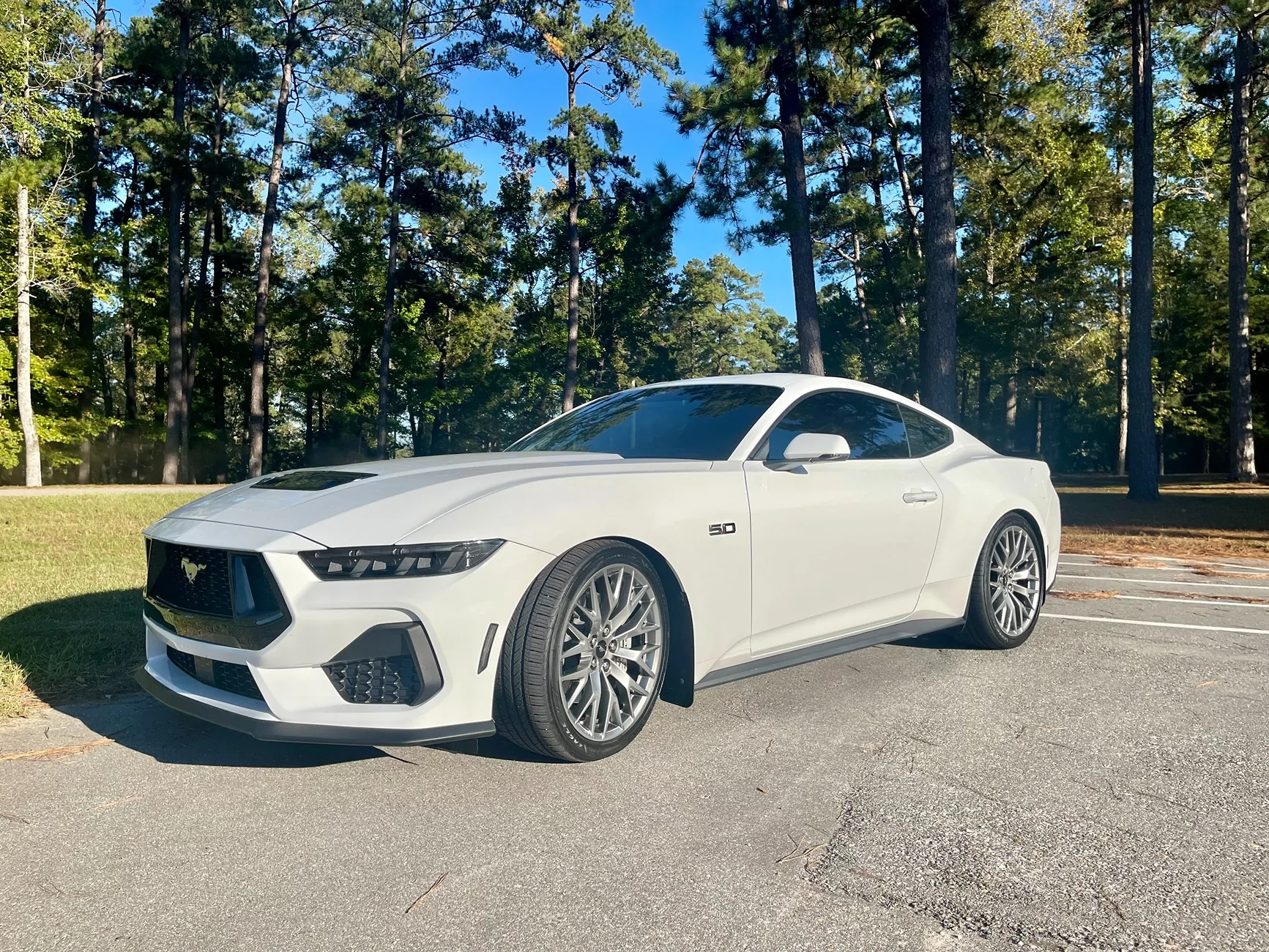

The Steeda Stop the Hop Kits were a significant upgrade to my non-PP 25 GT. I went with the Ultimate version along w/ their sway bar, end links, G-trac brace, Pro-action coilovers, and adjustable rear ride height system.
Wow. The car is extremely precise in handling and steering. Prior to the install I felt that 80 mph was the maximum speed that the suspension could handle safely. The car felt "floaty" and unpredictable— like a couch.
Also, the customer service I received was second to none. Couldn't recommend them enough.
