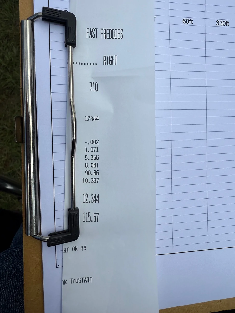

I have a 24 GT Convertible 10 speed. Took it to the drag strip and got hop on launch, and 3-4 shift. Added Steeda basic kit—didn’t need the body bracing as the convertible is already braced, but purchased the other 2 pieces for the rear. Helped, but still had a slight hop. Track is 1,000 feet up in the air, not the greatest weather, ran 12.3 @ 115.
