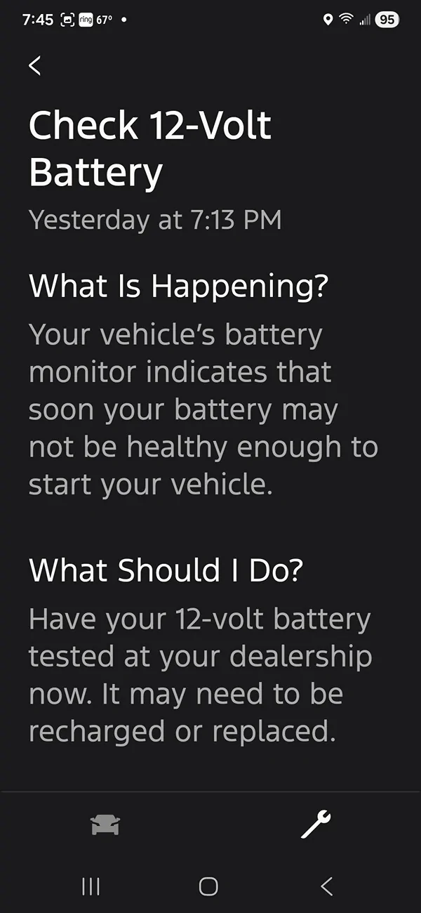

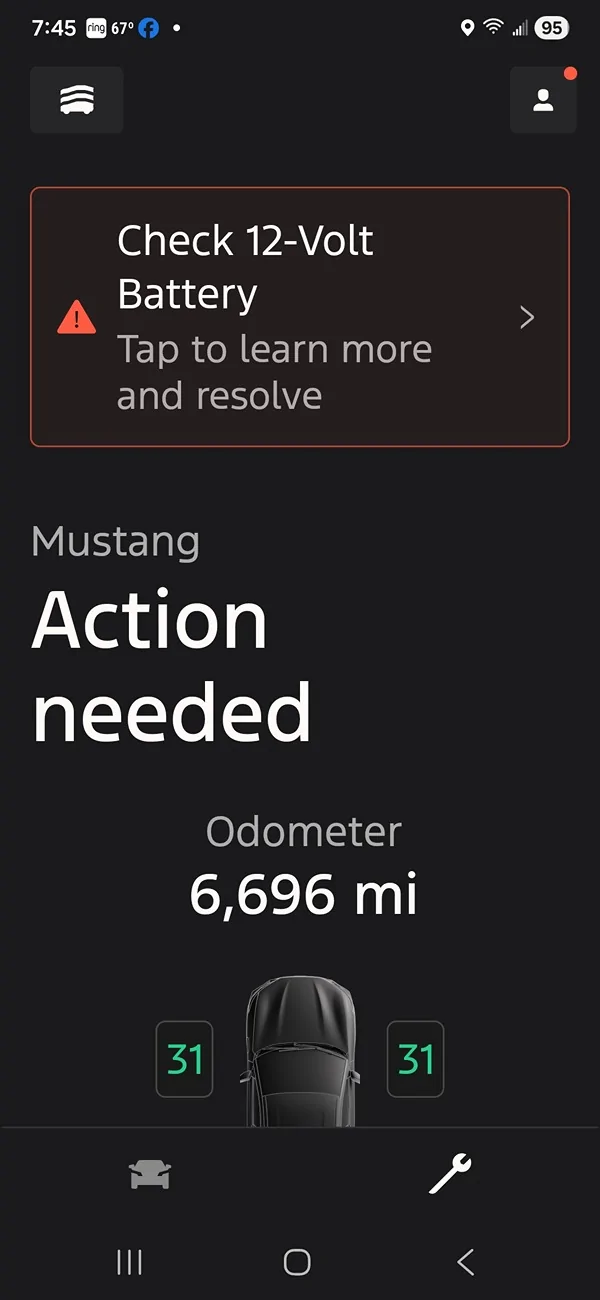

When my battery started to die I got this message on the app. Ford replaced under warranty.
S650 Mustang Battery Saver Mode and Cold Temperatures. 16431
S650 Mustang Battery Saver Mode and Cold Temperatures. 16433
Thank you for posting that pic. I haven't gotten that message yet so as soon as I did out of the snow I'll keep an eye on it. Take care!
