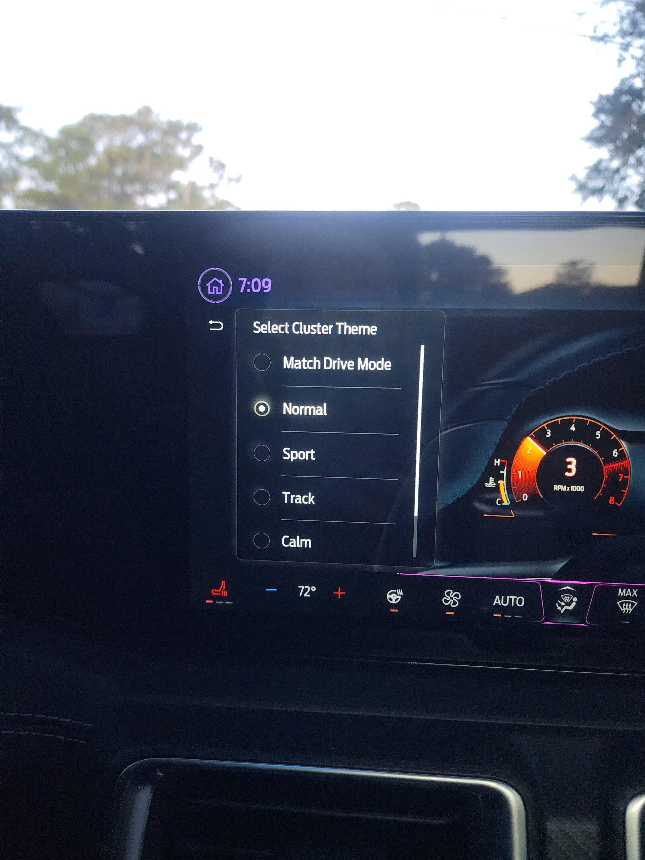

Please fix the cluster theme. I like my screen to show NORMAL but it sporadically changes it to TRACK mode. I can sometimes go 2 days with it staying in NORMAL mode then the next day, out of the blue, it will change to TRACK mode every time I crank the car that day. It is so irritating!!! Is it just me or does this happen to others?
When I select my profile & long press the "1" on the side door the dang cluster theme changes from NORMAL to TRACK mode. It will not save it to NORMAL.

try making the change, first. back out of the menu. Then hold down your seat memory button down.
If that doesn't work then its something ford will have to fix with an update sadly :/
