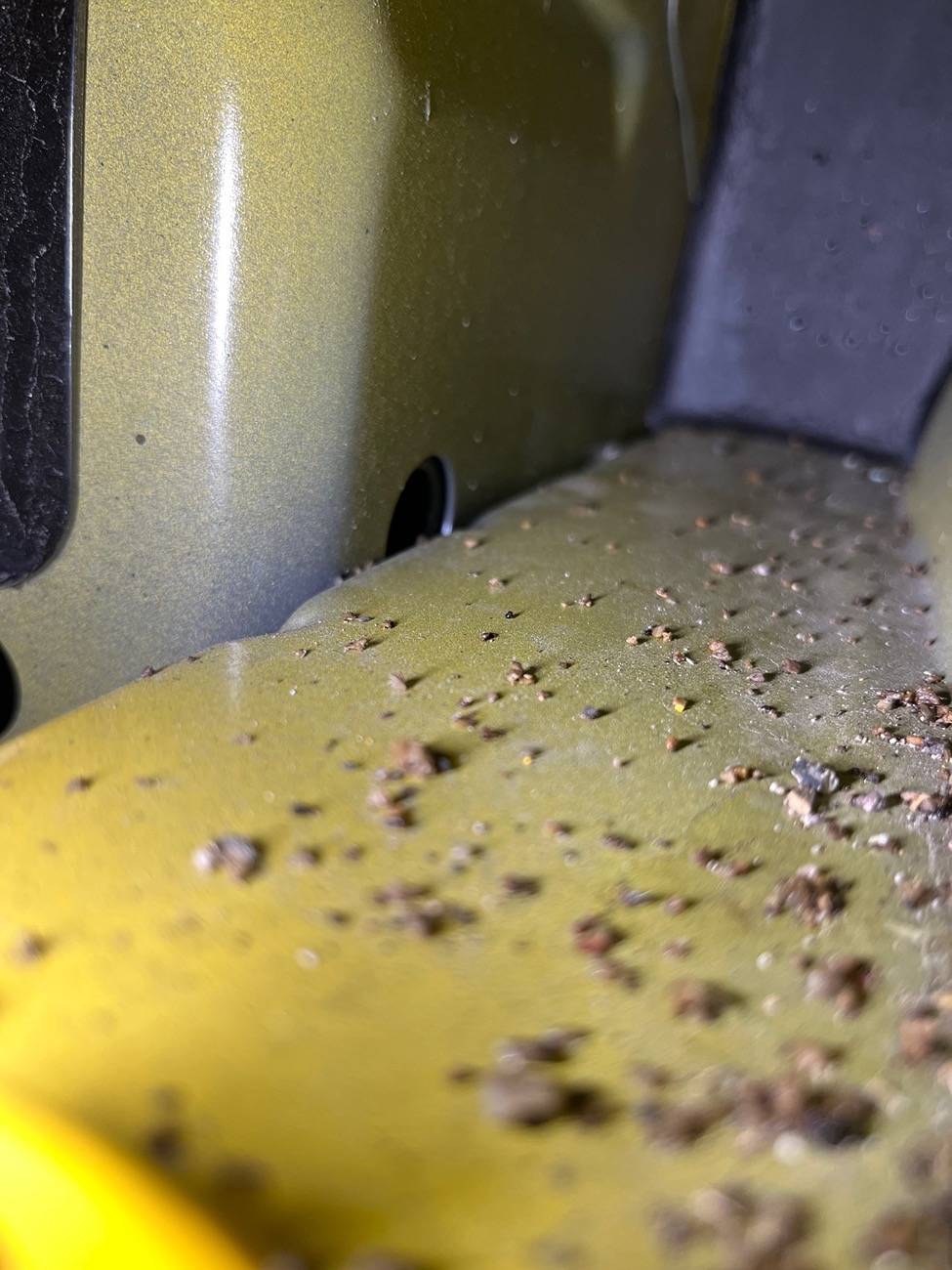

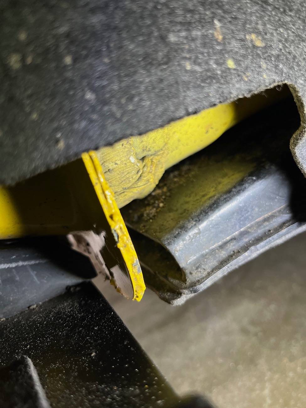

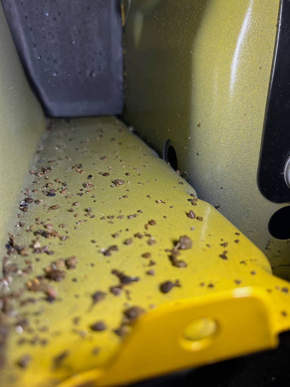

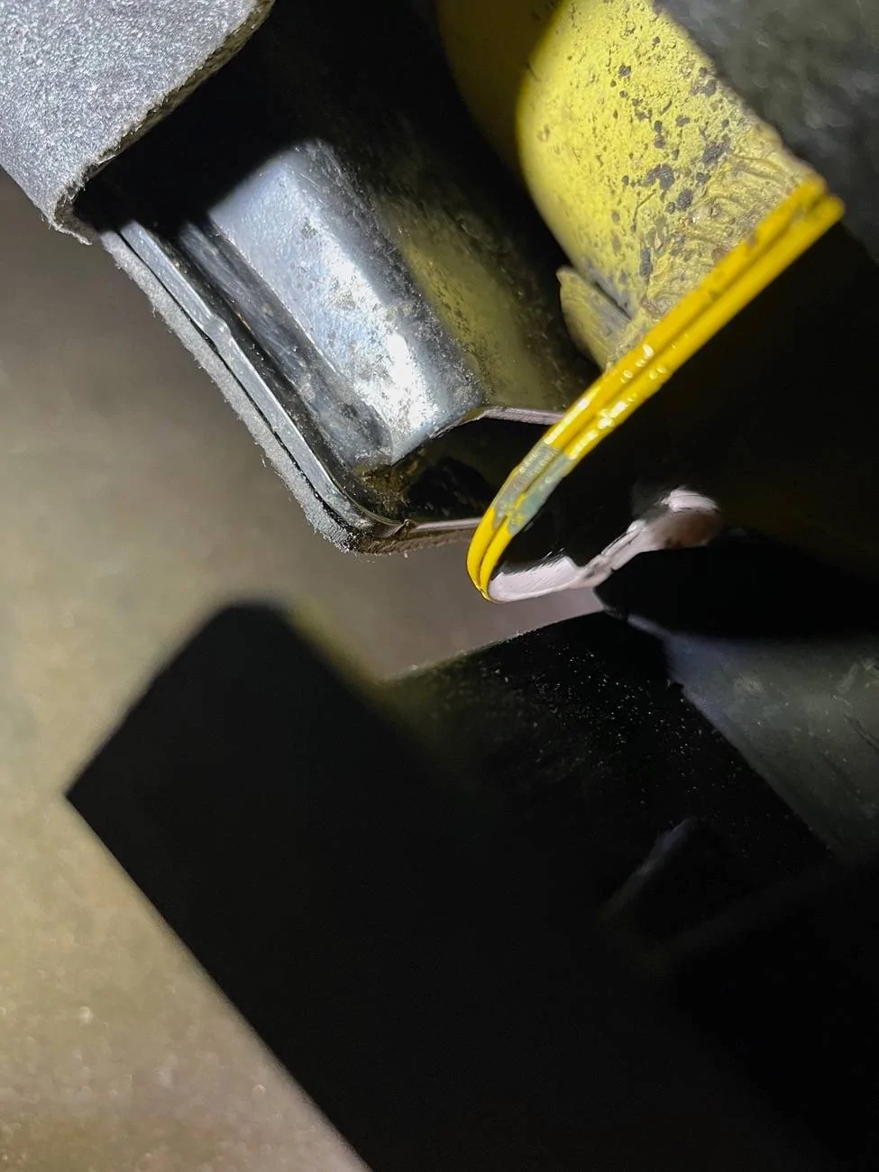

I highly recommend this modification. I did this a few weeks ago with about 3000 driven miles and wish I had known about this sooner. I'm including photos of the rocks and road rash on the pinch weld after just 3000 miles. I never drive my mustang in the rain. You can see how the paint has worn away with just rocks, imagine if this car was driven in rain, or worse, snow and road salt.
