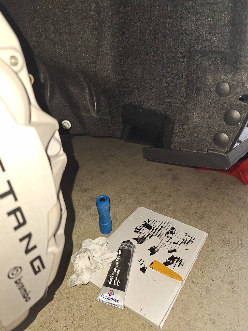

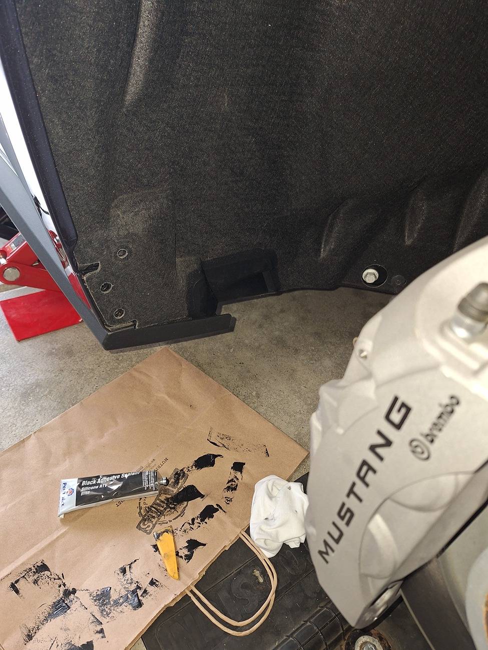

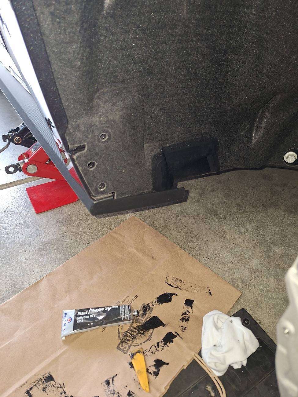

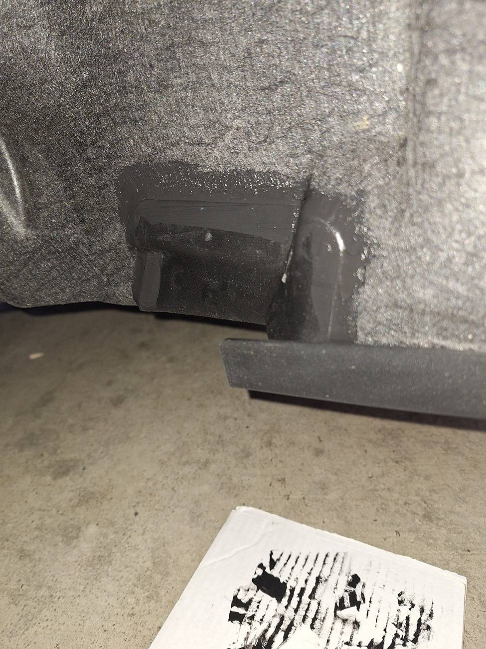

Followed the instructional Video to patch up the holes behind the front tires in the fender well on my new 24 GT. I have some black RTV adhesive sealent on order to put a small bead along the peremeter edges of the patch. I took a bunch of photos of dry fitting the patch with the supplied foam blocks. I let the passenger side set up for 1 hour and then did the drivers side. I put some additional temporary support against the patch when I moved the blocks from passenger side to drivers side. Let both set 3 hours and then removed all temp supports. The patches fit very well. Here is the link to the kit which cost 94 bucks and free shipping: https://diyvan.com/products/2024-fo...r-panels-kit?_pos=1&_psq=mustang&_ss=e&_v=1.0
