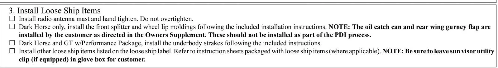

It would seem ford finds some value in one, dh seems to include one. At least according to the pdi checklist?
Saw that! Curious to see how that one looks!
Agreed. The interesting part is that Ford feels some need to ship it with the DH, but leaves it up the Customer to install it:
S650 Mustang Oil catch can YES or NO? SmartSelect_20230728_173743_Adobe Acrobat

since its in there with the gurney flap tells me that its probably only recommended if youre tracking the car, but not needed for every day use
