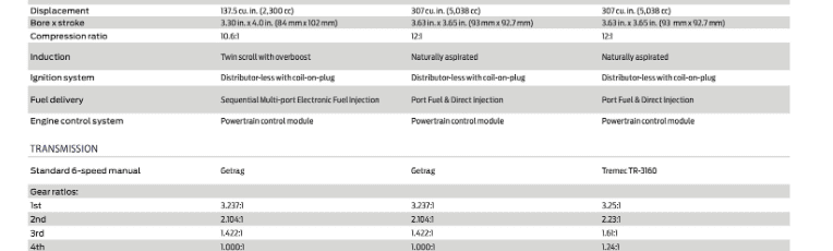

so the catch can is less of an issue as port injected fuel will wash the valves
Watch this about port injection fixing the carbon buildup on intake valves.

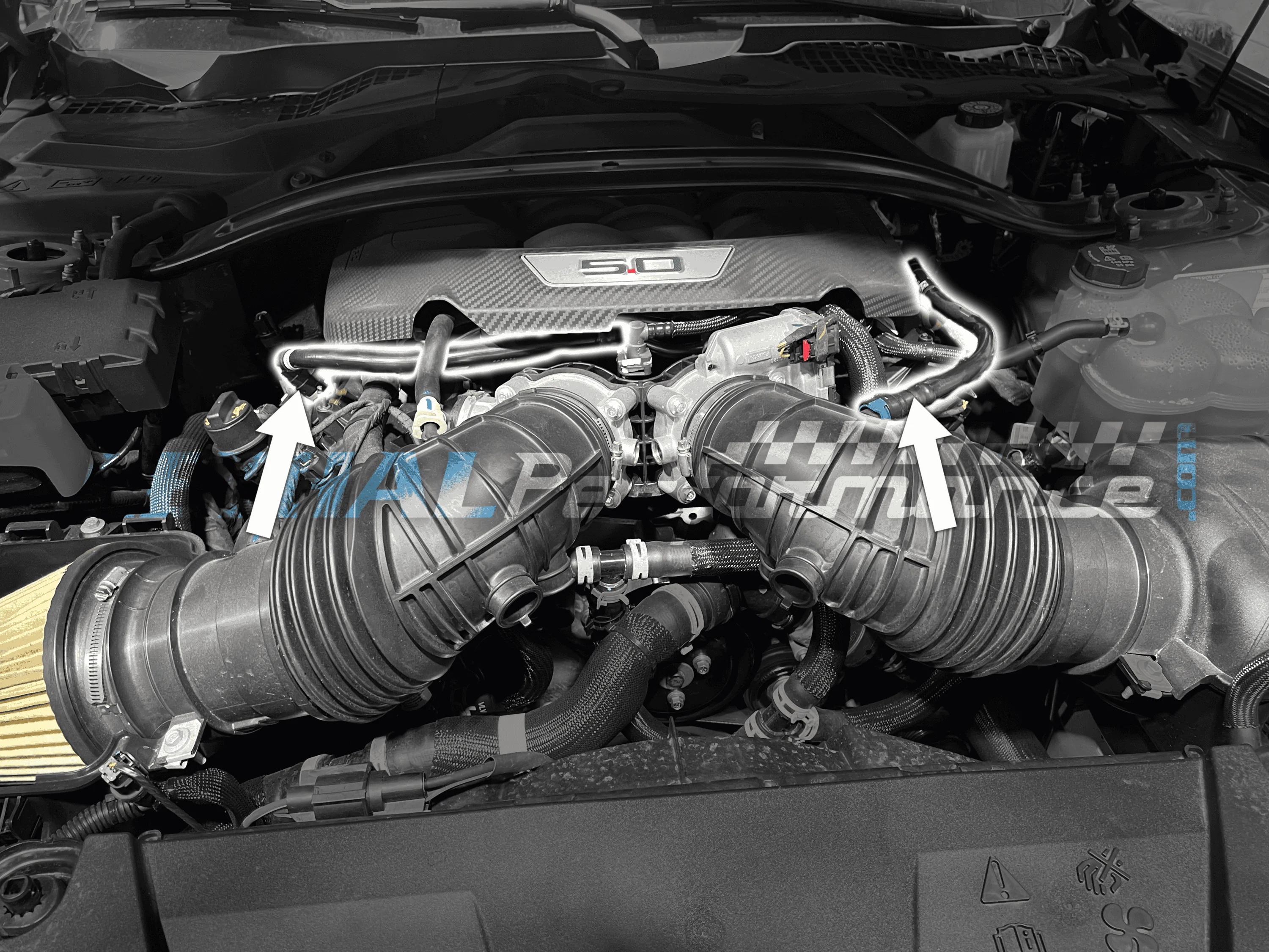

Speaking in terms of the Gen 3 coyote there's a drivers side PCV and a passenger side PCV. Typically the passenger side see's most of the oil mist however the drivers side can also recirculate mist from the valve cover into the intake where it then goes back through the throttle body/engine.
Now on the S650 with there being 2 intakes the PCV system may vary from how it worked on the S550 with the single intake. From pictures though, it looks to operate in a similar fashion, only uses one intake tube for the Driver Side PCV.
Once we get to spend some more time with a car developing the catch cans we'll have a better idea.
