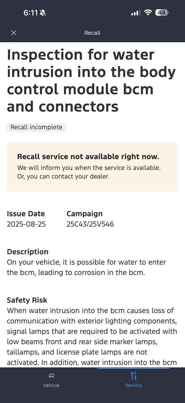

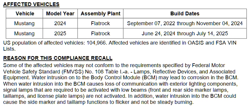

here is the information on affected vehicles and the reason
S650 Mustang New recall: water intrusion into BCM and connectors (25C43/25V546) 1756279019279-l
i've managed to avoid a few recalls, but this one got me. however, i can say that even in some pretty intense rain plus a fair few trips through a car wash, i've had no issues with lighting or the BCM. it's very important to remember that just because a recall like this comes out doesn't mean everyone will have it happen, or that it will now suddenly start happening
