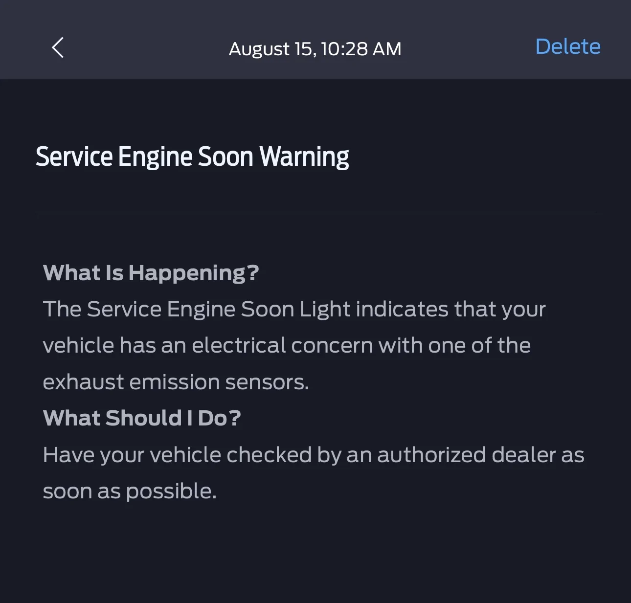

I went to the car wash earlier, and shortly afterward I got a “Check Engine Light” notification on my phone, and the CEL on the dash came on.
The only modification I have is a Steeda H-pipe (Installed 6 months ago) and carbon traps removed. There aren’t any sensors located where the H-pipe is installed correct?. I’m heading to the Ford dealer in a few hours and want to be informed in case they try to attribute the issue to the H-pipe.

Car wash? Something get wet that shouldn't have? Keep us posted.
As soon as I left the car wash the CEL came on. I’ll keep you guys posted.
