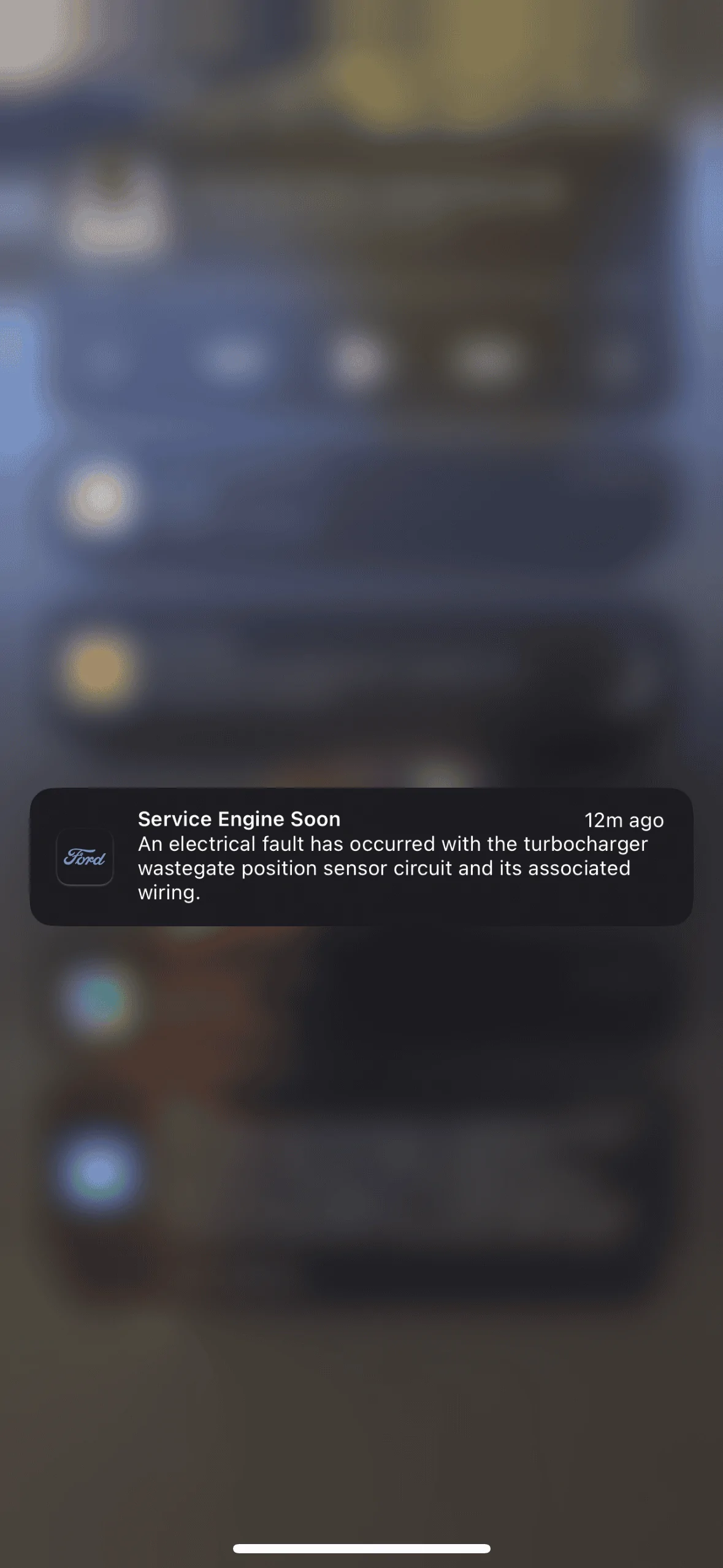

So after barely hitting 200 miles my check engine light turned on today (pictured below), taking it to the dealer tomorrow. I hope it’s nothing serious, after seeing what my brother went through with his 2015 I’m gonna have nightmares tonight.
Wish me luck.

If the message is accurate (not saying it ain’t) cars are artificially getting intelligent. The car seems to be saying an electric wire / circuit is either unplugged or melted / broken and it even lets the tech know which line. Dang. Smart it is. 😀
btw: good luck.

Just wanted to update the thread for anybody that is having similar issues.
I took it to the dealer and they found that the turbocharger wastegate actuator was malfunctioning so they replaced it the next day free of charge. Haven’t had any issues with the car since.
