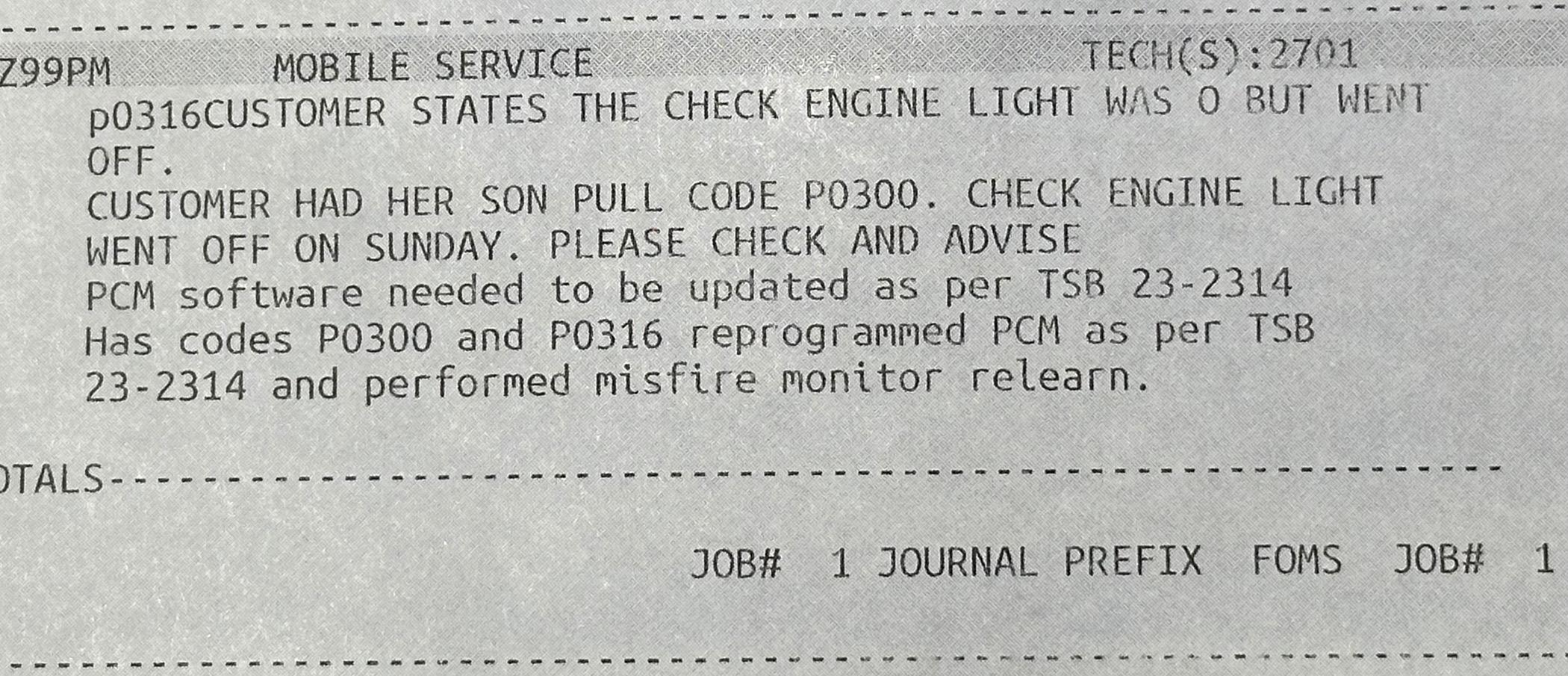

Still haven’t gotten in to see the dealer yet. Appointment is on Tuesday. The error code it threw was P0300. Yesterday the check engine light went off and I no longer have a vehicle alert in my app and it says vehicle health is good. Car is driving fine but I’m not accelerating the way I like. Will update when I get more if any info.

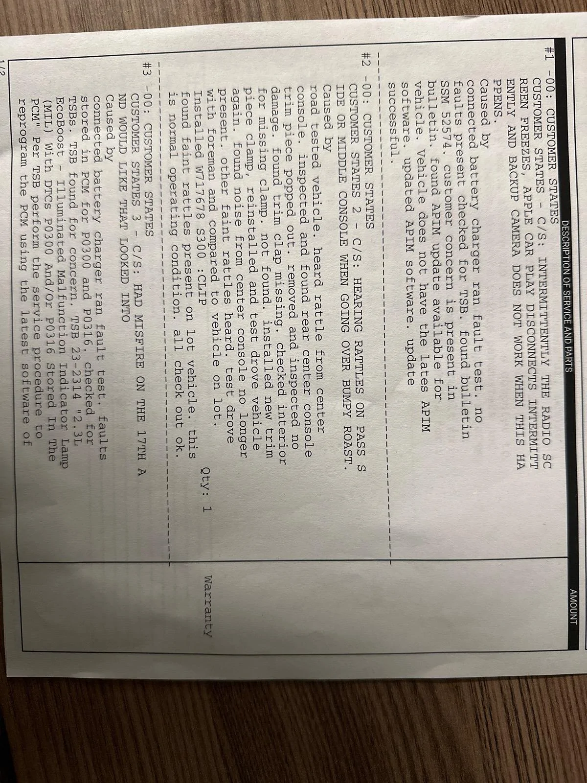

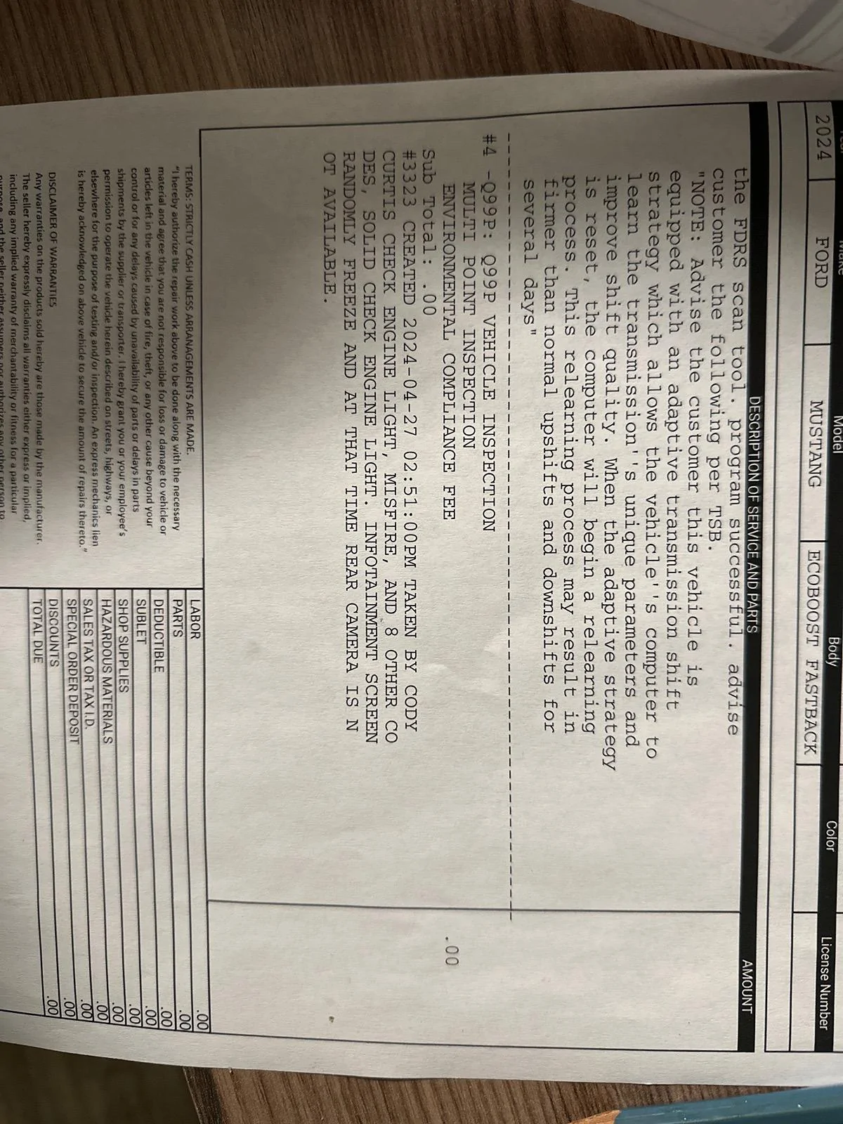

Same thing happened to me, this is what they did when I took it to dealer. Nothing wrong with the engine, they need to reprogram the APIM module.
CEL will go away in few miles, don’t worry

Thank you, but my dealer fixed the issue yesterday. The folks at Metro Ford in Schenectady are wonderful!
