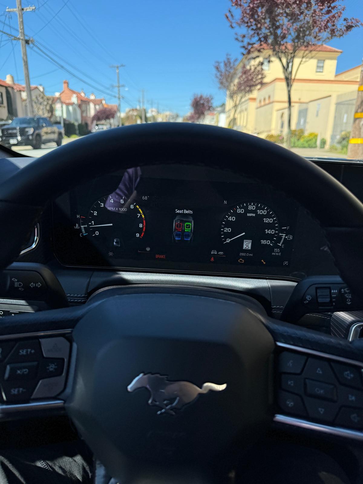

Hey yall, lurking for a couple months but new to the forums, unfortunate first post. Got my GT a week before, and after 280 miles, check engine light turned. (Monday, April 1st)
I was driving for around 30 minutes in regular city driving. Coming off of a stop light, probably around 15mph, my dash says seemingly everything has an error (ABS turned off, traction control turned off, collision sensors error, etc). Seconds after, both screens shut off. Engine still ran, which allowed me to pull over. Turned it off and tried to turn it back on to hopefully reset it, no luck. After about 20 minutes, it started right up, with seemingly everything working except now having both the check engine light on and service soon light on.

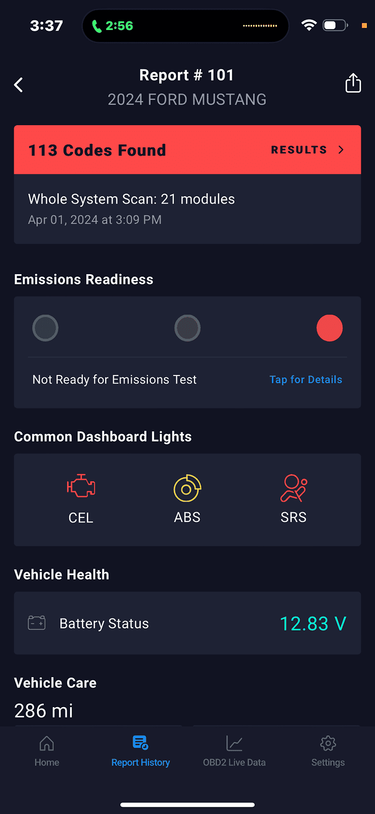

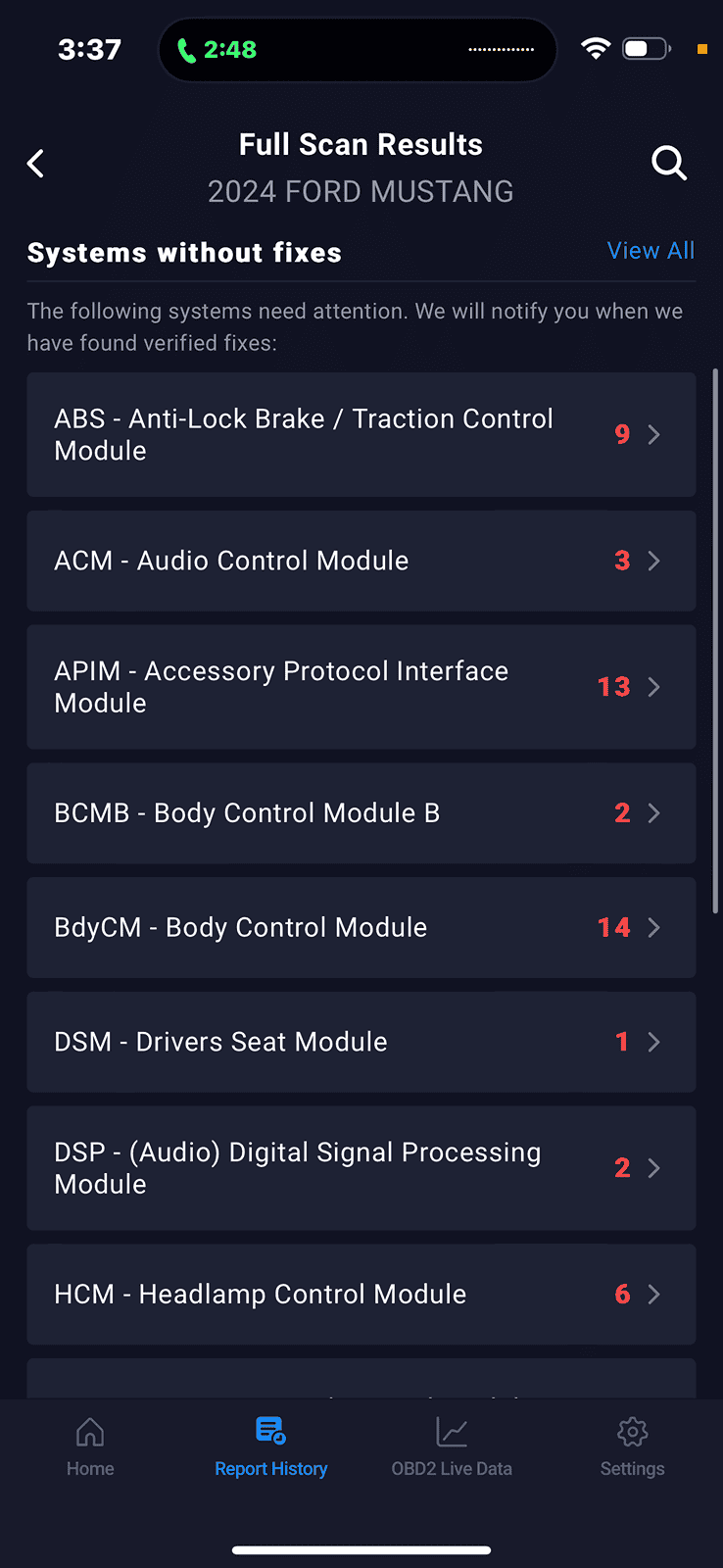

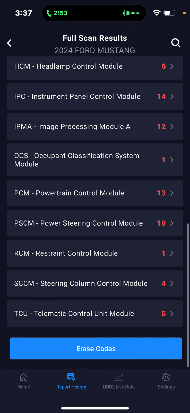

I scanned it with a scanner and got 113 codes, ranging from Powertrain Control Module to Headlamp Control Module to ABS to Drivers Seat Module.
I proceeded to call my local dealership and they said i could bring it in tomorrow and they’ll check it out (Yesterday, April 2nd).
Dropped it off yesterday at the dealership and now going to wait for an update. Will keep the forums updated, has anyone else ran into this? I tried to look up on the forums for something similar, but most of what I found is either glitches or a very specific check engine light, not everything freaking out. Looking forward to getting the car back, those few miles I drove have been great, but man does this suck.
Attached is the dash after it was able to turn on and code reader screenshots

Any indication if you have received and installed the latest ota update (re abs reprogram).
from what I’ve been able to tell the three predominate reported resolutions seem to be: weak battery, abs reprogram, replace gateway module.

Thanks for the suggestions! I believe the ABS issue is only builds before Feb 8th & my car falls after that.
Regardless, I got an “update” from the dealership, unable to verify any issue with the car besides finding a ran out of gas fault. I most definitely didn’t, in fact I was over half, but maybe it was just a left over code. Not what I was expecting back, but i’ll just hope it was a one off thing and it won’t happen again.
