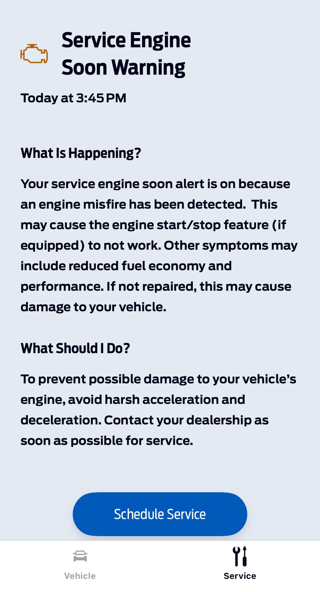

Dealer can’t get car in until next week. Anyone have this issue yet? Ok to drive?

Is the check engine light on inside the car or does the app just give you this message?
4,852
2,675
While acknowledging that dreaded light. Pop the hood make sure it’s still there. Service engine misfire can occur from anything as simple as no gas cap (doesn’t apply since no cap on ‘24), a loose plug wire, bad gas, oil leak, air leak, internal malfunction, software anomaly. It would be helpful if the app included the ‘code(s)’ with the alert message but since they don’t.
does it idle worse than it did? Gt or eco? Once you get the ‘code’ it should help troubleshooting.
Some part stores will scan for you or any basic code reader should be able to retrieve the code.
there also seems to be some on here that may be able to ‘ping’ it based on your vin and let you know, ymmv.
Both. Chatted with Ford.com rep. Said if light is static, emission control service requires service. If flashing, get checked immediately. Frustrated since it’s still new. Frustrated can’t get it seen sooner. Never cared about this in any other vehicle but this one is my baby.

A flashing CEL is the sure sign of one or more plugs not firing
If you have an intermittent misfire, with enough counts to trip the light, you will get a code P0300 for multiple misfires followed by P030X with X being the cylinder number.
A solid light and a warning about misfire is you have something less serious going on that has to be looked at
The problem is you have to look at the whole picture to see what is going on, it may be a coil, a bad connection, it could be a bad injector, it could be a bunch of things, you have to look at all the codes and figure it out, or go in with a scanner and do some Mode 6 tests such as cylinder contribution
You could pop the battery cable and wipe the code, it will take some time to relearn some functions, and the codes will be stored in the code history

Hi AmyJean! I can look into your Mustang's error message concern on my end. To get started, could you please send a private message over with the name/location of your local Ford dealer and your Mustang's VIN?
