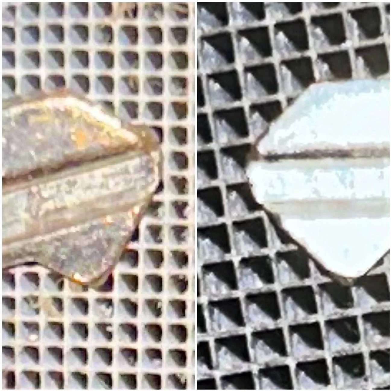

For reference, I'm attaching some photos:
- A S550 GT cat, just starting to crack from boost pressure
- A S550 GT cat, cratered
- A comparison of a non-boosted, F150 and GT500 cat. Notice the design allows for increased flow
If cat failure is confirmed, that is not an unusual condition. Some re-fit GT500 cats to their exhaust. Others, remove them all-together.
Those with boosted setups can provide guidance as to what has worked for them.

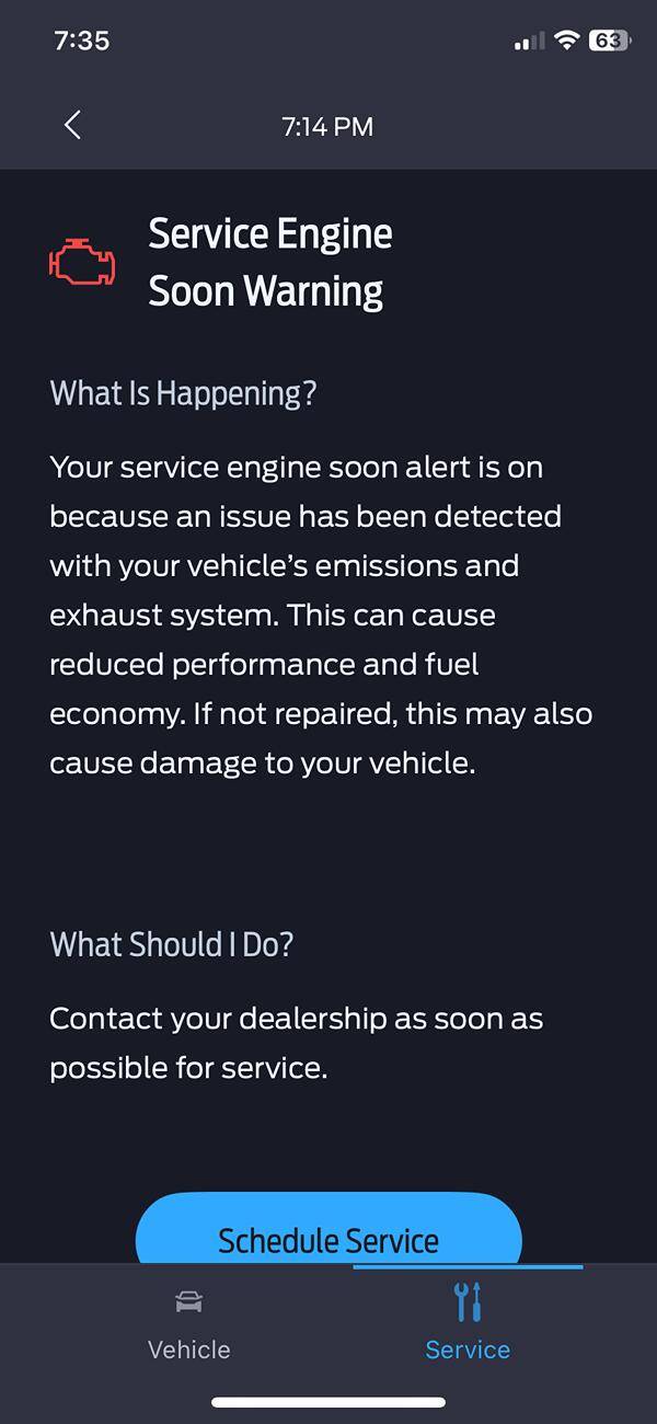

I did the same Kooks long tubes headers/green cats with Awe mufflers. Man, it is loud and awesome! Just recently, I am getting warning for service hereby below:
Screenshot 2025-04-27 at 7.36.24 PM
S650 Mustang Check Engine light w/ 4,300Miles IMG_3314
Is there some concern about it?
