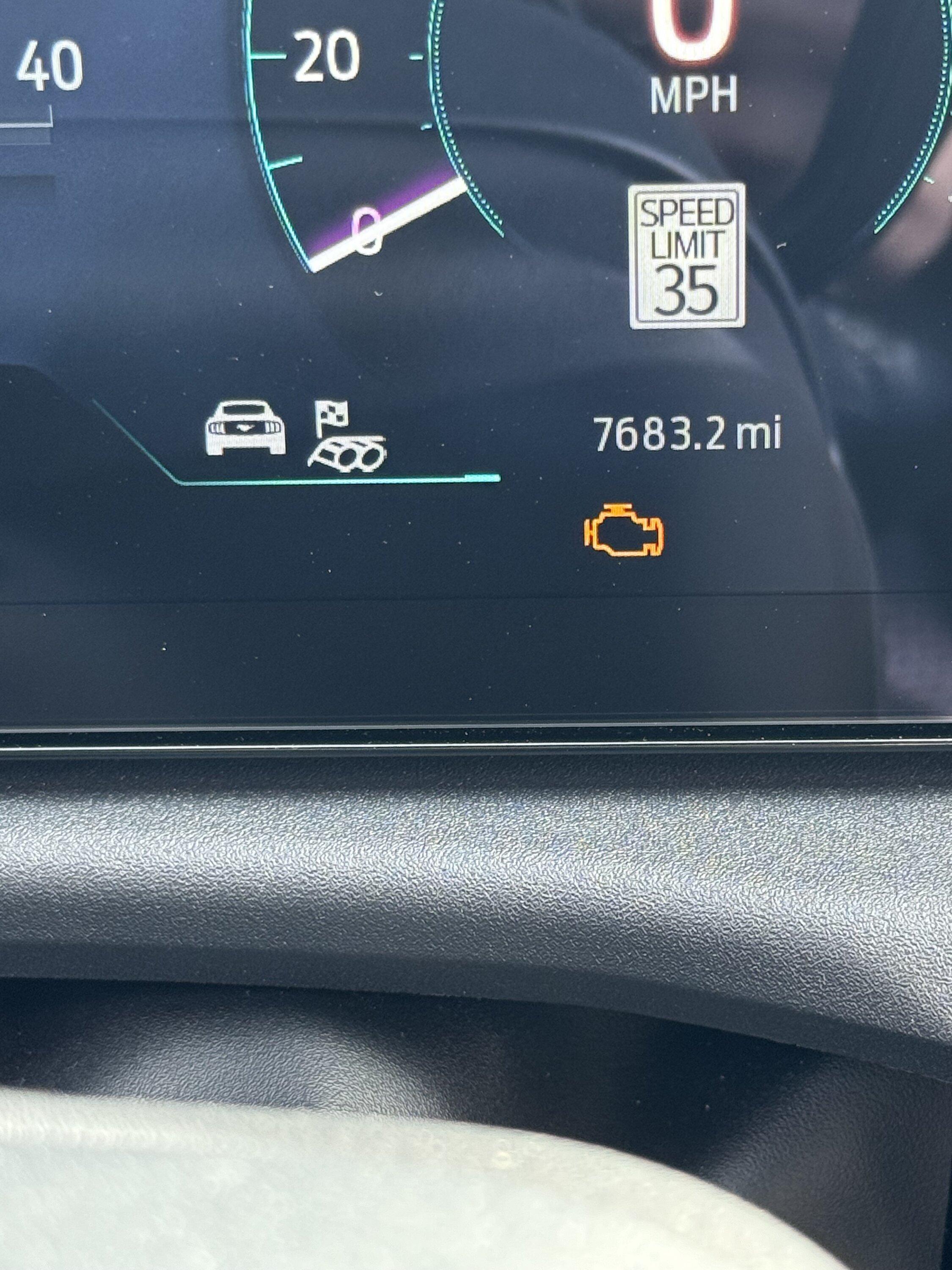

Check engine light came on this morning while driving to work. No loud pop, no smoke, no nothing but something is definitely wrong.
Anywhere past quarter to half throttle it feels like the engine gives up and I lose most power. I just had its first service a couple weeks ago and now I got to take it back on the 1st for this, bummer. Has anyone experienced something like this? Kept it under 4k on my commute and am not looking forward to the drive home. Will keep it off until the service.
This is my first Mustang in a decade and I have been loving every minute so far until this point. I will come back and update the thread with what the dealer says. Hoping it’s just a tripped sensor and nothing major.

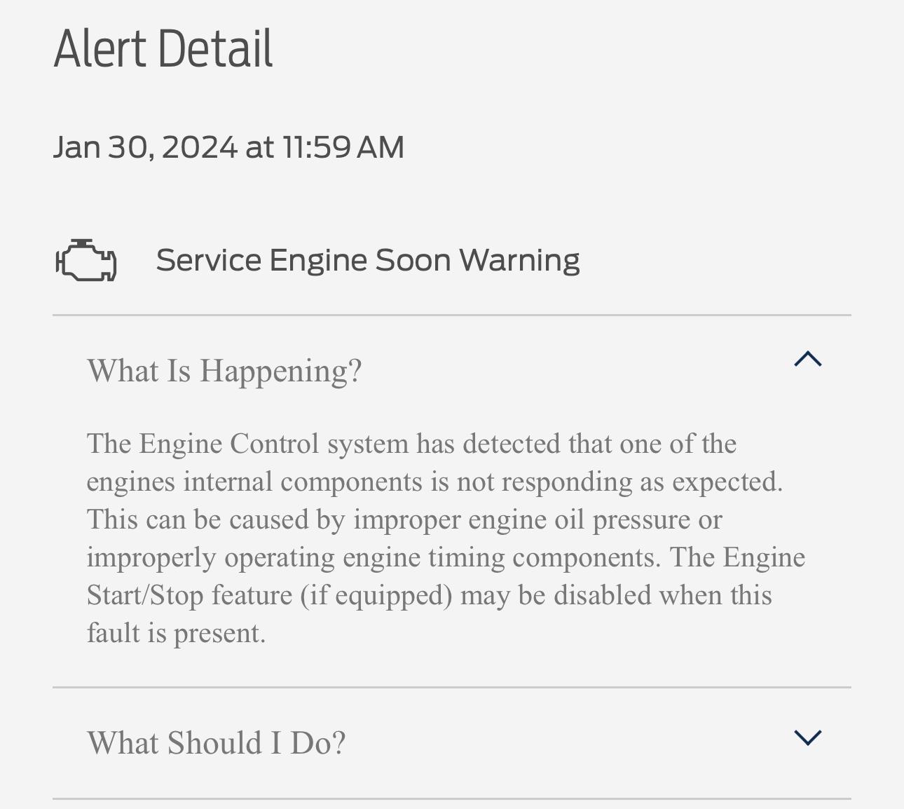

Edit: Here’s what pops up in the app.

The computer has determined, probably incorrectly that engine damage will occur if you push the engine hard so it has placed the car in limp mode. It will not allow you to push the engine until the problem is corrected. Check engine lights come on for many reasons and I have seen a few as the result of a smog canister failure. That failure wouldn't result in engine damage but it sure wouldn't pass a pollution test. You should get the car to the dealer as soon as possible but it's likely the failure can be easily corrected under warranty and better now than after the warranty expires.
By the way, even if the light goes out, the code will remain in the computer. Things like this would happen if you didn't properly tighten the gas cap. It would take about four drive cycles for the error to self clear but the code would remain in the computer.

First service a couple weeks ago. Did you check the oil level. The GT is a little unusual as it holds 10 qts. of oil. Have read many instances where oil change experts at dealerships (not) have screwed up on the amount of oil needed to do it correctly. Just a thought.
I checked it cold the next day and it was looking fine. Can’t trust the random tech to fill it up haha
