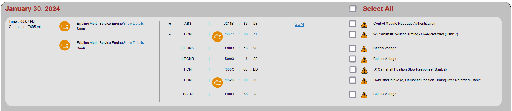

Dealer did not give me the codes but Rocket was able to pull this for me, good guy.

I've seen the P0022 many times, that is a cam timing code, along with a P0018. The P052D am not familiar with.
