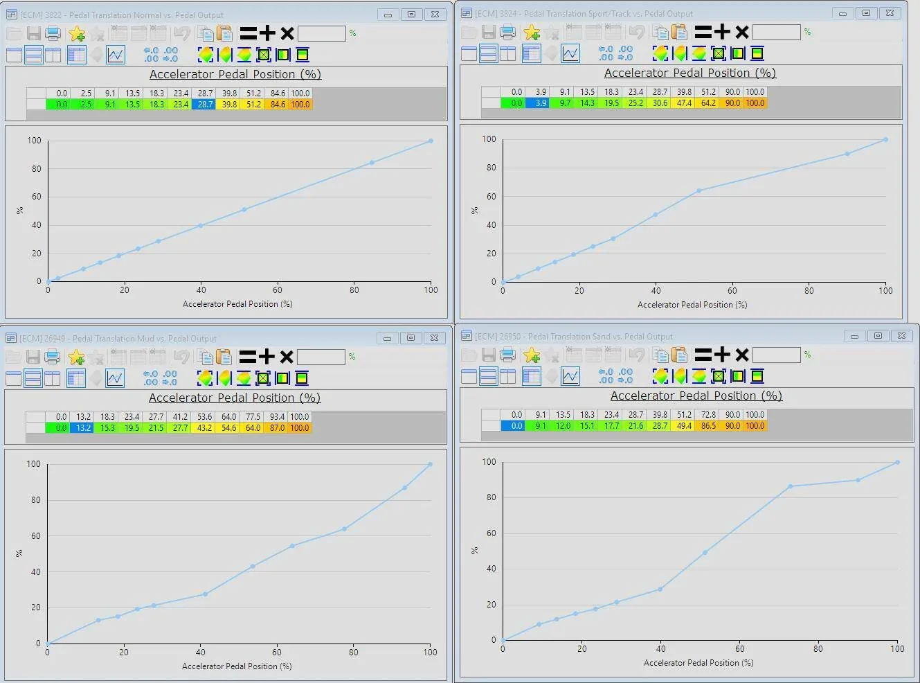

Somebody posted a chart with the throttle input and result (throttle opening) in the various modes here on the web site.
I'll see if I can find it.
When you look at the chart, it is easy to see why track mode allows you to use the gas pedal to control the rear end much easier than Sport Mode.
You can experiment and try it for yourself, though, if you can find a spot to take a turn at the limit and apply throttle until the rear begins to move and lightly back off the throttle just enough to keep pushing through the turn. Do it in Sport Mode and Track Mode. You'll find Sport Mode often means removing your foot all the way whereas Track Mode allows you to make a small adjustment and keep the engine pushing through the turn until it is time to go full throttle again.
Junkyard Dog
Jun 3, 2025
54
2,577
2,080
S650 Mustang Is it me or is this car tail happy when making fast turns 1771446551946-9f
@ZXMustang posted it.
"I suppose I can add some actual facts here. The "track mode" pedal is far from linear. The only pedal demand pedal mode that's truly linear is the normal driving mode pedal. The rest are weighted differently and very non-linear. Top left is "normal", top right is "sport/track" but only track for base cars with no actual track mode. Bottom left is mud mode which is real track mode on the mustangs and bottom right is sand mode which is drag mode on the mustangs. This is from the 24 Mustang GT tunefile I have in HP Tuners."​
Source, post # 14:
https://www.mustang7g.com/forums/threads/biggest-frustration…-track-mode.167977/
Junkyard Dog
Jun 3, 2025
54
2,577
2,080
So if you compare the throttle at, say, 40% throttle, the Track Mode is opening the throttle maybe 25%, while Sport Mode is whacking that bad boy open to 50%
It does not take a lot of imagination to figure out which one gives you more control. In Track Mode you have to push that throttle down to about 70% before you get the throttle more than halfway open and across the 60% line. In Sport Mode you whack that throttle up over the 60% line at less than half throttle application with your right foot. This means Sport Mode makes it more difficult to make small adjustments. Track Mode makes it easier.
Plus the transmission does exactly what you want it to do in Track Mode. Not so much in Sport Mode.
But see the caveat in the quote from ZXMustang that base models do not even have a Track Mode. It is just Sport Mode. <--- That sucks.

I don't think that's it... Sport/track the same? mud and sand mode?
You do not think what is it?
Sport and Track are the same in base models. Not in my Dark Horse, I mean, not even close. It is easy to tell the difference in the throttle mapping just by driving in each mode, switching from one to the other.
This is a downloaded file from a 2024 GT.
Mud and sand . . . sounds like something off a truck or 4WD . . . . maybe he confused slippery mode?

Sport and track don't seem the same to me... after reading the description, it makes a little more sense (mud and sand), but track and sport seem very different to me.
