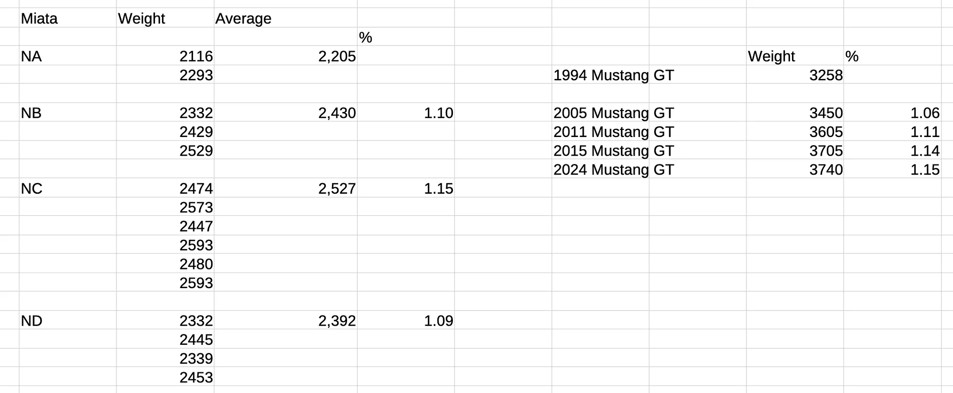

Miata isn’t the best example as they managed to keep its weight pretty stable for the last few decades.
How is that not a good example? If anything, it proves my point. The Miata has stayed the same relative size and weight over the years while everything else has gotten bigger and fatter.
2,816
2,801
Depends on what years you are comparing. The Miata porked up a bit but has lost weight in the last generation.
