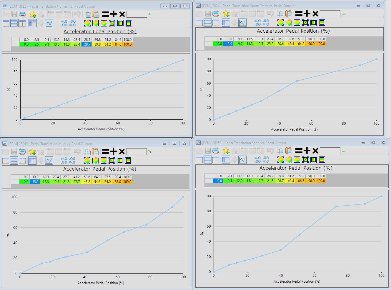

I suppose I can add some actual facts here. The "track mode" pedal is far from linear. The only pedal demand pedal mode that's truly linear is the normal driving mode pedal. The rest are weighted differently and very non-linear. Top left is "normal", top right is "sport/track" but only track for base cars with no actual track mode. Bottom left is mud mode which is real track mode on the mustangs and bottom right is sand mode which is drag mode on the mustangs. This is from the 24 Mustang GT tunefile I have in HP Tuners.
