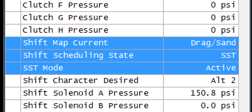

Yes we're sure.
Normal is normal
sport is sport
mud is track
sand is drag
This is a small screen cap from my 25 doing a WOT pull datalog. The car was in drag - in SST which is manual mode (select shift). You can see it references drag/sand. ANd ALT2 is the shift modulation table it is using associated with drag mode.
