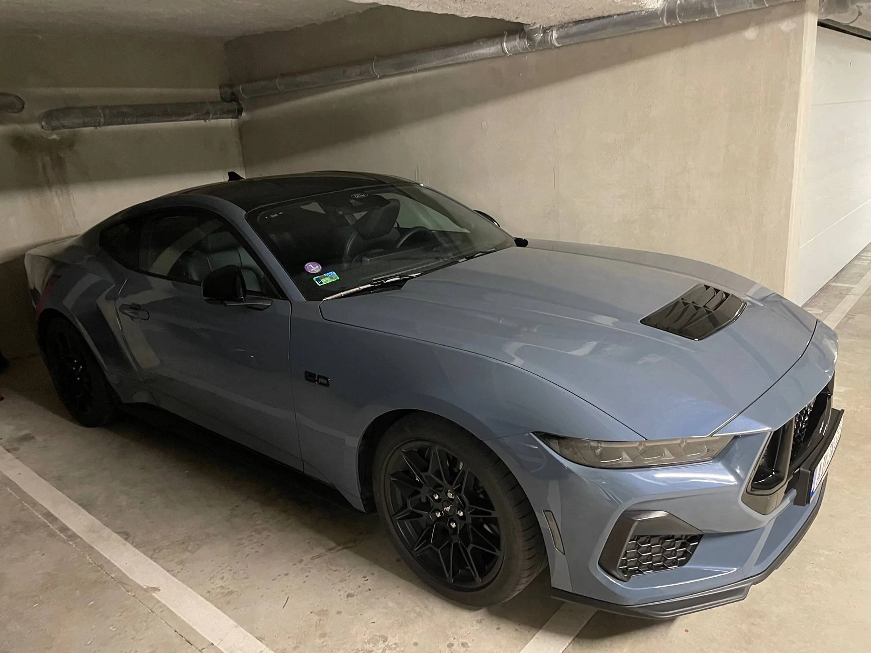

Thanks and here is a pic of my car 😊

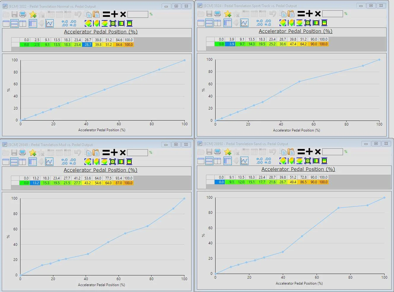

I suppose I can add some actual facts here. The "track mode" pedal is far from linear. The only pedal demand pedal mode that's truly linear is the normal driving mode pedal. The rest are weighted differently and very non-linear. Top left is "normal", top right is "sport/track" but only track for base cars with no actual track mode. Bottom left is mud mode which is real track mode on the mustangs and bottom right is sand mode which is drag mode on the mustangs. This is from the 24 Mustang GT tunefile I have in HP Tuners.
If that's accurate then it would explain a lot. I'm slightly surprised they all cross Zero at zero, usually normal modes will cross a little above and sporty modes will cross lower to increase engine braking. All depends on how Idle Air Control works.

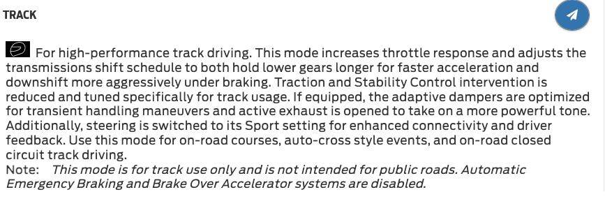

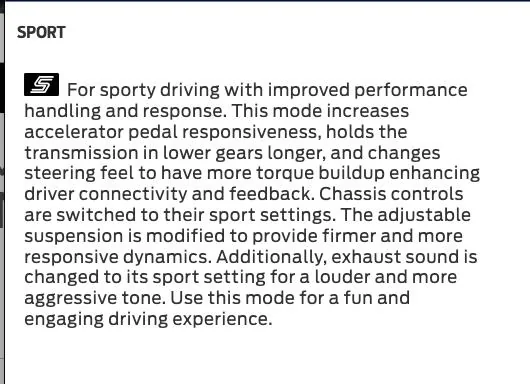

All the talk of track mode being 'linear' would be perfectly fine if that was the description in the manual. I've attached both from the latest online manual for reference.
My main point is if people have been putting their cars in track mode as by the manual its the most aggressive, and then lamenting it's lack of response they should try sports mode instead it's a lot snappier.
Also, pedal commanders mostly work by spiking the driver input briefly to make the ecu think you floored it then lifted and thus reduces the transient damping effect.
Another note, an 'easy tune' for tuners to make on drive by wire cars (cars without modes) is to increase the Butt Horse Power is to tweak the throttle maps to be more aggressive.
If you drove your car into the shop in normal mode and it came out feeling like it was in sport mode you'd think it has more power when it doesn't really it just feels more responsive
