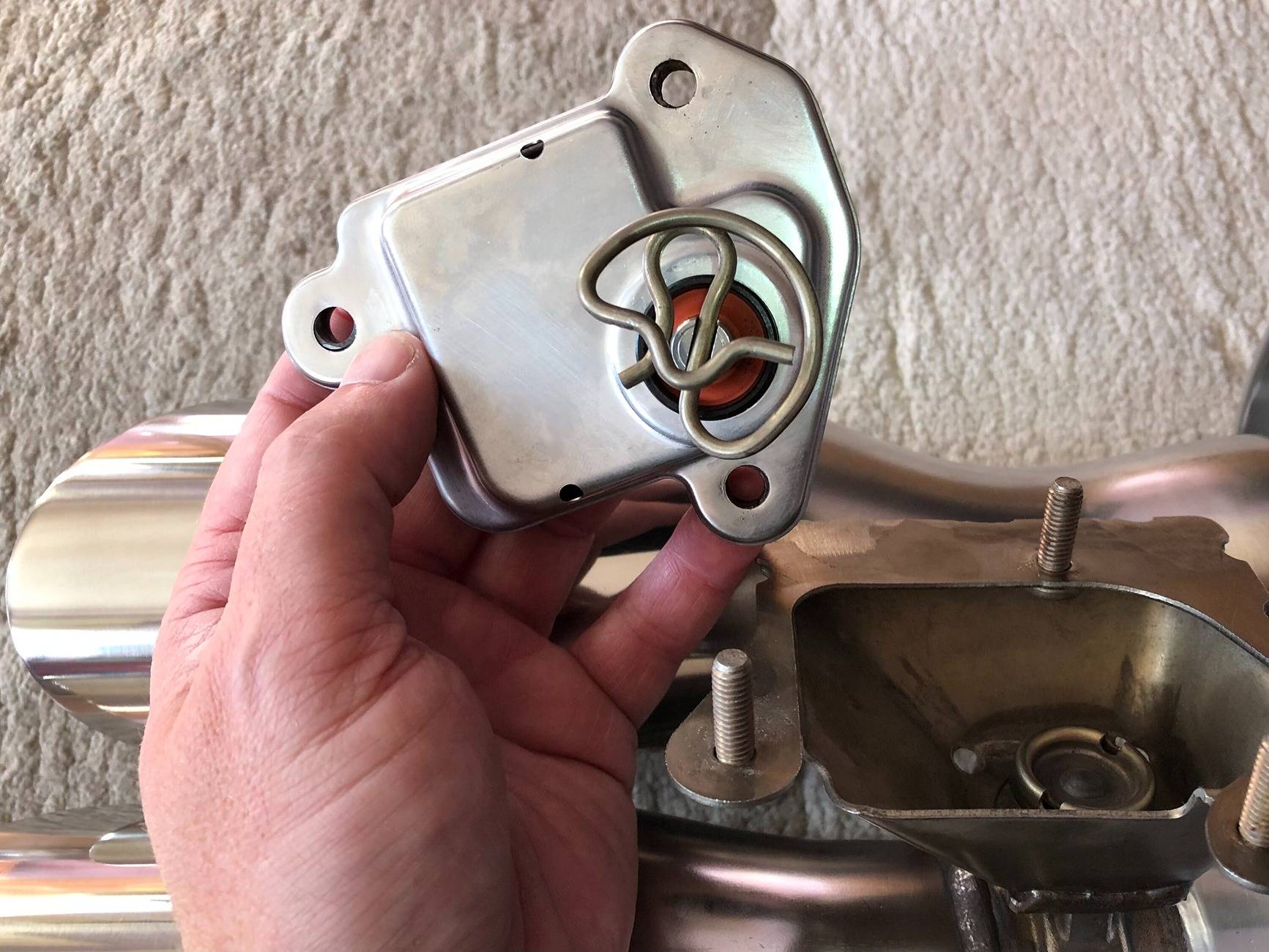

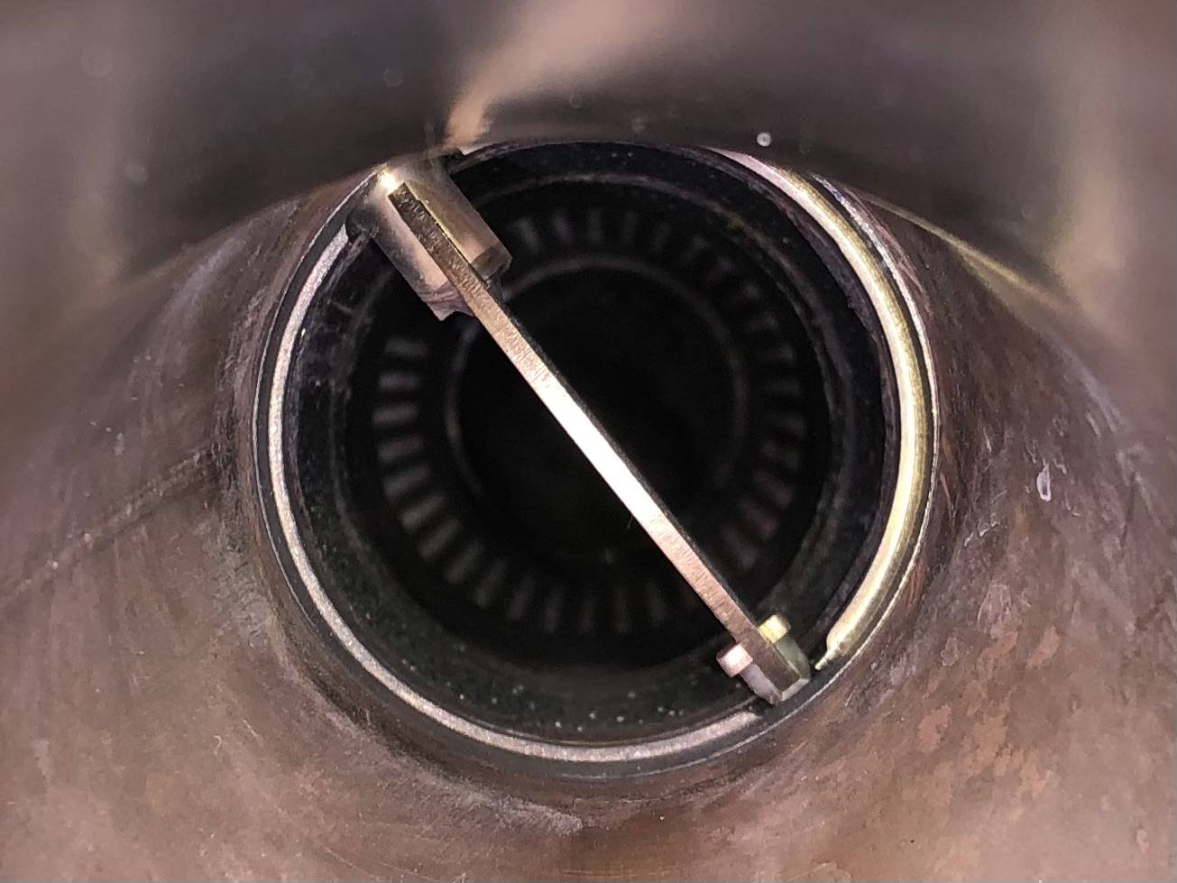

@Skye thanks for the internal pic. I think it basically confirms my understanding is correct. Active exhaust has basically a straight-through pipe (similar to muffler delete) that can be closed off so that exhaust gets shunted to another pathway (muffled path). Therefore, it's like a toggle-able muffler delete. But it's usually not 0% or 100%, the valves close at various angles, thus why I called it a variable muffler delete.

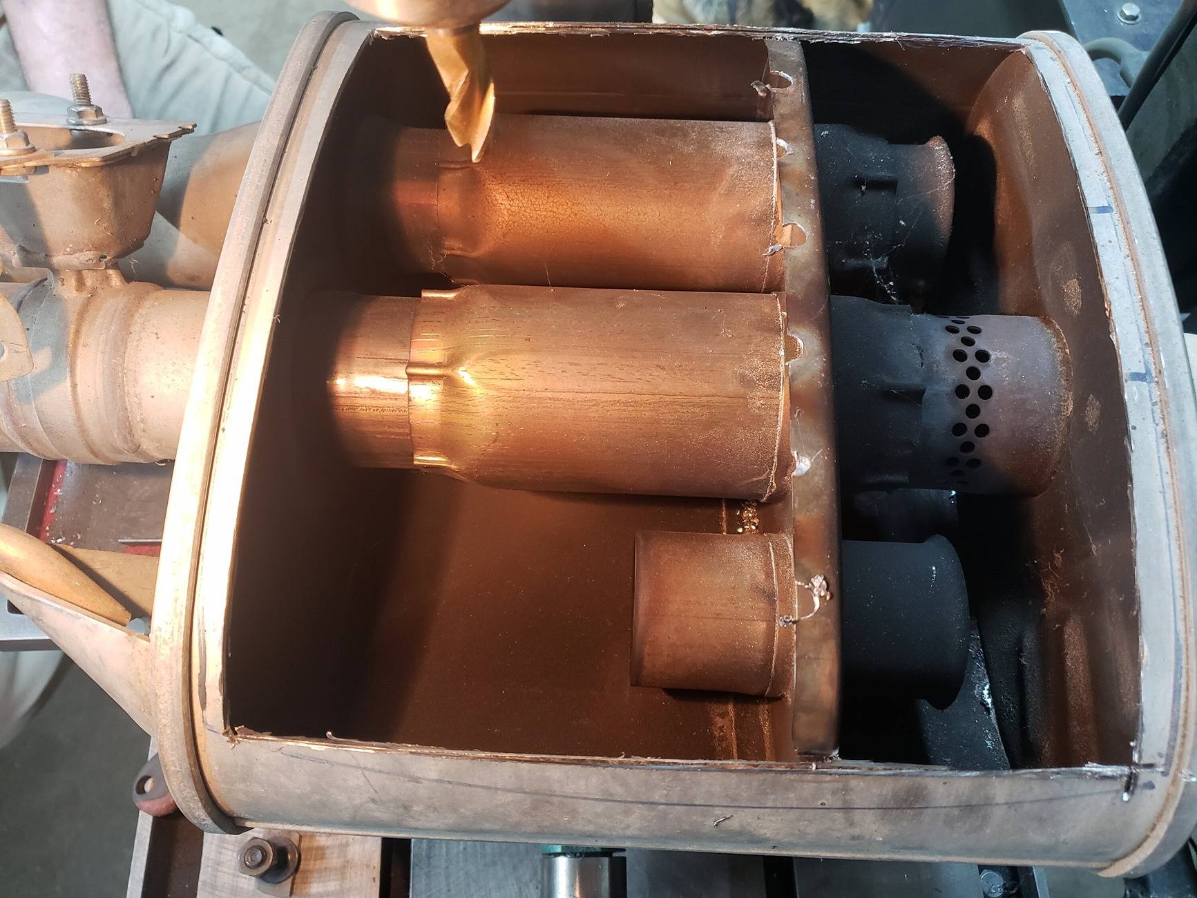

To compliment the thread and posts, an internal look of the central resonator.
Edit,
The photos of the muffler and resonator can help explain their differences.
In the resonator below, it is more or less a straight pipe, but the pipes have holes. Some of the wave energy enters the chambers. Inside, those sine waves, collide. The result is some muffling, but also tuning.
Not all the sine waves are in phase with one another, can partially or completely cancel one another. For example, +1 - 1 = 0; two waves completely out of phase of a particular frequency cancel (the size of the holes influence what frequencies enter the chamber). A resonator's primary purpose is not necessarily a reduction in noise, although it can, but a reduction or elimination of unwanted sounds in frequency bands or specific frequencies.
Which also helps explain how noise-cancelling headphones work: upon receipt of the exterior sound, the electronics phase change the incoming sine waves 180-degrees. +1-1=0. The energy is cancelled, resulting in quiet output to the ears.
To the earlier photo of the muffler, picture the exhaust pulses (all of them), the sound waves, as they enter the device, travel through the pipes, chamber and exit. It takes energy to do that, and the waves are no longer traveling along a common path, with many now out of phase; they are "muffled", the energy reduced, virtually all frequencies. The same as covering or partially covering your mouth.
In summary, while resonators are principally tuning devices, removing specific sounds or frequency bands, mufflers are used for sound reduction throughout the entire audio spectrum.
Thanks for posting this. There is a misnomer that the factory resonator is restrictive. As you can see. It's very free flowing.
