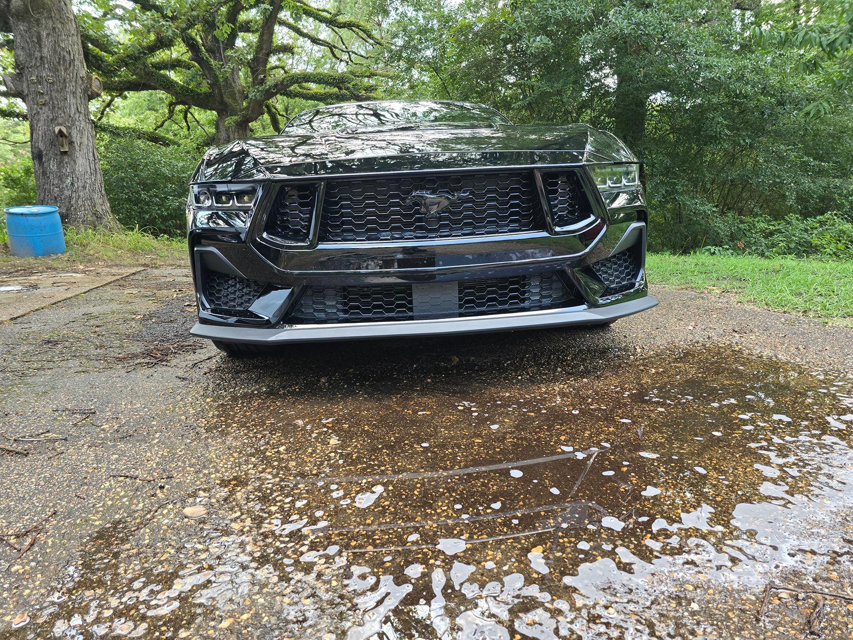

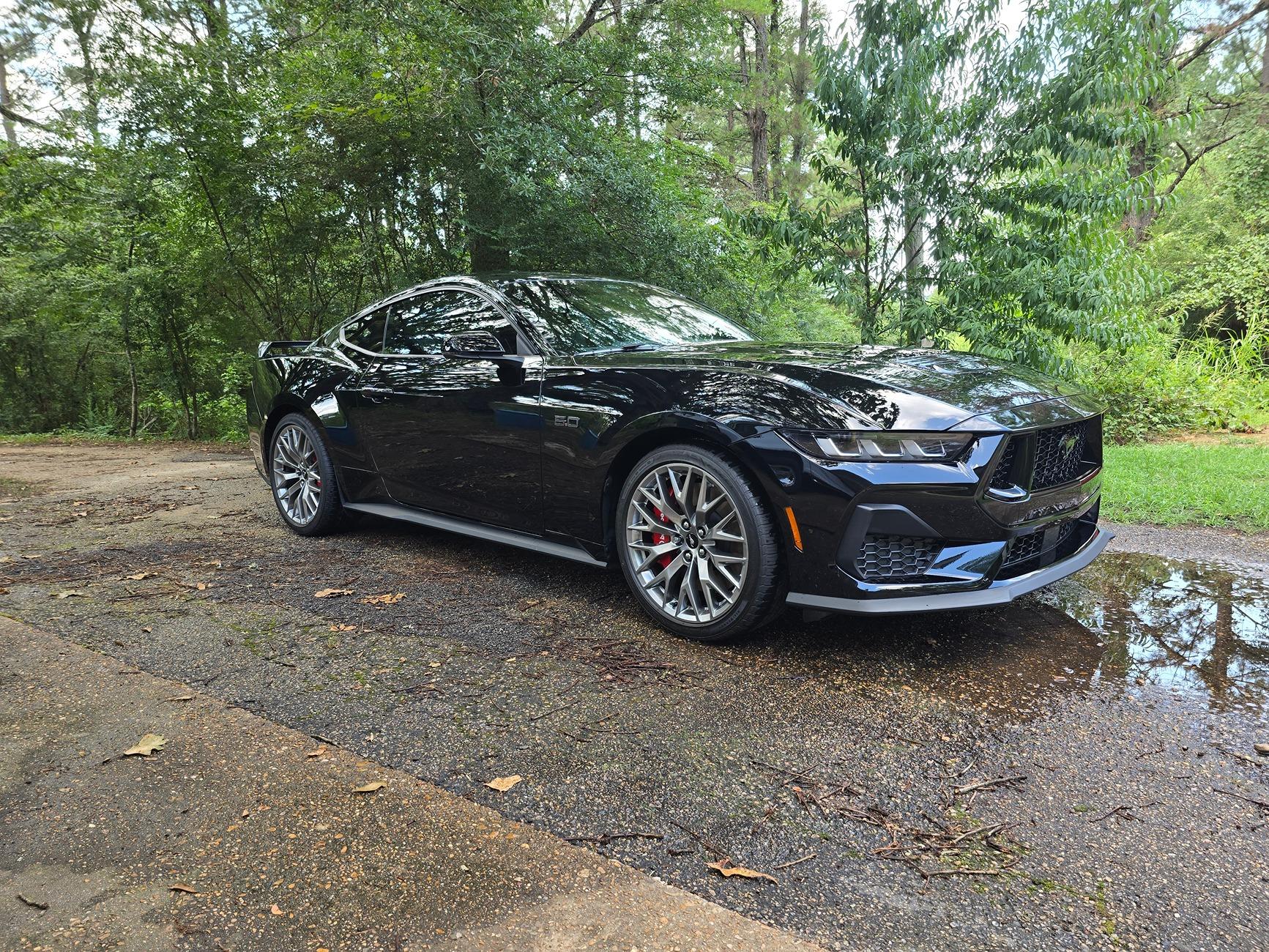

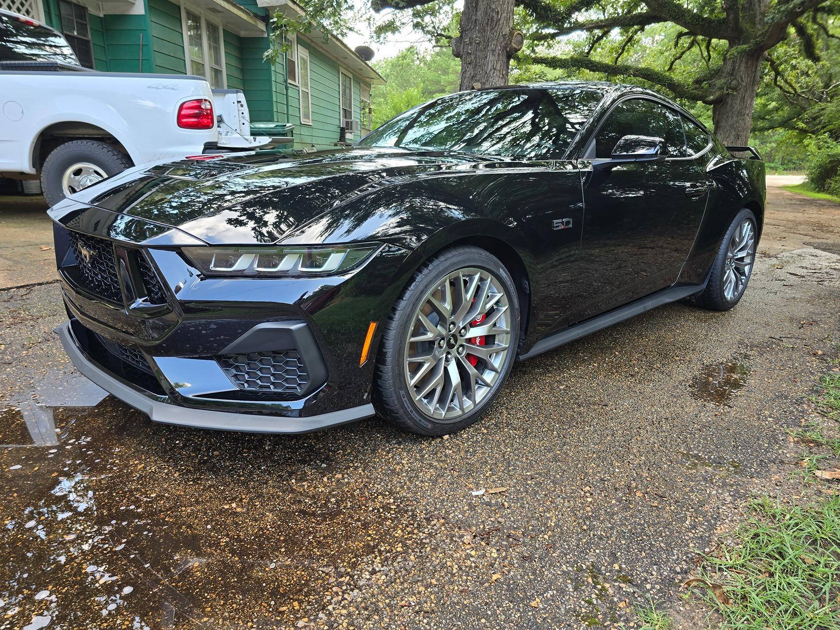

I have it and love it. Some of the aftermarket stuff I looked at was just too big for my taste but I did want more than that little bump that was there from the factory. It installs with double-sided tape and adhesive, quite easy to do as long as you measure twice stick once. I've had it on for a month with multiple trips through car washes with no issues.

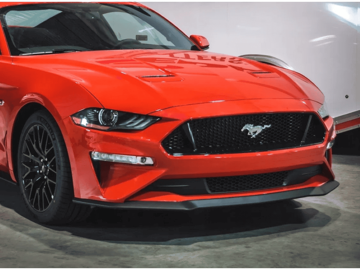

It looks 99 percent like this in size and shape. Yes, I know this is a '23. No pics of my own.

I attached it with the double-sided tape and then from underneath laid a bead in the v shape formed by the new and the old spoiler. Been through car wash dozen times or more with no issues.
