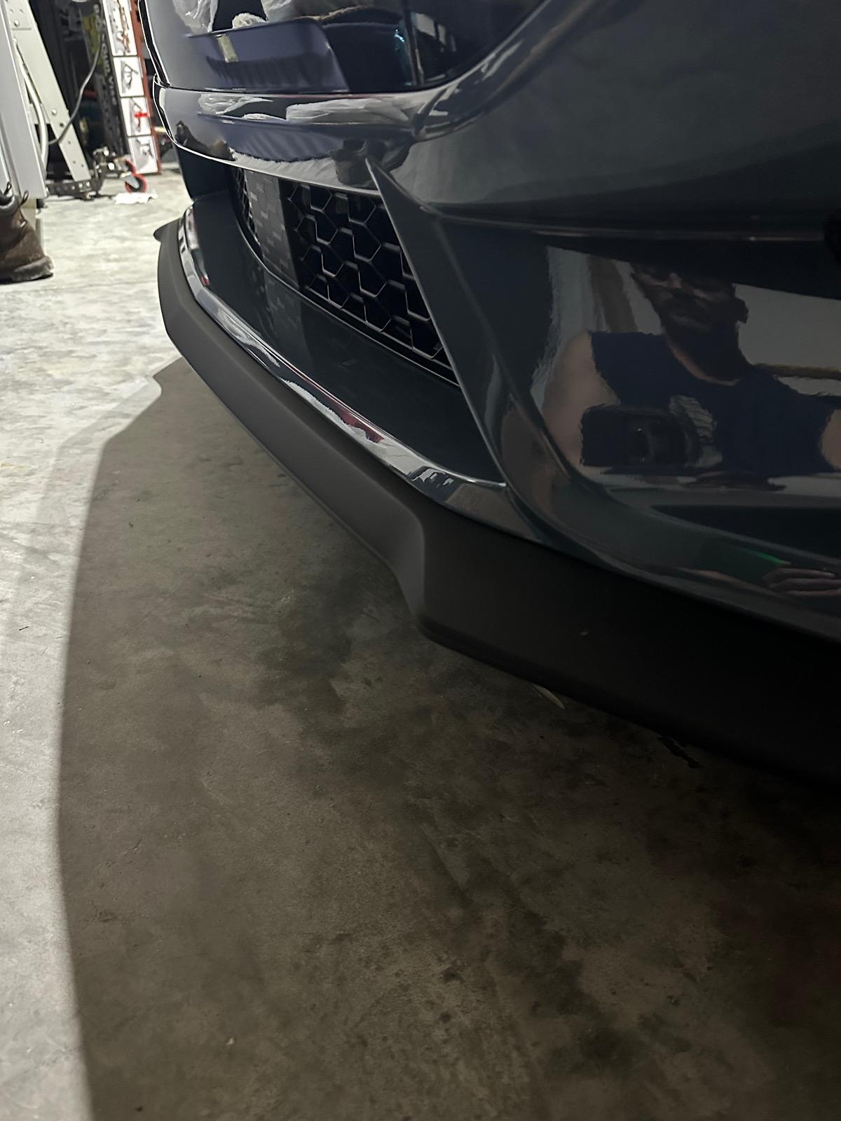

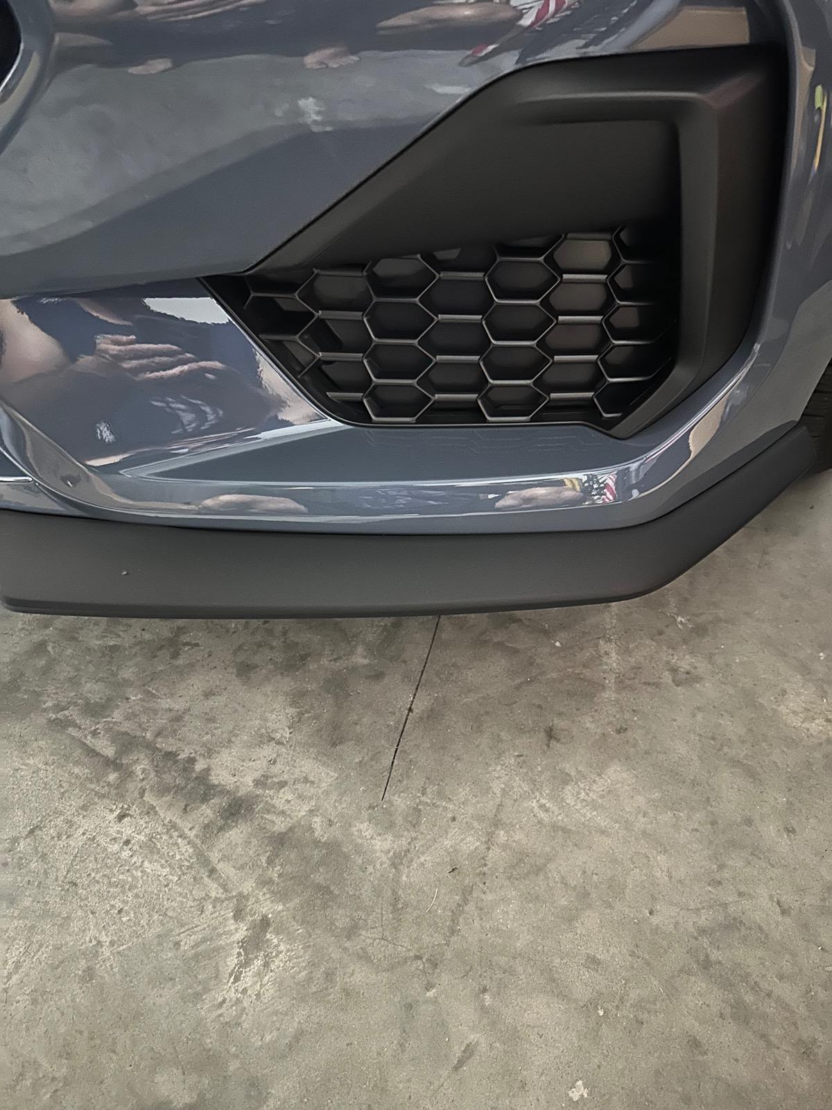

We have one installed. Left it in original color and ceramic coated it. The RTR splitter doesn’t look that good on the Mustang. The corners stick out way too far.
Do you have any pictures you can share?

Very well. Looks the same as the day it was installed

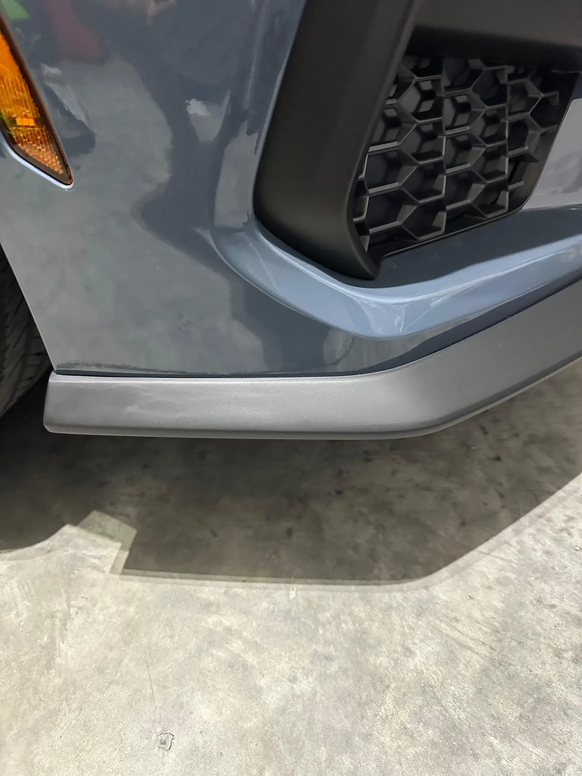

I've had the AD splitter (purchased through Ford Performance and professionally installed at a body shop) on my GT for a couple three months now. NP so far!
@viking805fan --it attaches over the OEM lip/splitter with adhesive tape (already in place on the splitter) and there is an included tube of adhesive (caulk gun needed to apply) to "fill in the gaps" (whatever that means---guessing the adhesive tape to OEM lip contact isn't 100%). If I remember rightly; the instructions recommended a 24 hour adhesive curing period BEFORE driving. The shop I used also removed my OEM wedge spoiler and attached a DAR rear wing and replaced my OEM badging at the same time as the splitter----so the adhesive had plenty of curing time in my case.
If you intend on DIY; as wide and as flexible as the splitter is; I'd think it would be VERY difficult to get a proper fit on the car without at least two people pressing it into place. Test fits required of course; with adhesive tape backing NOT REMOVED prior to installation!
