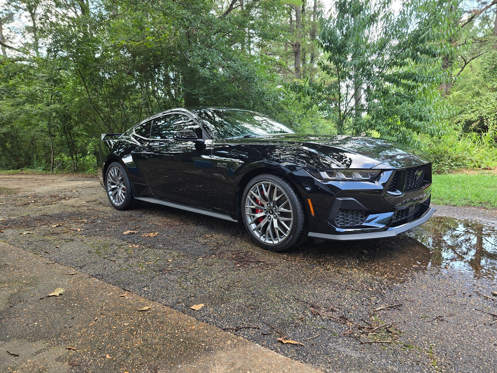

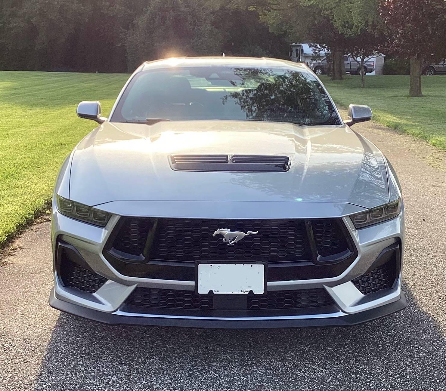

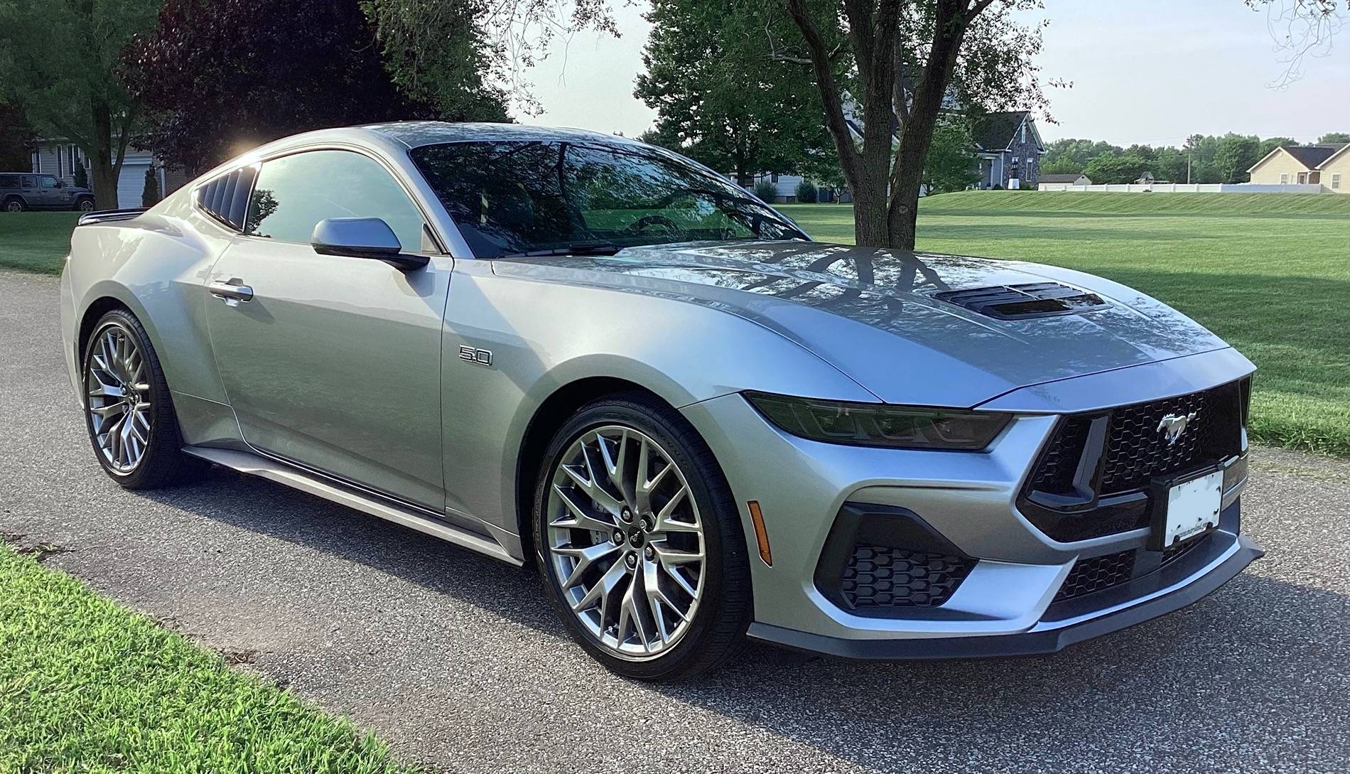

I installed the spoiler. Only holding on with 3M tape and silicone. So far, holding. I chose it because I wanted more than stock, but not too much so I needed to worry about curbs. Yeah it does have flex but holds. I did add a small bead of included silicone to the very ends at each wheel well to prevent side flexing. Overall happy with my choice.

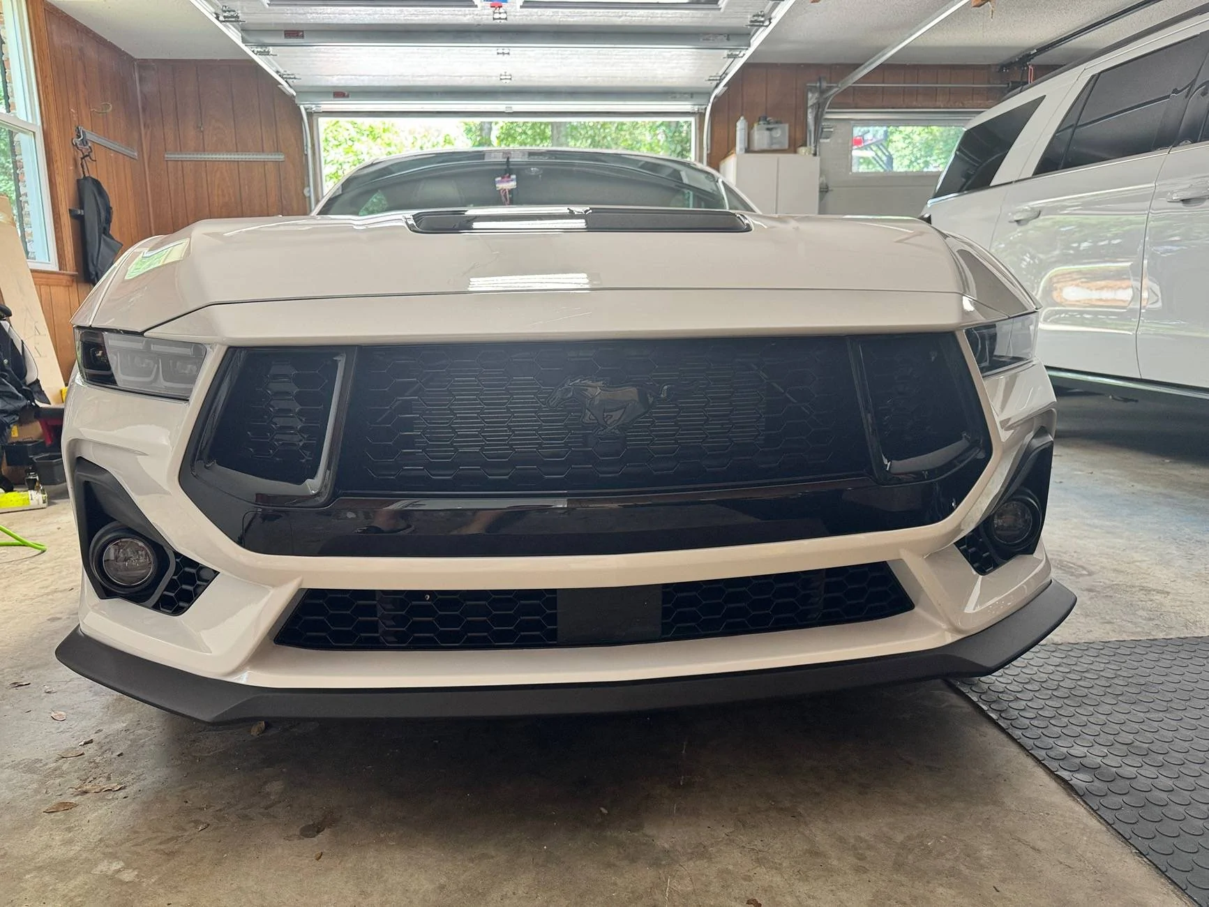

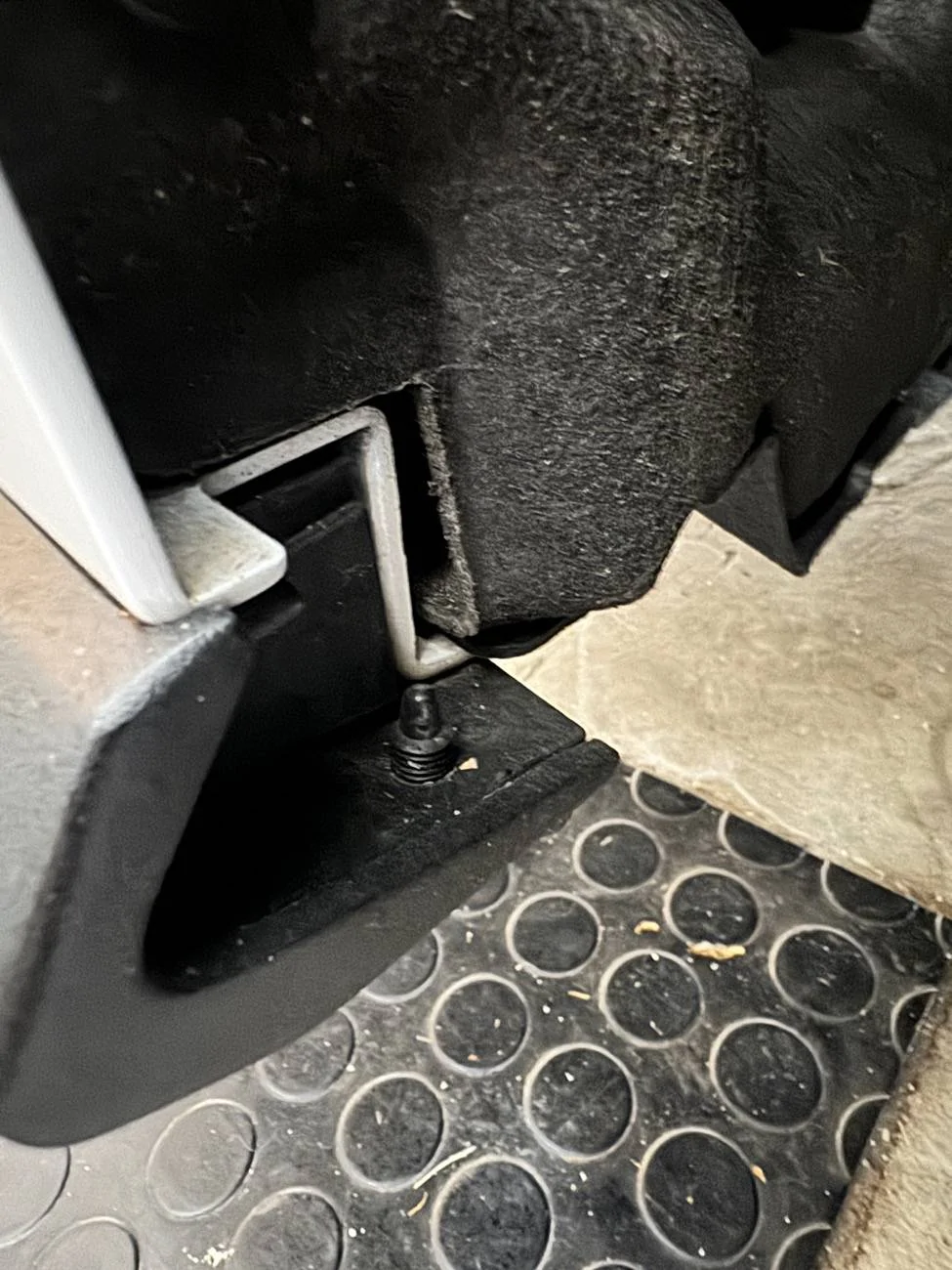

I have had it since April. I used just double sided tape and then secured it by the fender liner on each side with a Christmas tree push pin
