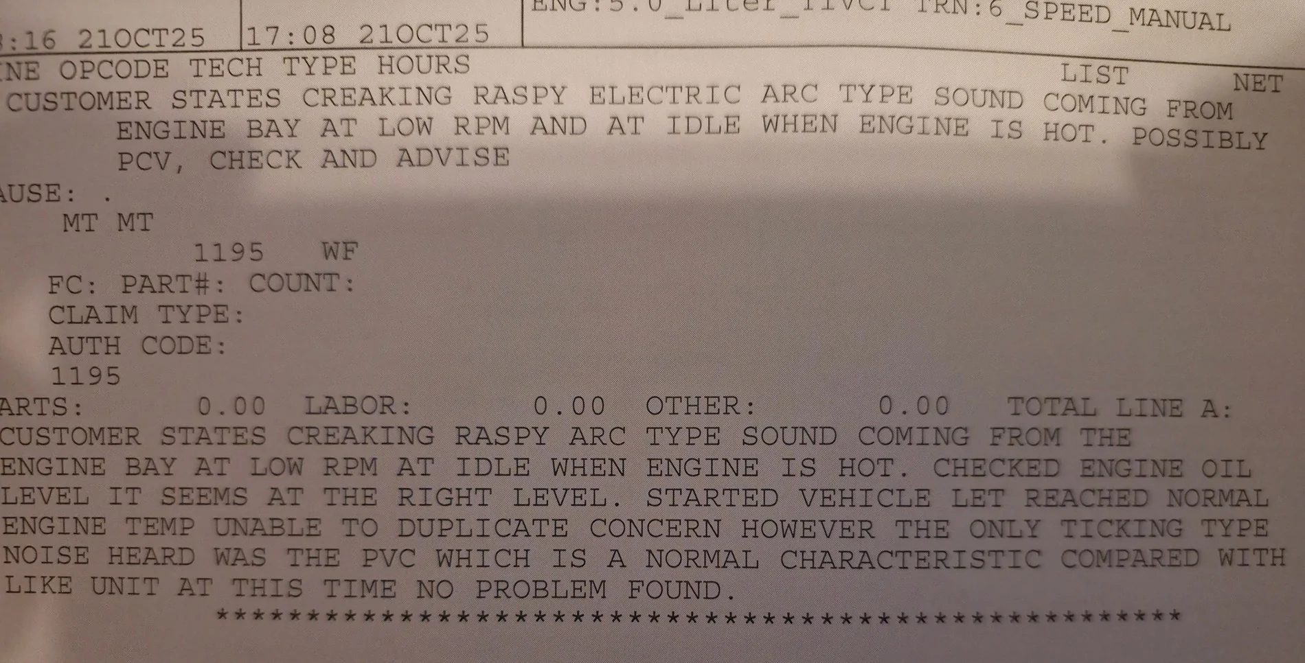

Hello I realize this post is a bit old, but I thought i would let you know I bought my darkhorse in for an oil change and told them to check the noise, I have the same exact sound as yours buzzing arcing sound, I just thought you'd want to know they told me it's normal PCV sounds on this engine and it's normal. Just to further your peace of mind. Cheers bro.

I've also had mine checked at dealership, here is the write up. I described the sound different but same thing.
S650 Mustang Do all GT's have this sound? e690446b-f4a8-4d35-a651-fe0032f9e870-1_all_709
