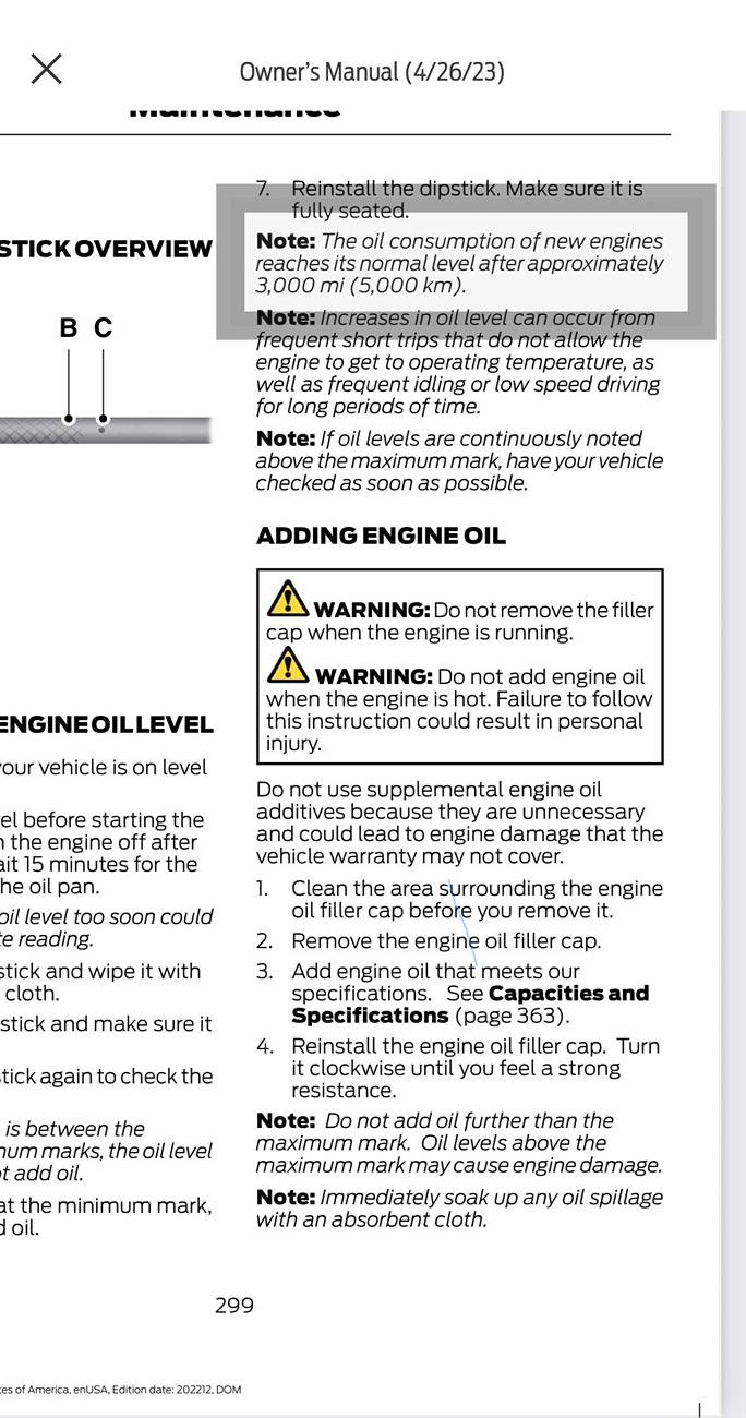

I have 155 miles on my 25 DH and decided to pull the dipstick. The level was barely and I mean barely touching the lower dot. I put a 1/2 qt of oil in it and it now registered right in the center of the cross hatch area.
I had heard Ford is shipping these things ‘low’ on oil and it appears how you look at it the levels are 1/2-1 qt low from the factory.
Same here, on the bottom dot. Found this is a different thread
S650 Mustang Check the oil level on your new Mustangs ASAP 1747598967925-5s

Oil take time to drip out of pistons into pan.
Cold is most accurate

When I first took delivery of mine it was about a quart low too stone cold. Not quite on the low dot but just above. Threw a quart in and it maybe used half of it as it broke in and stopped at around 3000 miles like the manual said. Pulled about 9.5 quarts out of it on oil change. Put 10 litres (10.5 quarts) and a bottle of Certaec in and it now sits PERFECTLY on the full line stone cold, though it's worth noting the NAPA Gold 7502 filter I am using is slightly larger than the Ford FL500S filter and about double the length than the stubby filter that came on the block from the factory (I heard something about some Coyotes being shipped with the smaller EcoBoost filter?)
Needless to say for some reason Ford has changed the oil capacity in the manual/service books to be lower to sit on the lower end of the dipstick despite being capable of holding more. Though that won't stop dealers from doing horrible PDI jobs too... Pretty sure my dealer just took all the stickers off the exterior of the car and shined it up. All the clear stickers on the passengers side interior, under hood, back seat etc were still there and both my coolant and oil levels were almost at the minimum mark.
