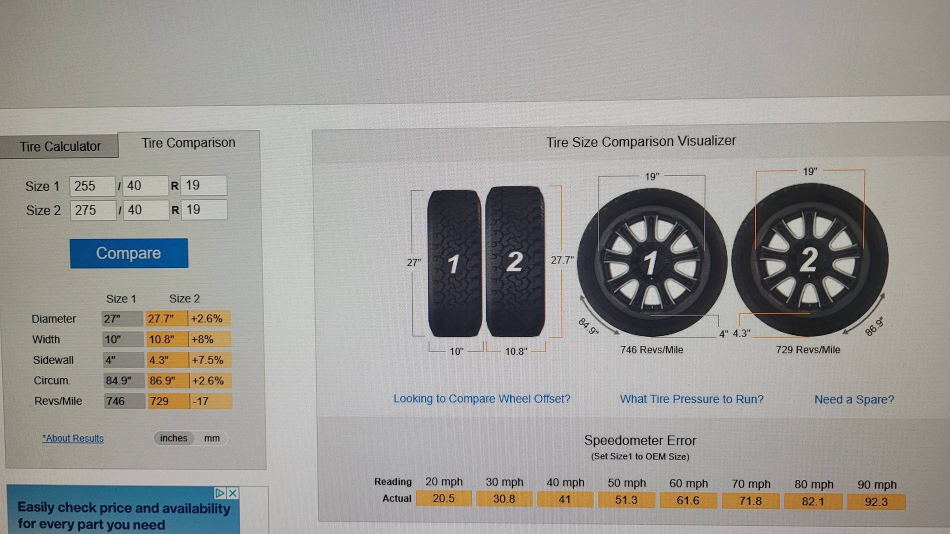

According to the math, we should be goimg faster than what the speedo says.
S650 Mustang Changing tire size using FORScan 20250417_081143

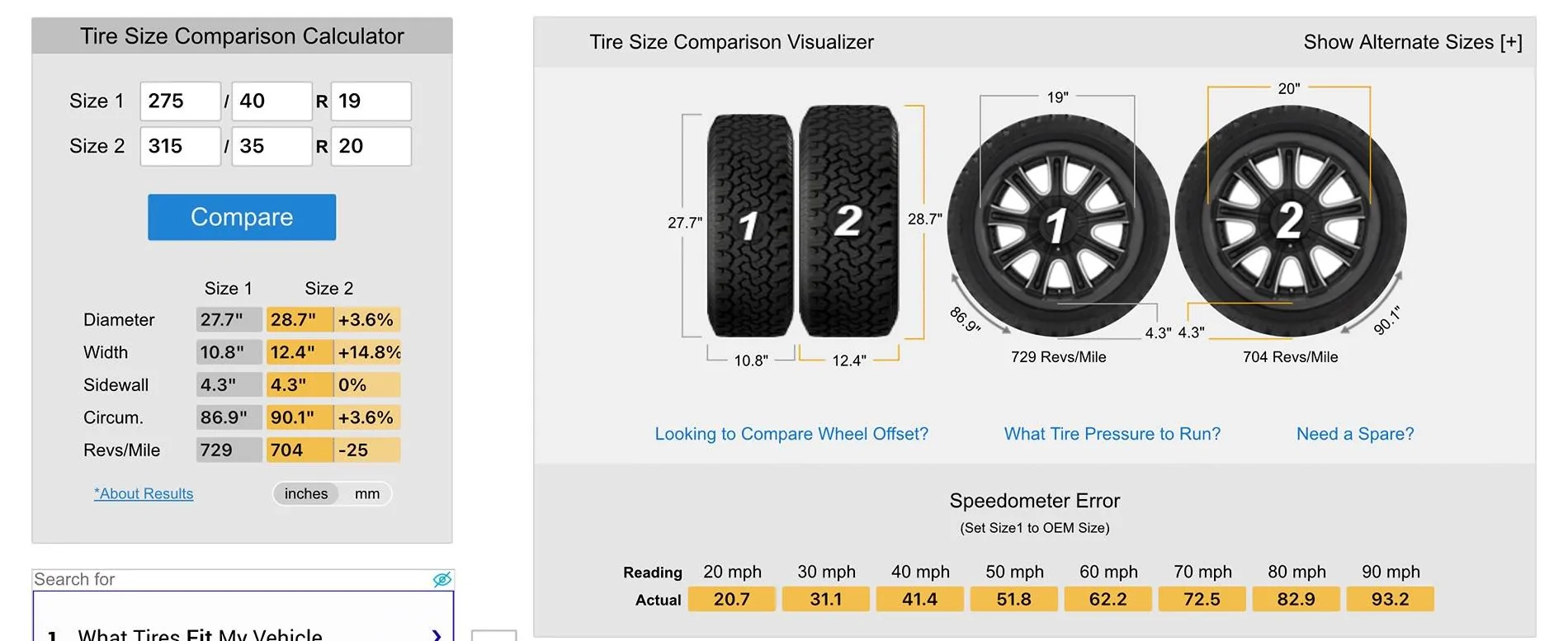

Agree. Maybe I’ll break out my draggy. It is the most accurate speed detector I have.
S650 Mustang Changing tire size using FORScan IMG_0038
