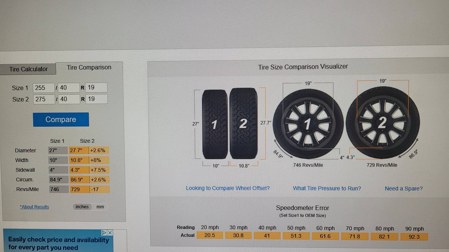

Thanks. Not sure it's worth messing around with then. I want my speedo accurate, but in my experience resetting the PCM and TCU always seems to lead to a bug or glitch. Everything is working perfectly on my car now (knock on wood). We'll see how far off it reads. Tire size calculator says the 275s are a good amount taller and the speedo will read 1.5-2 mph slower than actual at 70 mph.

Yes. That's how I check it. But the math doesn't lie.
