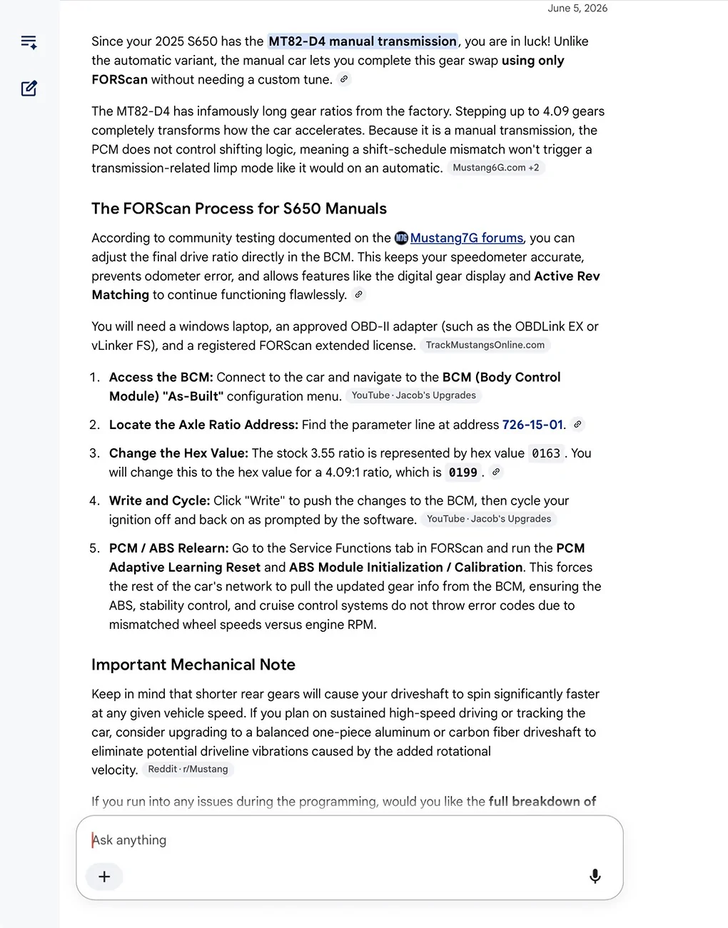

This might be the wrong forum to ask but I'm also looking to regear from 3.55 to 4.09. I've got a shop capable of it and my research indicates since I have a manual only Forscan is needed to updated the vehicle. Sound about right? Below is a screenshot from a Gemini search and my Iconic Silver Gt Nite Pony.

Same size front and rear are not required... DH and GT PP cars have 27" front and rear is 27.7.
Edit: biggest thing is to have the correct rear tire size in the computer.

You'd have to use forscan to change it. The three closest dealers to me insisted it couldn't be done and talked to me like I'm crazy unless my dealers just suck.

I used a Ford Procal 4 for adapting the car to a new tire size and a change from 3:15 gears to 3:55. It worked for flawlessly and took all of 5 minutes to do.

I read conflicting info that staggered from the factory is programmed that way but going from square to staggered, if not the same diameter, could be a problem. Conversely, if within 3% (front to rear) there wouldn't be an issue. The latter makes more sense especially given all the aftermarket offerings.

Whatever tire is installed on the REAR from the factory, is the tire size programmed into the computer...(GT 27", PP or DH 27.7", DH HP 26.5") the fronts have nothing to do with it.. square/staggered also has nothing to do with it. If you replace the REAR tire with something less than a 3% increase/decrease you could probably get away without changing tire size in the computer.
My car came with 27" tires front and rear. I put a 27.3 in front and 28.1 in the rear... the only issue was speedo was off by a couple mph. Like @MNPony, I used a procal4 device to set the tire size correctly... everything perfect.
