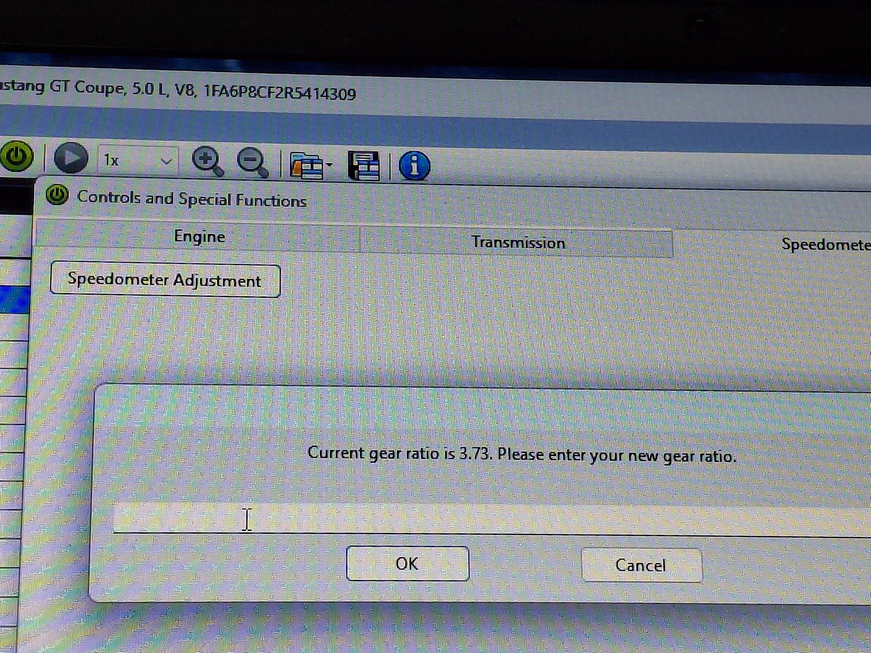

I don't see how the speedo was correct unless they went with a taller tire,
The HP Tuner MPVi2 will change the gear and tire ratio's.
Using VCM Scanner and select the Green Special Functions button [ looks like a Power Button ] and select Speedometer.
Change the gear and tire revolutions and save.
It worked, I changed from 3.15'w to 3.73's and the speedometer was 7mph off on a test drive.
