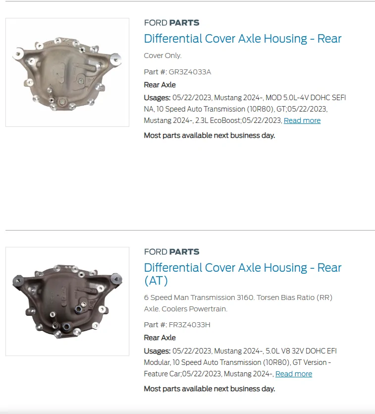

So from what I see right now we have three options.
One is 3.15
One is 3.55 with no PP package
One is 3.55 with PP
So the question is, whtat is the difference between the 3.55 with and w/o PP package? Are they the same?
And, anyone has photos of the two? I would like to know how to identify them physically under the car.

Non PP is a limited slip diff. PP is a Torsen diff. I mentioned this to you in another thread. Visually im not sure of the distinction underneath. But it's easy enough to tell the difference between a PP car and a non-PP car based on the wheels spoiler, and front lower grille inlet. Not to mention it's all on the vin and window sticker. 👍🏻
2,715
4,121
the 3.55 diff without the performance package is a clutch pack type limited slip diff, where too much slip will cause the clutches to lock up and move the whole diff.
the 3.55 diff with the performance package is a Torsen helical gear type limited slip diff, where if one wheel is slipping, the amount of torque going to the slipping wheel is multiplied (usually) by anywhere from 3 to 4 (depending on the gears inside the diff) and sent to the wheel that actually has traction.
as for telling them apart visually, i don't believe there are any real indicators based purely on the outer casing itself. the only way to truly know what is what is to take off or otherwise peek inside the differential cover. the clutch pack type will have visible spider gears, where the helical gear type will have a metal cylinder that contains the gears
