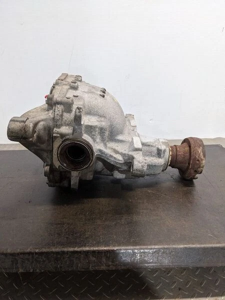

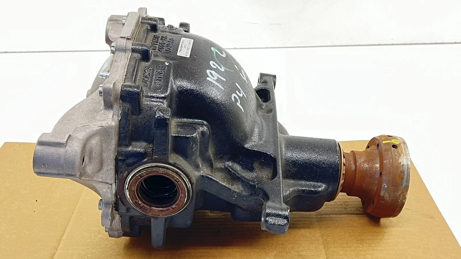

And, anyone has photos of the two? I would like to know how to identify them physically under the car.
The PP 3.55 carrier is cast iron and according to the picture of one on feebay, still painted black,
The optional 3.55 gear carrier for the A10 is aluminum.
The PP carrier with 3.73's is also Iron and painted black.
3.55 PP TORSEN
Optional 3.55 Aluminum

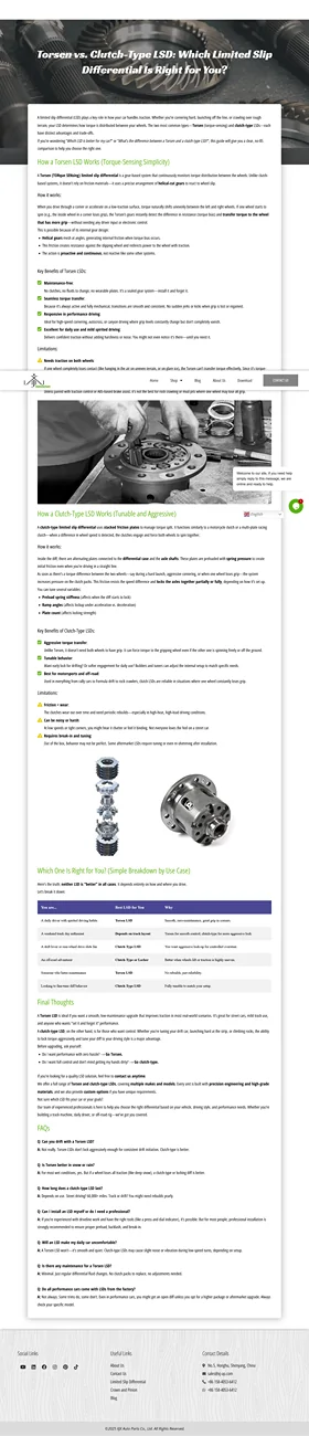

As for the differences in how they function and the benefits or drawbacks of each, this seems to explain it pretty well.
https://www.differential-lsd.com/to...h-limited-slip-differential-is-right-for-you/

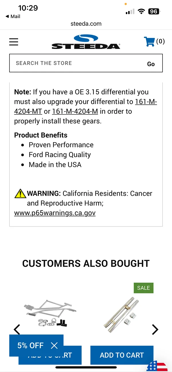

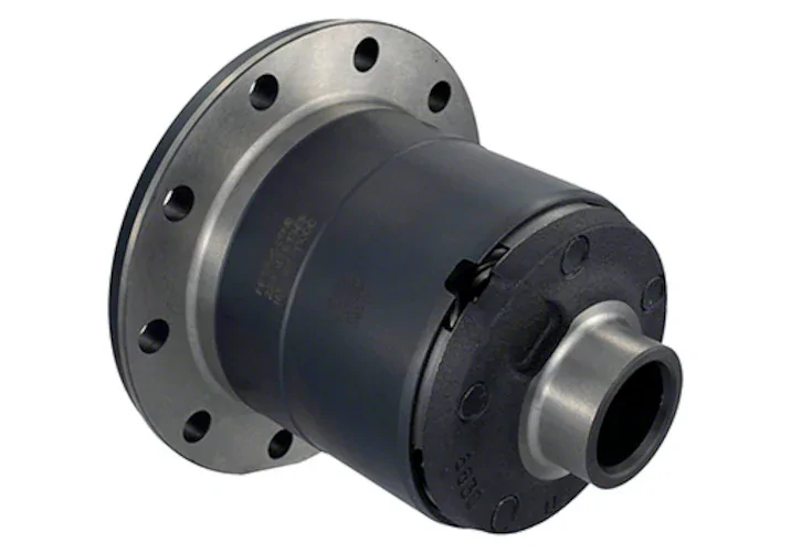

You also need a new carrier (in description of item you posted)... either a clutch type or torsen type as preferred.
Imagine that, right there before my eyes. Thanks again!!!
