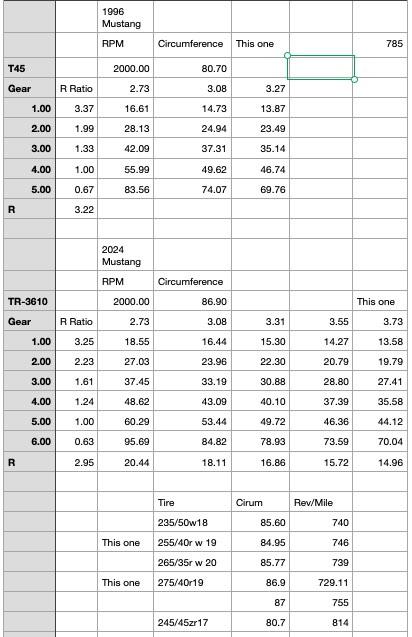

I had this question a while back so I did a little crunching with a spread sheet. My current car is a 96 mustang so I wanted to compare the difference between the two. I found that the difference between the rear end matched the difference in tires. Unfortunately I really wanted a lower ration for the fuel economy but it isn't available. I have a manual DH on order so that's what the table is examining. By the way, the table gives the speed at 2,000 RPM.

Just wanted to add, going with a set of 4.09 gears alleviates almost all the issues as far as gearing when it comes to the MT82D4. I have a set of 4.09s on my 2020 Mustang GT 6spd and it was a mod I wish I did when I first got the car and didn't wait 2 years to do it. The only gear which is still too tall after the 4.09 install is 4th. However, 1-3 is a huge improvement.
