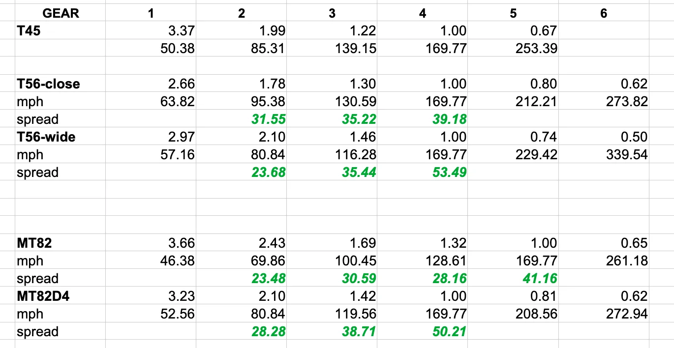

There are charts out there that give the effective gear ratio's factoring in transmission gears, differential and tire size that explain the math
The 10 speed has a super low 1st gear so it does not need a 3.55 gear, where the sticks do not have that low first gear so it does,
If you take the trans ratio times the rear gear ratio it will give you effective gear ratio, but remember tall tires require lower gears but we will ignore the tires for the moment

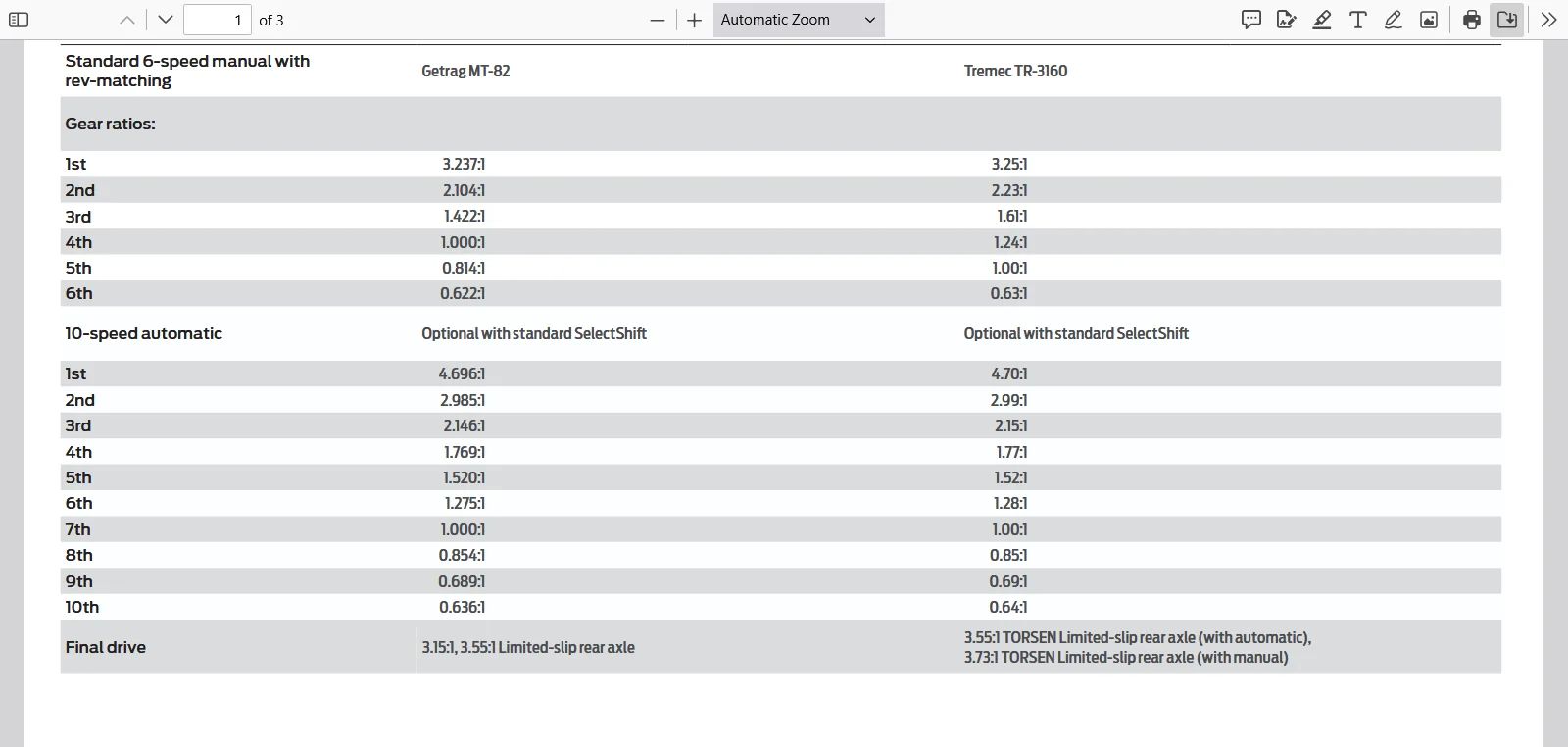

I thought its gear ratios short, especially compared to my 2000 Corvette. That had a Tremec with much taller gears, but the GT has a 7000 or so redline. That makes sense for the Getrag first gear at 3.237 vs the 2000 C5‘s 2.66. Plus the GT rear end starts at 3.55.

I have a 25 GT with performance pack which has the higher final drive ratio. Compared to the 17 GT I had prior which also had the performance pack the gearing is much taller. It’s sluggish at low RPM. Once you get the revs up it’s quite lively from that point forward. 5th and 6th gears are both overdrives which is a bit odd but has enough torque to make them feel normal. They put taller gears most likely for two reasons gas mileage and keeping the cost down by equipping the same 255, 265, or 275 width rear tires which would be inadequate for a near 500 HP machine with aggressive gearing. As it is, it hooks quite well on warm dry days.
As for the transmission feel itself, the actions is the same as my 2017. There are long rods that connect the shifter to the transmission and you can feel them flex and snap into gear. It also does not like to be rushed and they reduced the engine cutoff to about 7,250 RPM because it is not designed to shift beyond that rev range. (The gauge still shows a redline of 7,500 but will not let you rev that high) The Tremec from the Darkhorse would not have any of those issues. Coincidentally I had the same model Tremec in a 2024 Camaro RS. I can attest it is a great transmission and can shift about as fast as you can move your arm.
